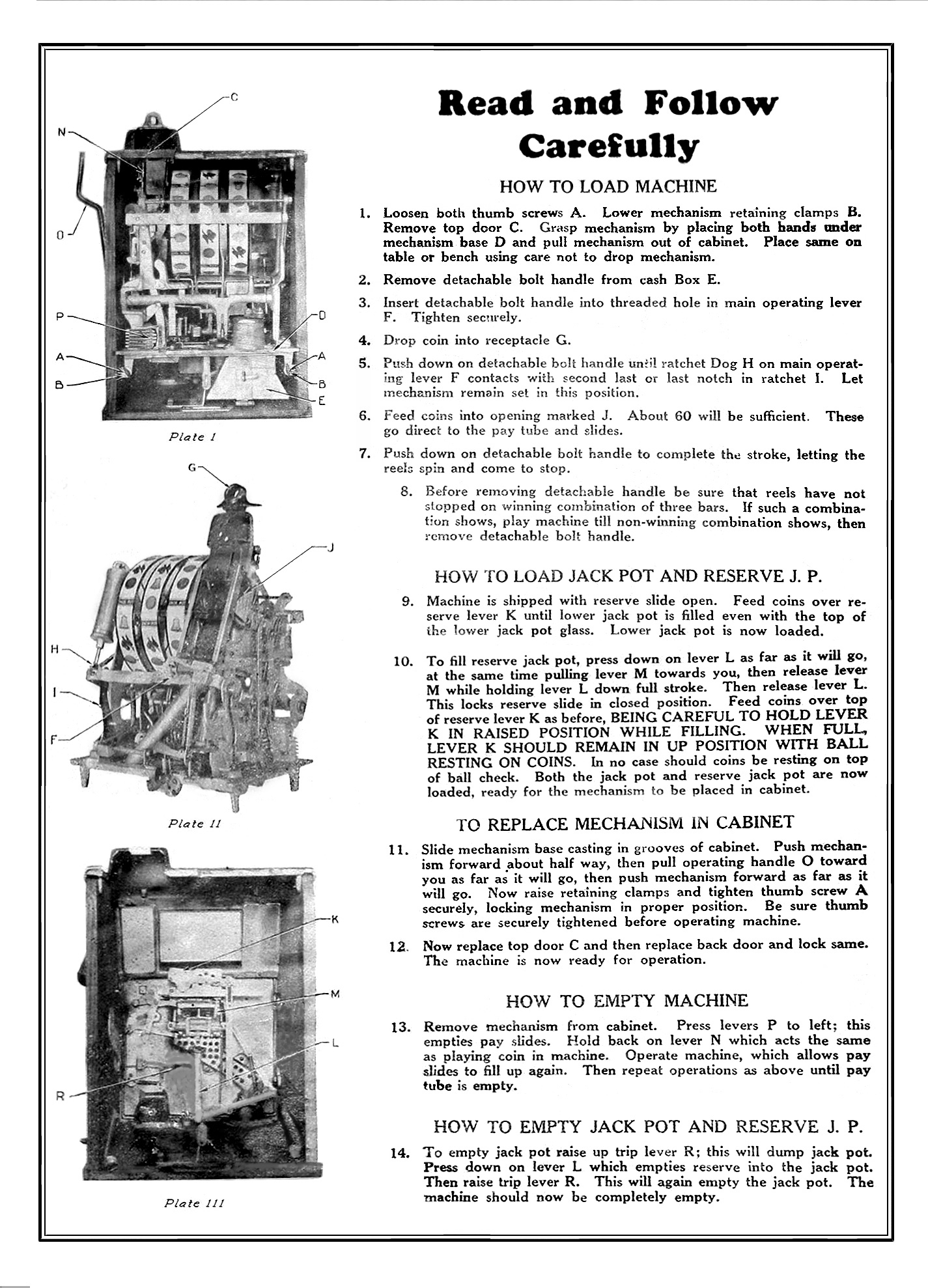

Where can i get the Caille Doughboy back door instruction sheet?
Thanks
Rich
Posts: 576
Re: CAILLE DOUGHBOY
Postby marsonion » Sat Dec 30, 2017 1:03 pm
radiorich123 wrote:Where can i get the Caille Doughboy back door instruction sheet?
Thanks
Rich
I have a digital file of a scanned, reconstructed and retouched 1935 Doughboy backdoor paper; confirm your Yahoo email address via PM and I'll send it to you to print out by your own devices. The paper format is odd: I measure it to be about 9 1/4" x 13".

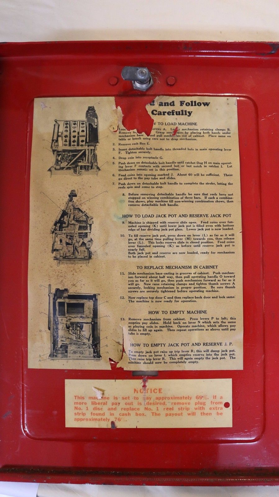

here is another one.
Re: CAILLE DOUGHBOY
Postby marsonion » Sat Dec 30, 2017 3:43 pm
oldslotman wrote:here is another one.
That's my file-- where did you get it? Had I posted it on another thread? I just sent that file to RR, along with a lower-res grayscale scan retouched by Honal.
Re: CAILLE DOUGHBOY
Postby oldslotman » Sat Dec 30, 2017 4:37 pm
I really don't remember where I got it. Got it somewhere online. May have been here, just don't remember. Got it on Aug 2 2016. If you want I can take it down.

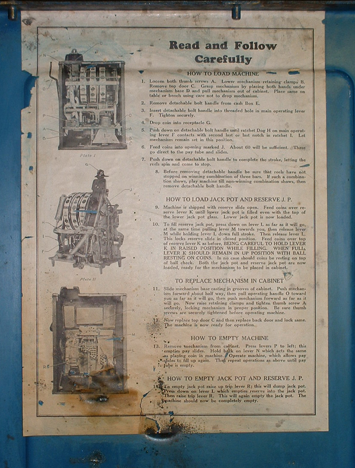

Here's another that PJ snt me
nhsodaman
Posts: 21
Joined: Sat Dec 10, 2016 8:38 pm
Re: CAILLE DOUGHBOY
Postby marsonion » Sat Dec 30, 2017 4:49 pm
nhsodaman wrote:Here's another that PJ snt me
That's a Caille Cadet doorpaper-- very similar, but a different model.
