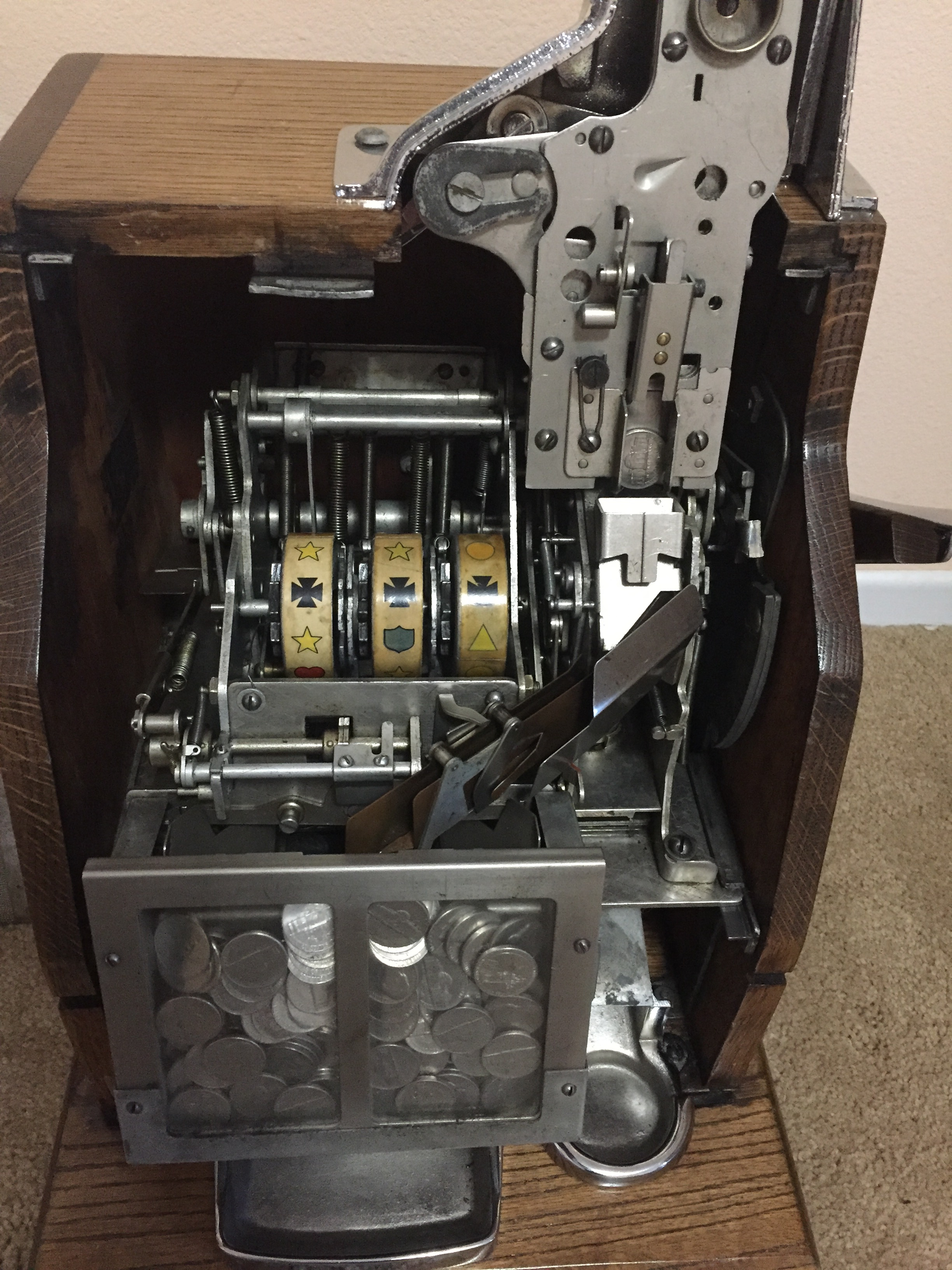

Recently acquired this Mills that has been restored and I believe the chrome front is a repro. It works like a charm . . . except the jackpot won't pay out. I've never hit the jackpot, so I set the reels to a jackpot and nothing happens. Advice? Solution?

Chris, start with the obvious. Could be that there is a coin wedged in one of the jackpots. Or more common, the jackpot components need to be manually moved a few times to free up. Maybe sat in same position for long time. Get ready to catch coins - manually open and close the jackpots several times to make sure all is intact. Line up jackpot symbols again. If doesn't release JP, examine the small post that rotates up and actuates the jackpot Use a spring hook and manually pull the post up which should rotate the cam and open the JP. Again may just not have moved for a long time and gummed up or needs exercise. With jackpot set, if manually pulling up on the post doesn't open one of the Jackpots, you may have to invest in the QT Maintenance book or take to a knowledgeable collector close by. Good luck, Flip.

Thanks Flip. Not being all that familiar with this mech, I'm not positive which posts you mean. I see two just above the JP, which I cannot move. I've also noticed a broken spring (long) on the lower right side and can't make out what it's purpose is. Can you tell me how to remove the mech? And where would I find a QT manual?

Away from home for holidays so can't send any pictures. To remove mechanism, take off back door and slide out cash box. Then slide mechanism out from front and sit on edge of table or bench so jackpots can hang down. If you look down and behind the jackpots, you can see the post (some describe it as baseball bat) that rotates up on a JP win to open one side of JP.

Thanks for the offer. Fantastic pics of the re-assembly of the QT on that link. Mine has been gone through, is clean and well-oiled. Everything looks good. Just won't open the JP doors!
