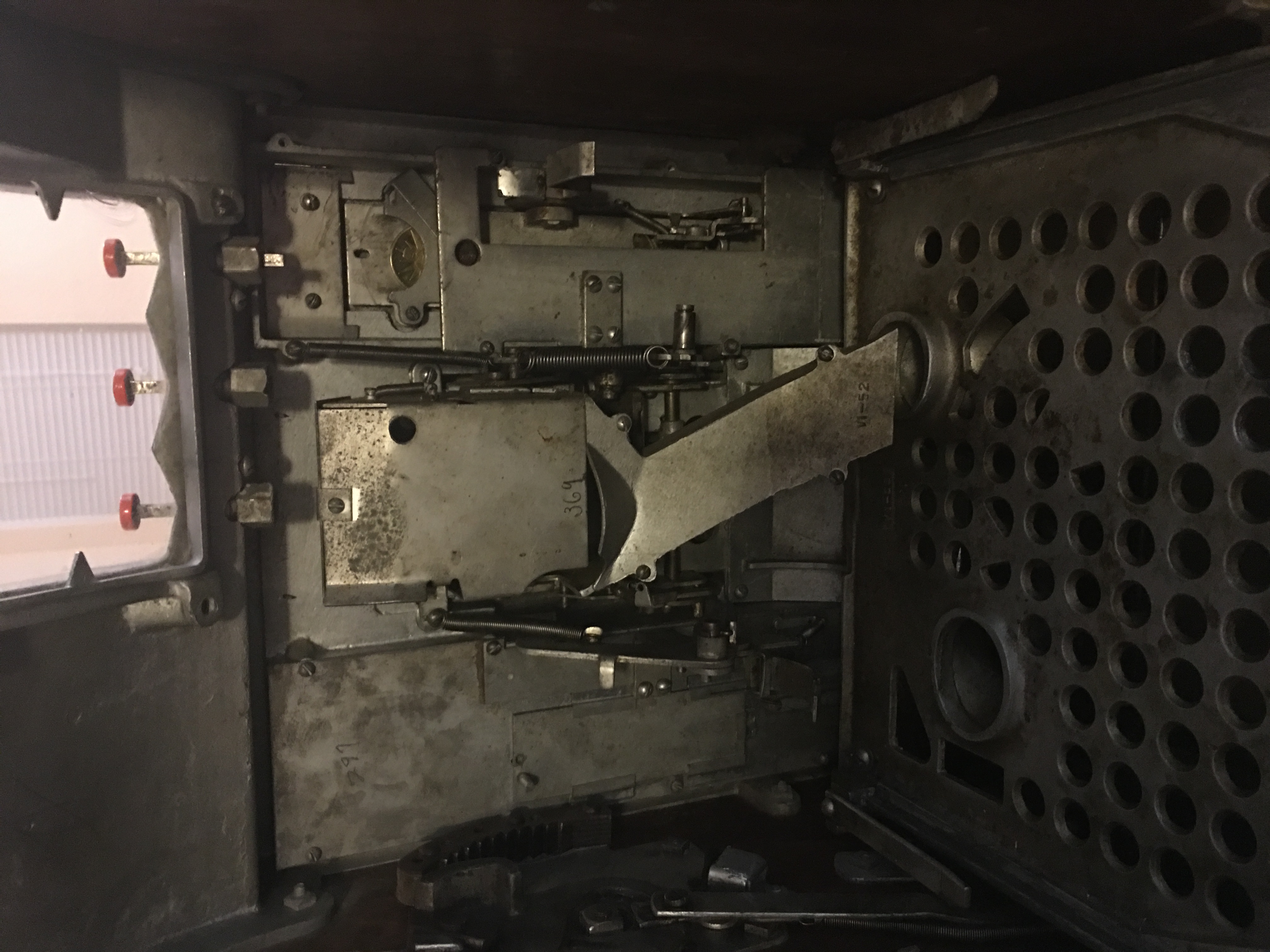

Postby sam2002 » Sun Jan 21, 2018 1:08 pm
Anyone know what attaches to this post ?
It’s attached to a rocker that has something to do with the skill stops .

Postby gsx11r » Thu Jan 25, 2018 10:35 am
Hello Sam2002
I found this photo.
I think that it will help you !!
Sorry , it s not mine , I can t give you more info.
Stephane

Re: Jennings Skill stop
Postby sam2002 » Thu Jan 25, 2018 12:07 pm
Stephane
Great photos ! Thanks !
The machine I am working on is a Jennings cetury model . It has 3 features , mint dispenser, prisperity award and
skill stops .
Interesting looks like the prosperity linkage on my machine would interfere with whatever that linkage on your photo shows?
May be a case of if one feature is present then the other is obsolete ?
The mystery continues !
Thanks again
Sam
Postby gsx11r » Thu Jan 25, 2018 12:56 pm
The mech. come from this case .
Please , post some photo of your Century .
Stephane

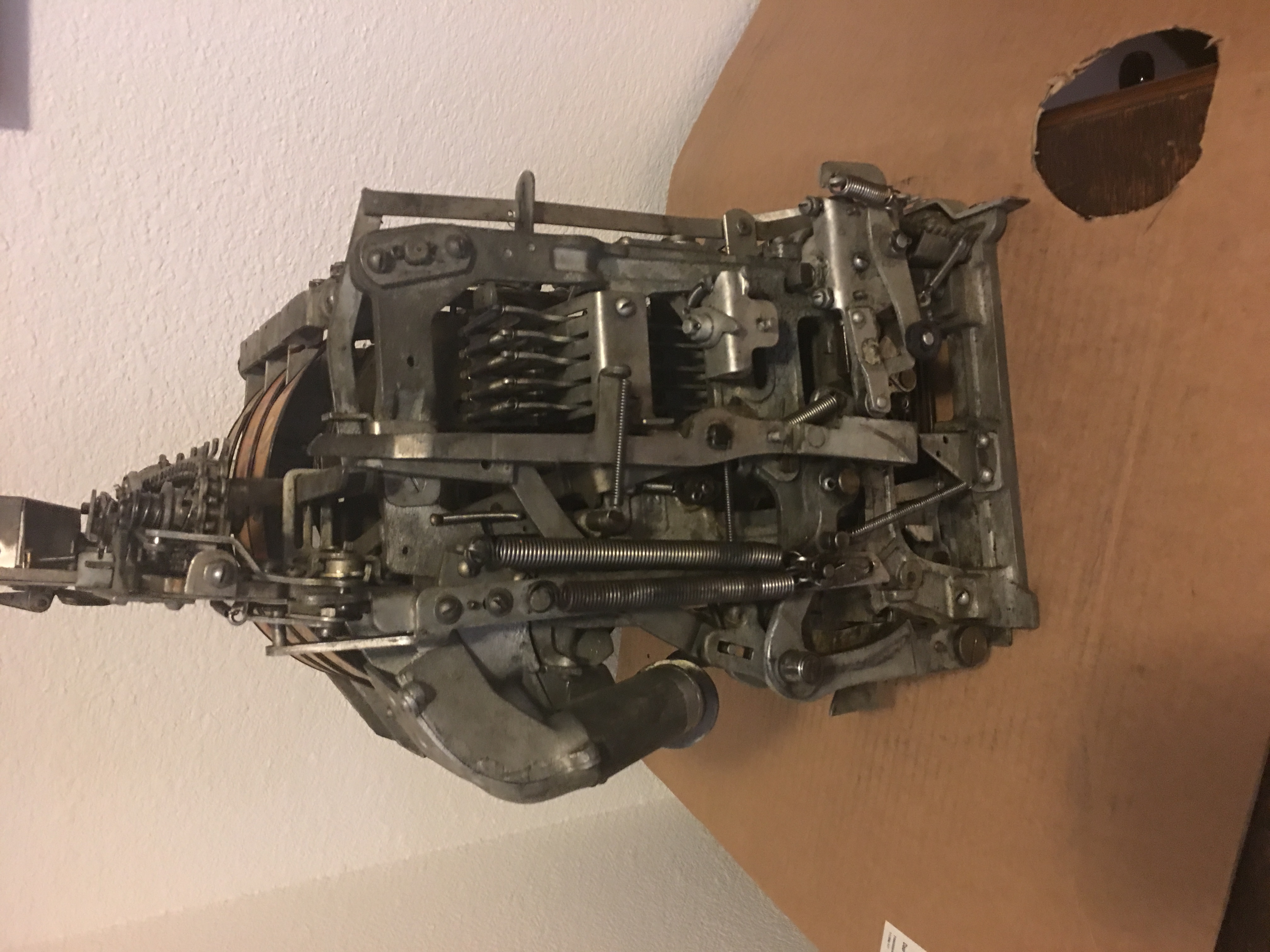

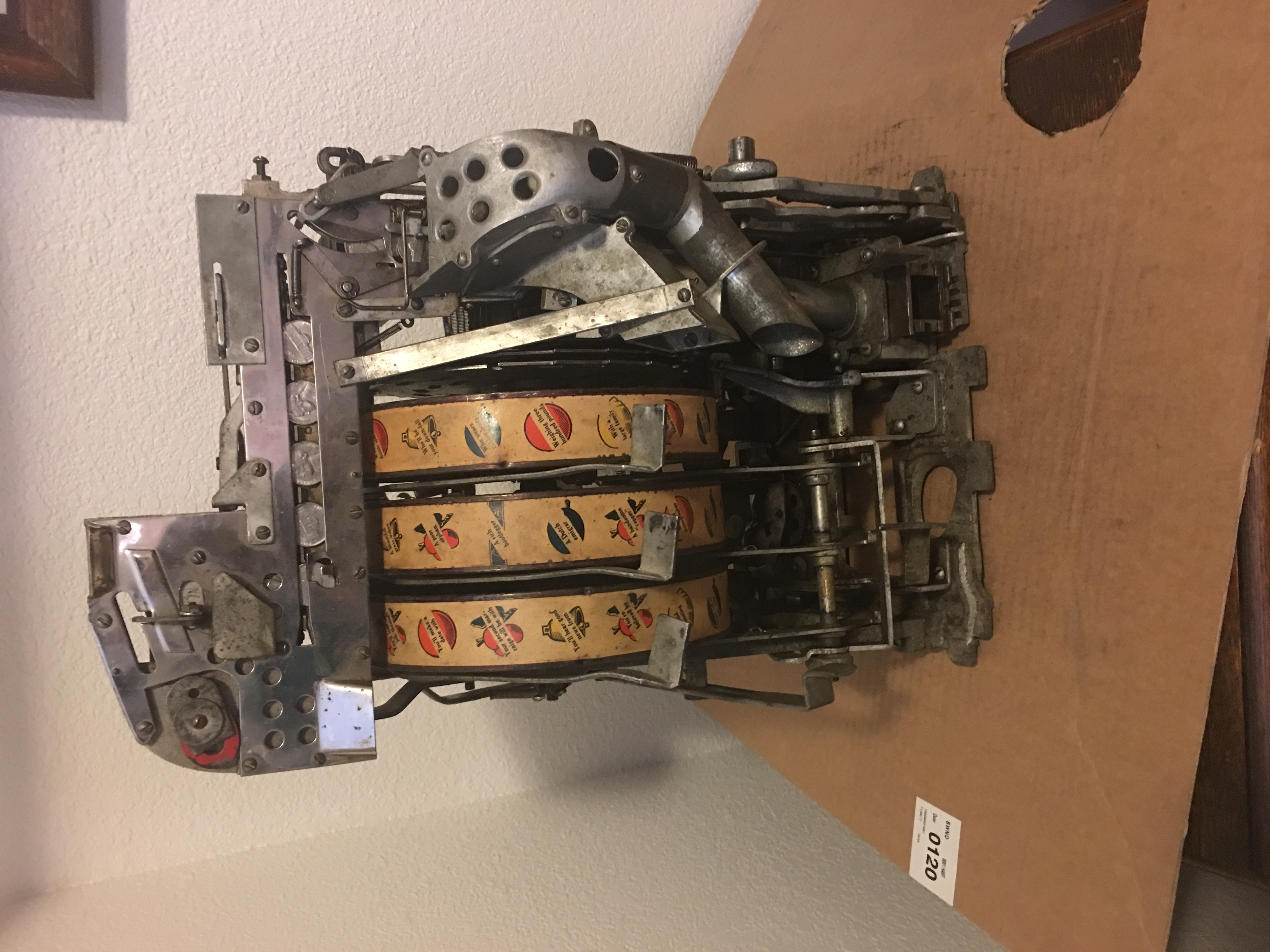

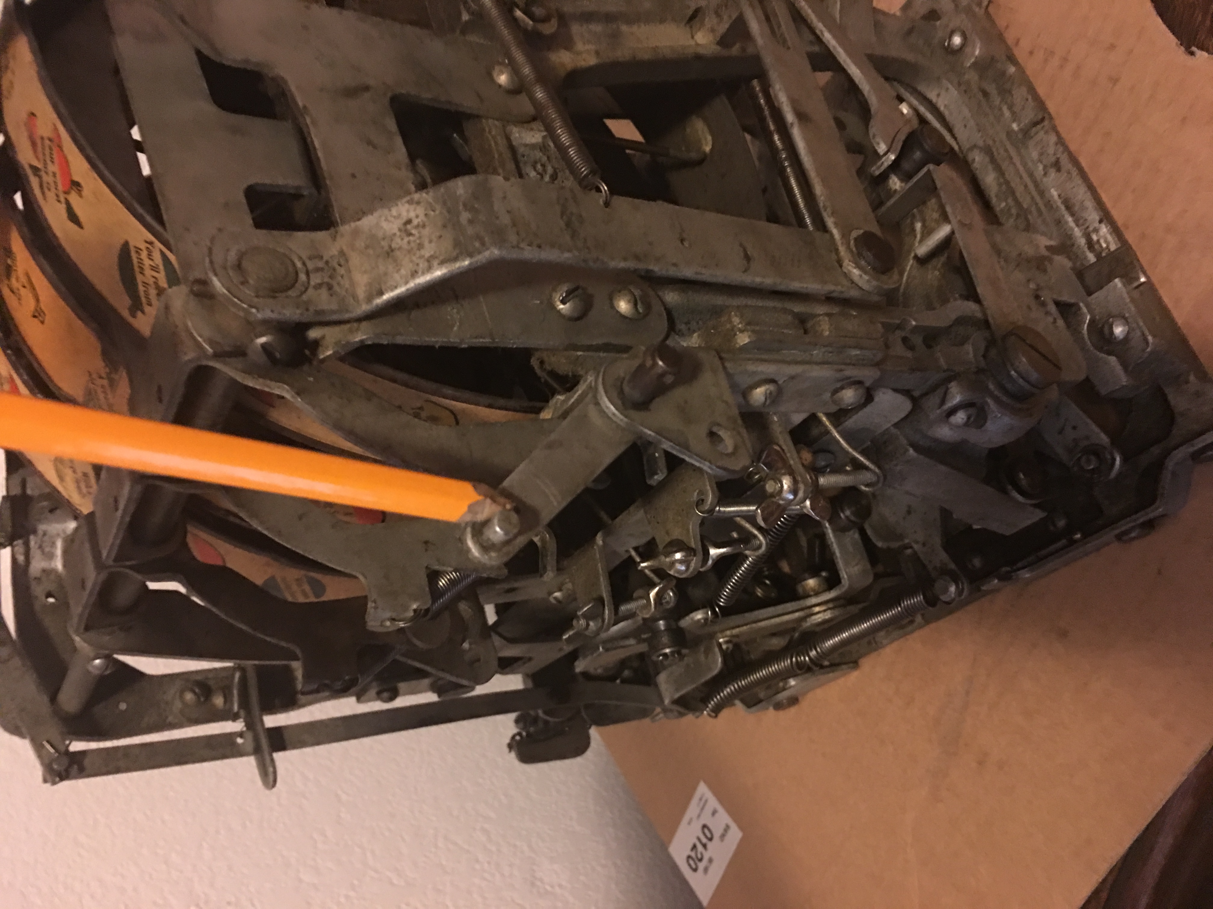

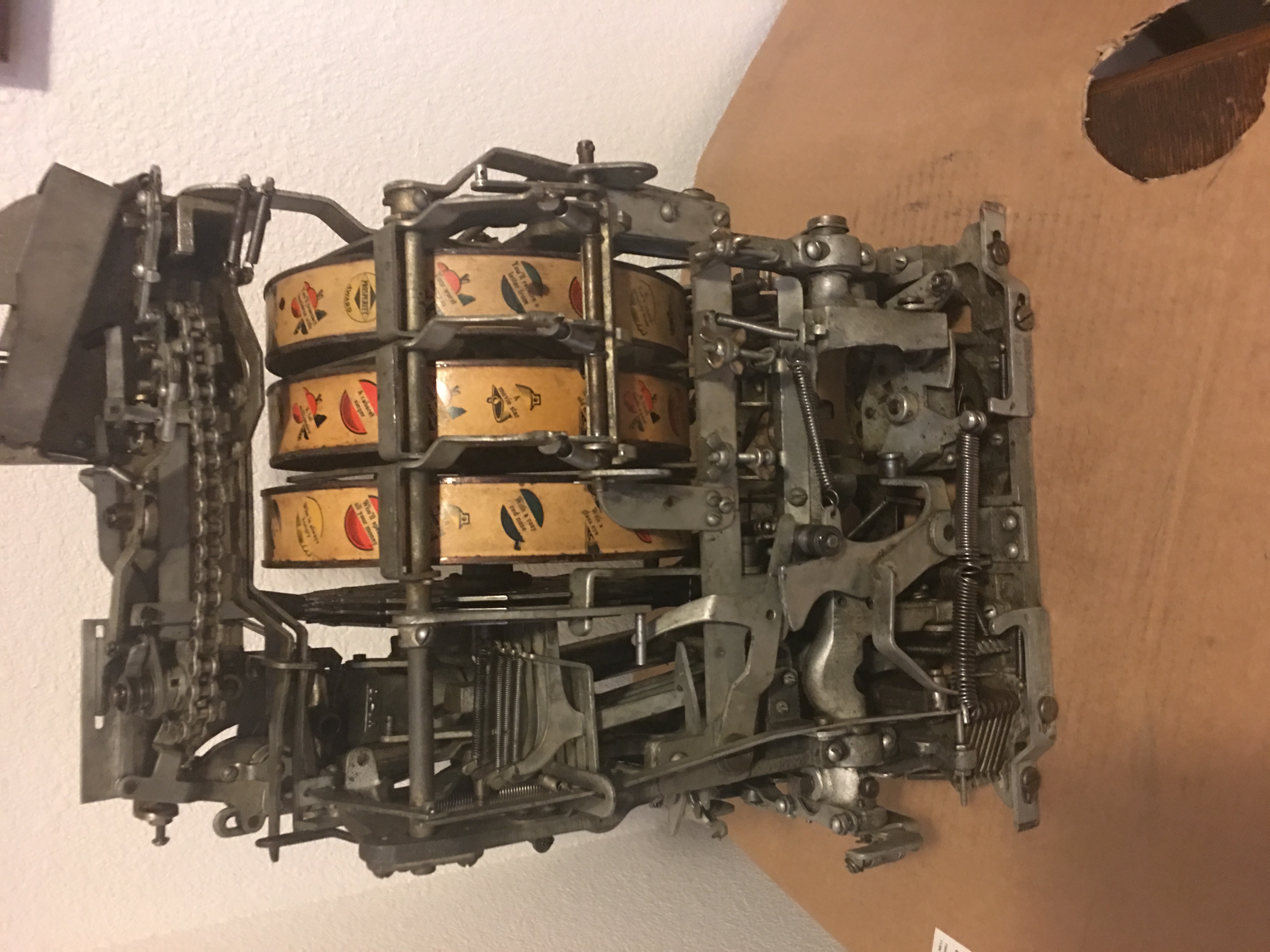

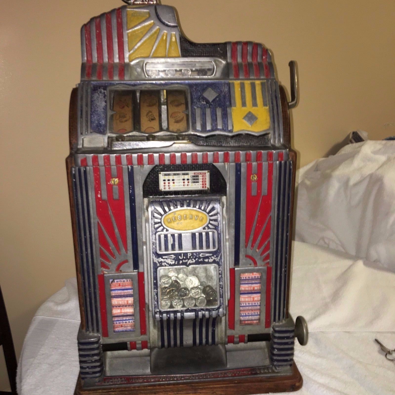

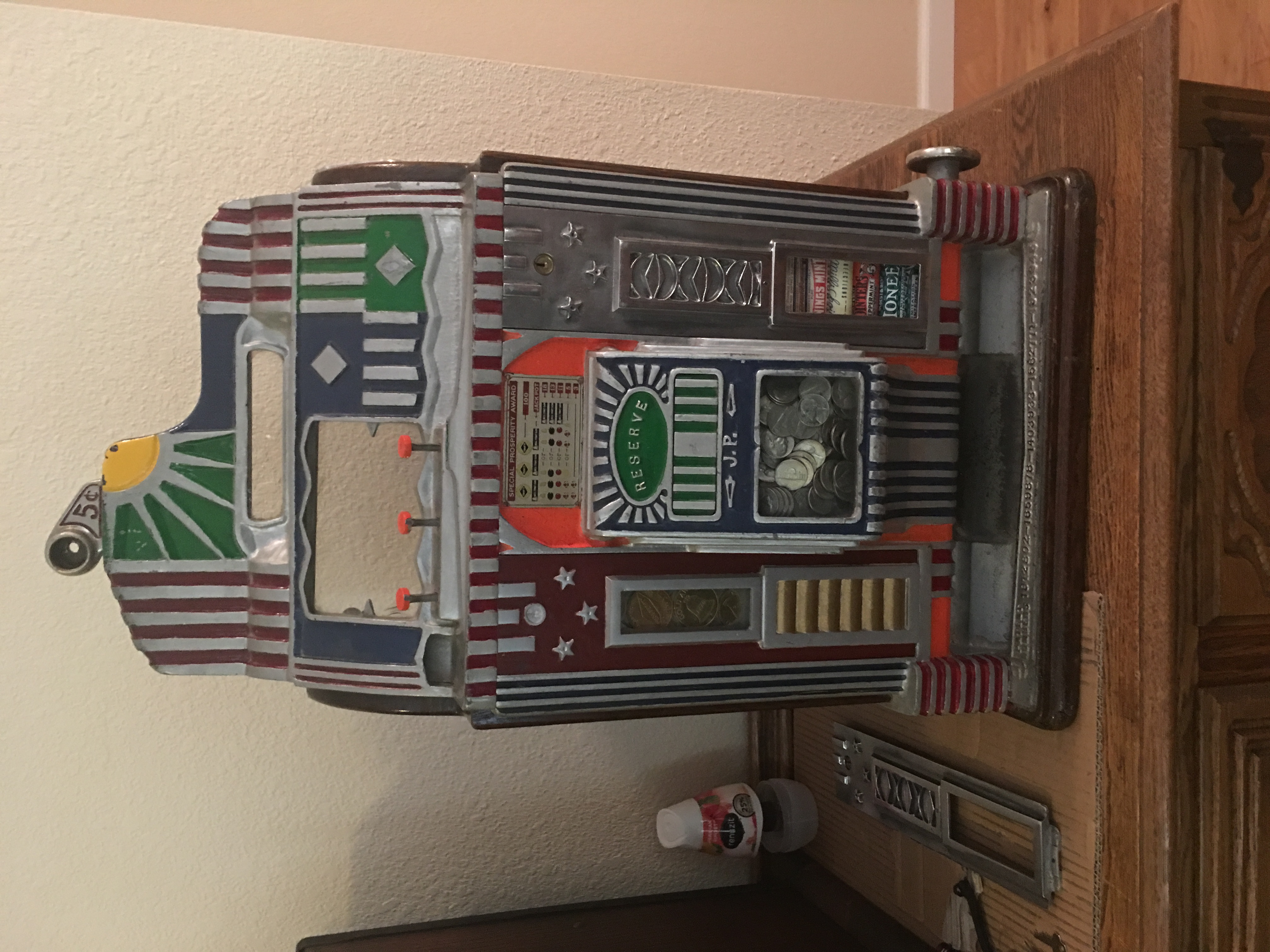

Postby sam2002 » Thu Jan 25, 2018 4:20 pm
Stephane
Here are some photos . I found this machine a couple of years ago . I plan to restore it . Someone painted the castings with aluminum colored paint and then the reds ,greens , yellows etc .
Finally found the proper mint vendor door it just came in the mail today ! Someone made a fiberglass copy of the properity door and attached it to the vendor side . They did a nice job but it just wasn’t right like that . Anyway as soon as I finish the 4 star chief I am retoring , the century will be next in line .
Sam

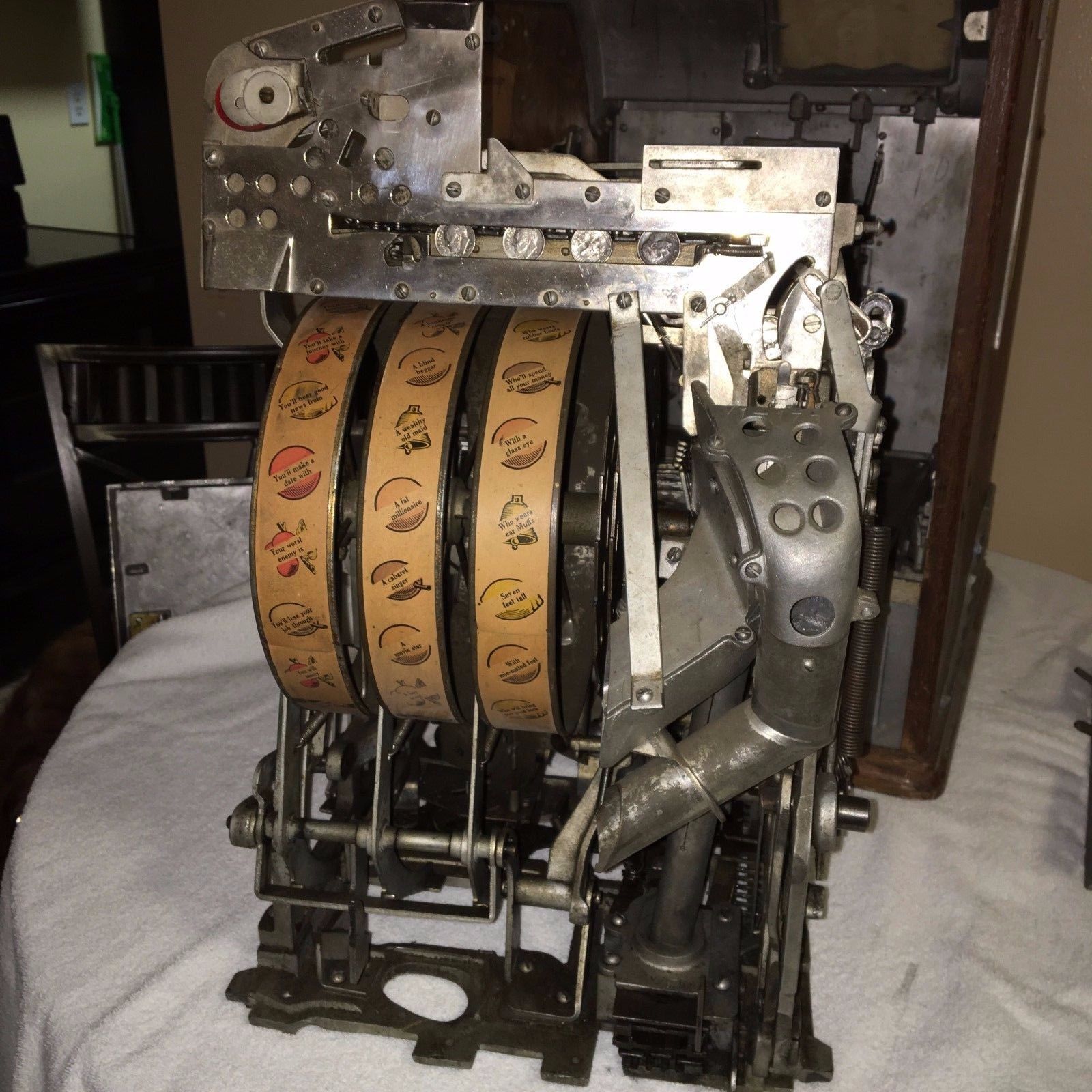

Postby sam2002 » Thu Jan 25, 2018 4:23 pm
More pics
Posts: 712
Postby gsx11r » Wed Jan 31, 2018 4:11 am
Hello Sam2002
Very nice slot machine .Post some photos when the restoration is complet.
About this Strange part with the skill stop , I mpretty sure that is the "compulsory skill" option.
With The Compulsory skill ,you need to push on the skill stop for receive the coins if you won. No Skill stop , no coins.
As this you are right with laws ,since it s skill machine and not a game of chance.
