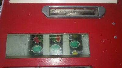

. . . however, symbol on third (rightmost) reel doesn't line up with
symbols on the first two reels :
Is this an easy fix?

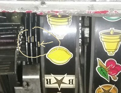

So, here's a foto of the Sega's payout wheels, showing the 3rd one out of alignment with the other two:

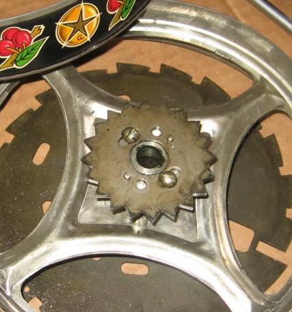

Anyway, I took the reel bundle out and apart, per oldslotman's post from Jan 2017. Here's a foto of the star wheel on the 3rd reel:
Not sure what to adjust to bring the third payout wheel back into alignment!

Postby gsx11r » Tue Mar 13, 2018 4:04 pm
Hi
Don t try to adjust the 3rd, but just adjust the first and the second one .
On your first photo , the 3rd symbol seem to be at the good place , but not the two others !
Stephane
gsx11r
Posts: 242
Location: France, Paris
Re: Payline alignment
Postby oldslotman » Tue Mar 13, 2018 5:49 pm
gsx11r wrote:Hi
Stephane
I agree. that reel looks good. The other two look out of line.

Yikes! How can you tell that it's the first and second, and not the third, that's out of line??

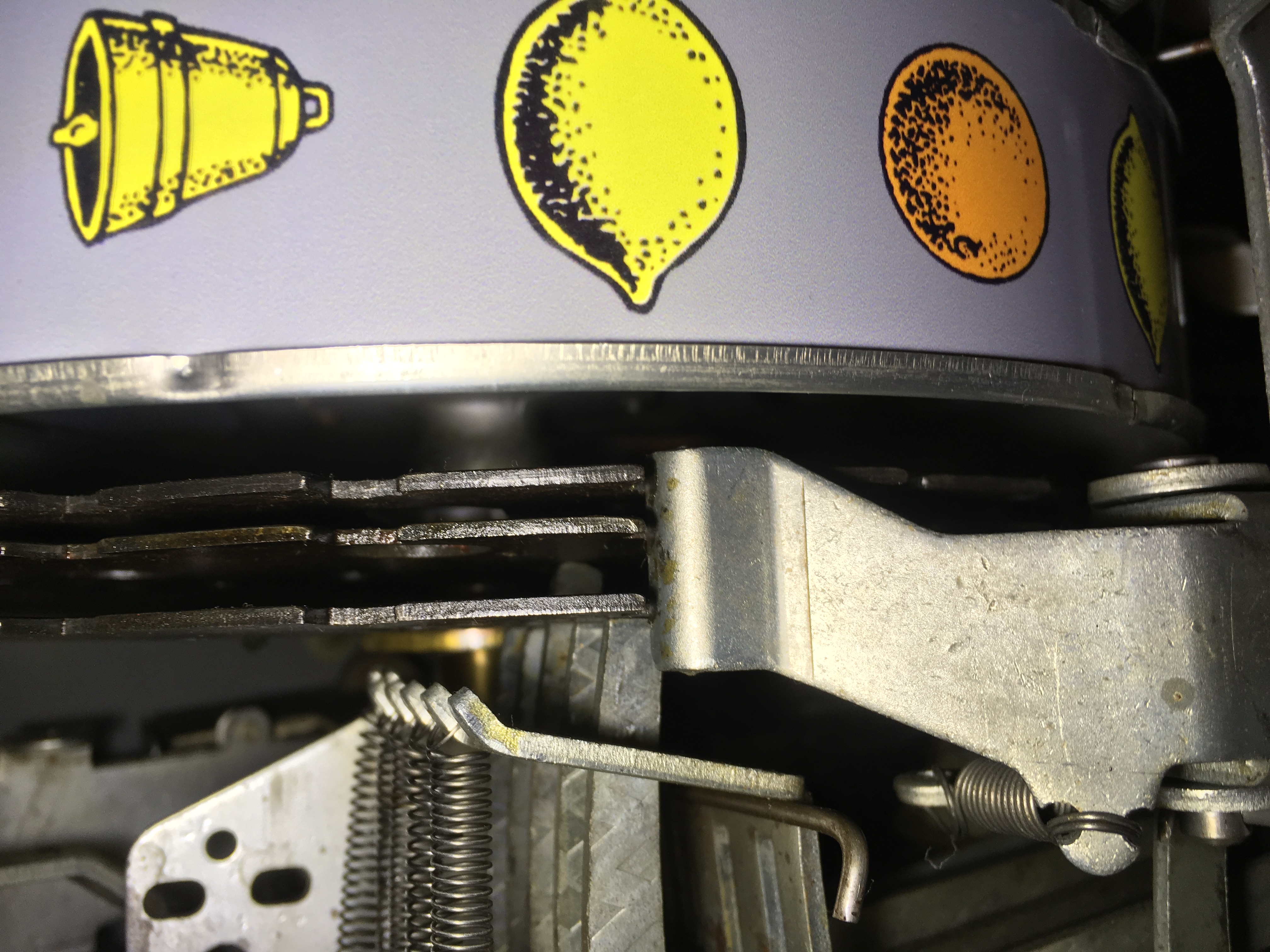

Is the stop lever seated in the notches on all three reel disc. It is the lever that holds the disc in place so they don't move prior to the reels being kicked.
