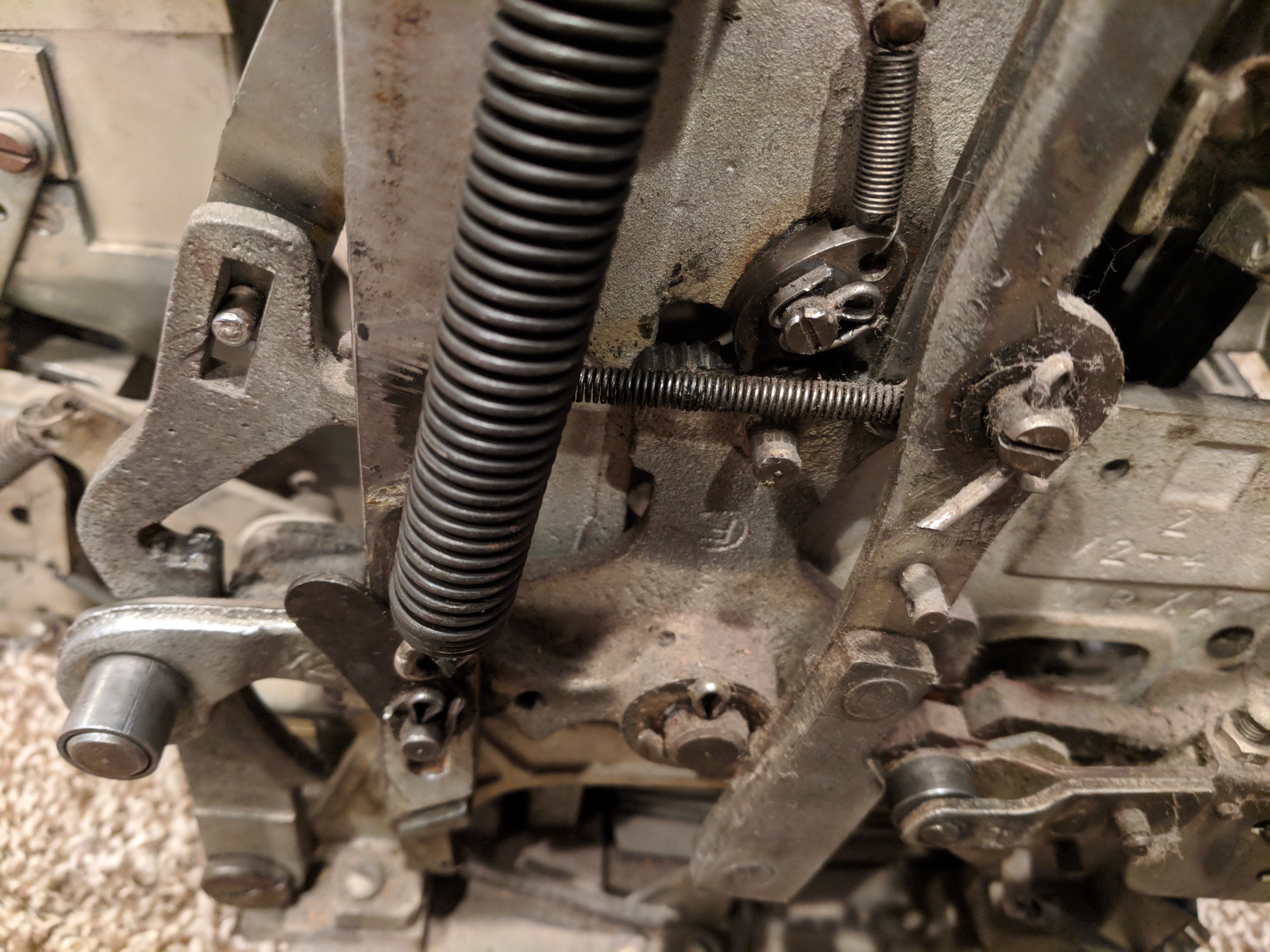

1. It looks like a spring is missing. But I'm not sure how important it was. The bracket that should hold tension on two springs has the left tooth broken off:

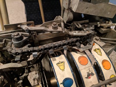

2. The escalator is very difficult to manually advance and I'm wondering if the problem is the escalator isn't advancing with the pull of the lever.
Here's a picture of the lever half-pulled and jammed:
I would really appreciate it if anyone could point me in the right direction!

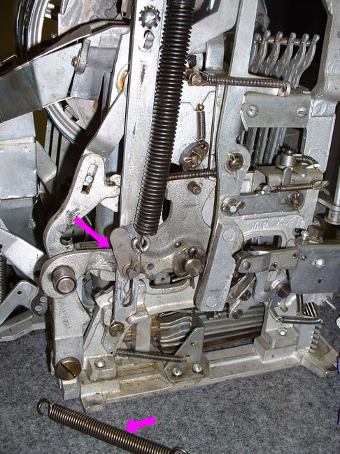

With regard to the spring issue, definitely YES, you need to replace it. I had exactly the same problem when I got my Club Chief. It took a little while to get hold of a proper replacement for the broken part (sorry, I can't find the catalog part#), so in the meantime I got it running by grinding a functional replica spring retainer out of a big washer... not exactly proud of this, but at least it worked. :oops:
