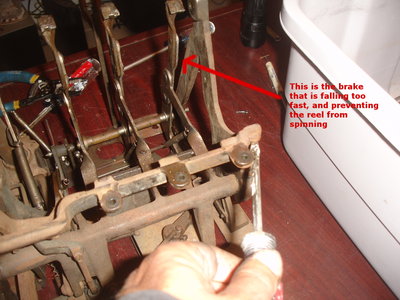

Hi Everyone,
Digging in a little deeper, it looks like it is not a vertical finger issue, but the first brake is the problem. When I cycle the machine, the brakes are being pushed out to the way, but the first one immediately falls back and stops the reel from ever spinning. So the bar on the clock is not slowly retracting in order to let the first reel spin. The other brakes are fine, it is just the first one that seems to stop the reel from spinning. Is there a way to adjust the distance the bar travels, so it goes further out and keeps the brake out of the way so the reel spins? Or should I bend the fans on the clock to make it take a longer time to retract? Any advice would be much appreciated.

Postby mechanic » Mon Jan 14, 2019 2:54 pm
From the pic it looks like a gooseneck Mills. Is the reel stop timing lever under the reel stop levers stepped or is it a straight bar? If a straight bar then the problem may be the reel stop levers are not right. The stop levers should be different lengths at the feet. The one in the pic should have the longest foot, then #2 should be shorter and #3 shorter yet. Many times these are messed up and need to be reinstalled in proper sequence. If you have the stepped reel stop timing lever then the problem may be a shortened timing link between the lever and clock. Last they made the stepped lever in two styles with the link mounting pins in different spots. You may have the wrong style lever.

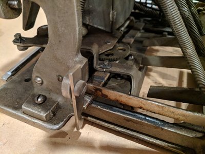

First off, thanks for you expertise. I appreciate your help. This is a Jennings Rock Ola. Here is a picture from the left hand side, (if you are facing the mech) It looks like starting from the left it is short, then medium, then large. I believe the reel stop timing lever is stepped. Is this the correct order?
Can you explain the "shortened timing link between the lever and clock" I am not sure exactly what you are talking about.
Thanks again,
Phil

Postby mechanic » Wed Jan 16, 2019 5:29 pm
You have the straight timing lever on your mech. So the 1st stops too soon because the 1 and 3 stops are reversed You need the extra length on the 1st stop lever and as it finishes the cycle the last stop lever should be the shortest as it has a longer travel time before it needs to drop. Pull one and three and see how it goes. If it still has issues it may be another area of the mech needs adjusting or change. The stepped timing lever is for later models where the reel stop levers all have the same size feet.

Postby Onemoretime » Fri Feb 22, 2019 9:11 am
pb4sc wrote:Hi Mechanic,
[attachment=0]IMG_20190115_190513.jpg[/attachment
Thanks again,
Phil
Would you be able to give me measurements on that " hook " piece on the left of your picture? My machine is missing it and I cannot find one so I may have to make one.
