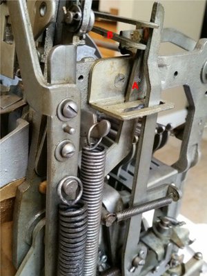

In the first picture below the lever marked 'A' was apparently binding or moving very slowly when the Crank Arm was pulled. Lever 'A' is supposed to move lever 'B', which extends all the way back to the coin slot area and has a little pin that pokes into the hole marked 'C' in the second pic WHEN THERE IS NO COIN PRESENT. The binding in lever 'A' prevented lever 'B' from ever moving, and therefore the pin never tried to poke into hole 'C'. So the machine always thought a quarter was present. Hopefully this info helps someone else in the future!
Lever 'A' was binding and moving very slowly, and not causing lever 'B' to move as it should.

So I find myself dragging up my own old post about this subject. My machine has been sitting mostly unused for about the past 2 years. Getting it back into action I found the slides were sticking or binding, but a little bit of working the machine seems to have cleared that up.
But once again the machine is operating without having to first insert a quarter. I read through and tried what "I think" I did the last time to fix it, but it still seems to operate without coins no matter what I've tried. Can anyone suggest what I'm missing here? :?:

try backing off the large shoulder screw below the main operating arm and add a few drops of 3-1 oil on the shoulder and behind the part. it acts like it's dry and does not move as it should.

LOOKS LIKE PART V2-10 IS NOT MOVING FORWARD ENOUGH TO CATCH THE PORK CHOP (V2-50). check the big screw on V2-10 it may need oiling. also check the spring attached to the top of V2-10 it may not be strong enough to pull.
