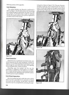

I know this is probably a fairly simple question but do the pins in the one picture (shown by red straws) go in the holes (shown by toothpicks) in the other picture? The upper pin won't line up without some bending and I don't want to go adjusting things I don't understand.

Postby ThirdGenAmusement » Sun Apr 12, 2020 4:17 pm
I scanned in what I believe to be what your looking for. So see attached pic for more info but it appears one is for the check detection and one is for the coin seperation.

Postby notagator » Sun Apr 12, 2020 7:38 pm
Perfect! Just what I need to know. Thanks.
