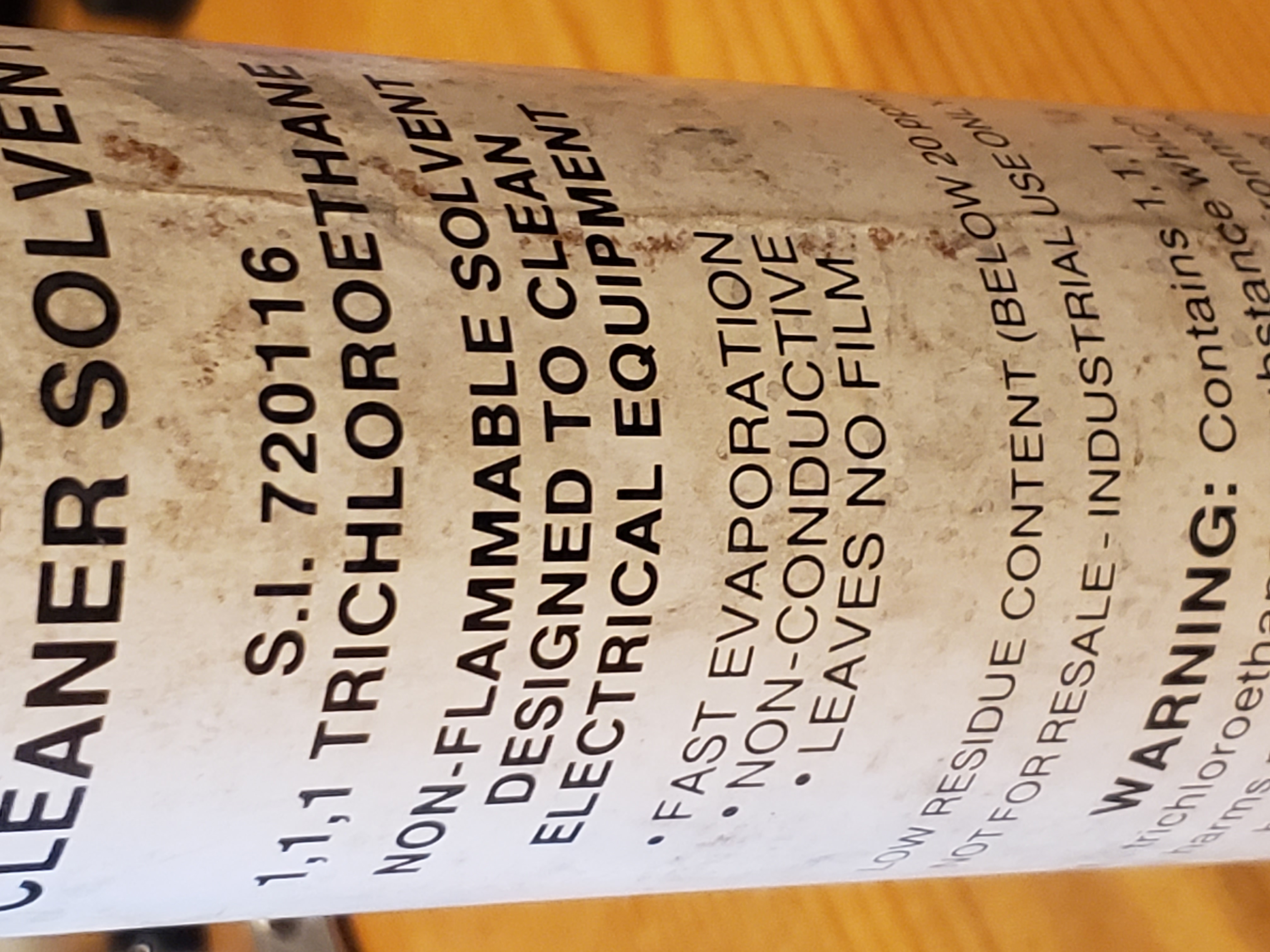

The stuff I use is contraband. It's Trichloroethane, originally used to clean electrical panels. Got them from a friend who was an electrician, and still have a stash of aerosol cans that I've kept for 40 years. so I use is sparingly. It's a hydrocarbon, so it's been blacklisted and banned for probably 15-20 years.
But there's nothing like it. Degreases, evaporates and leaves no residue or odor. It's by and far the best solvent ever made.
Seems like everything that's good is bad.

Postby RameGoom » Wed Jun 17, 2020 9:11 pm
Well, if you're intuitive, you just might find a similar solvent out there. No one will advertise, but if you ask the right questions, you'll find what you're looking for.
Key words: No Residue, Degreaser, No Odor, Removes Oil And Grease....etc.
