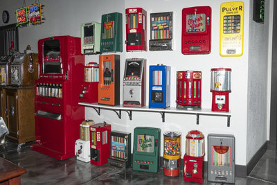

I powder coat almost exclusively, with a few exceptions.
My favorite machines to restore are tab gum machines. Powder seems to make them pop.
Also, any slot that has a black-wrinkle finish or gray hammer-tone finish, I will powder coat those. Other colors, not usually.
Here are a number of gum machines I restored in powder. With the Pulver, I powder coated the yellow, made a graphics stencil, then rattle-can-brown painted the graphics. Then an overcoat of automotive semi-clear to give it the final appearance.

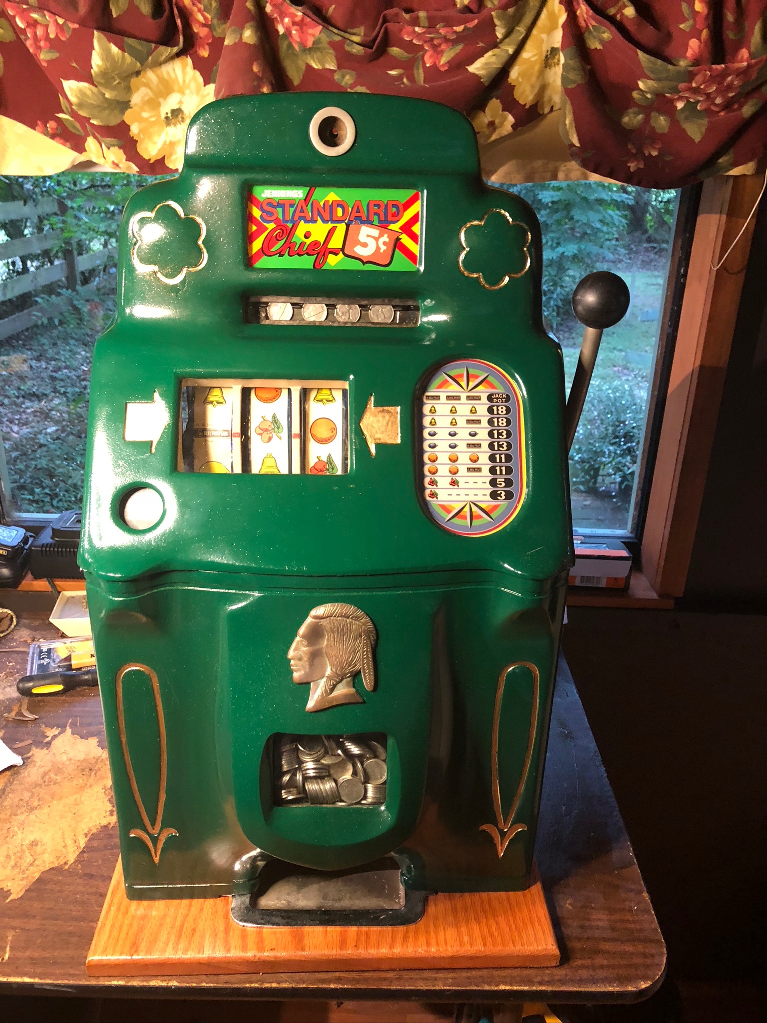

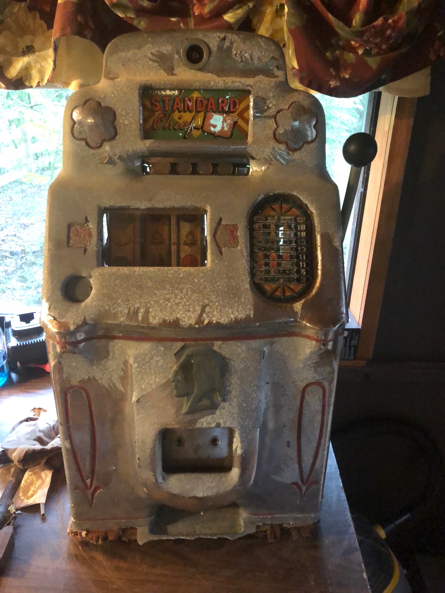

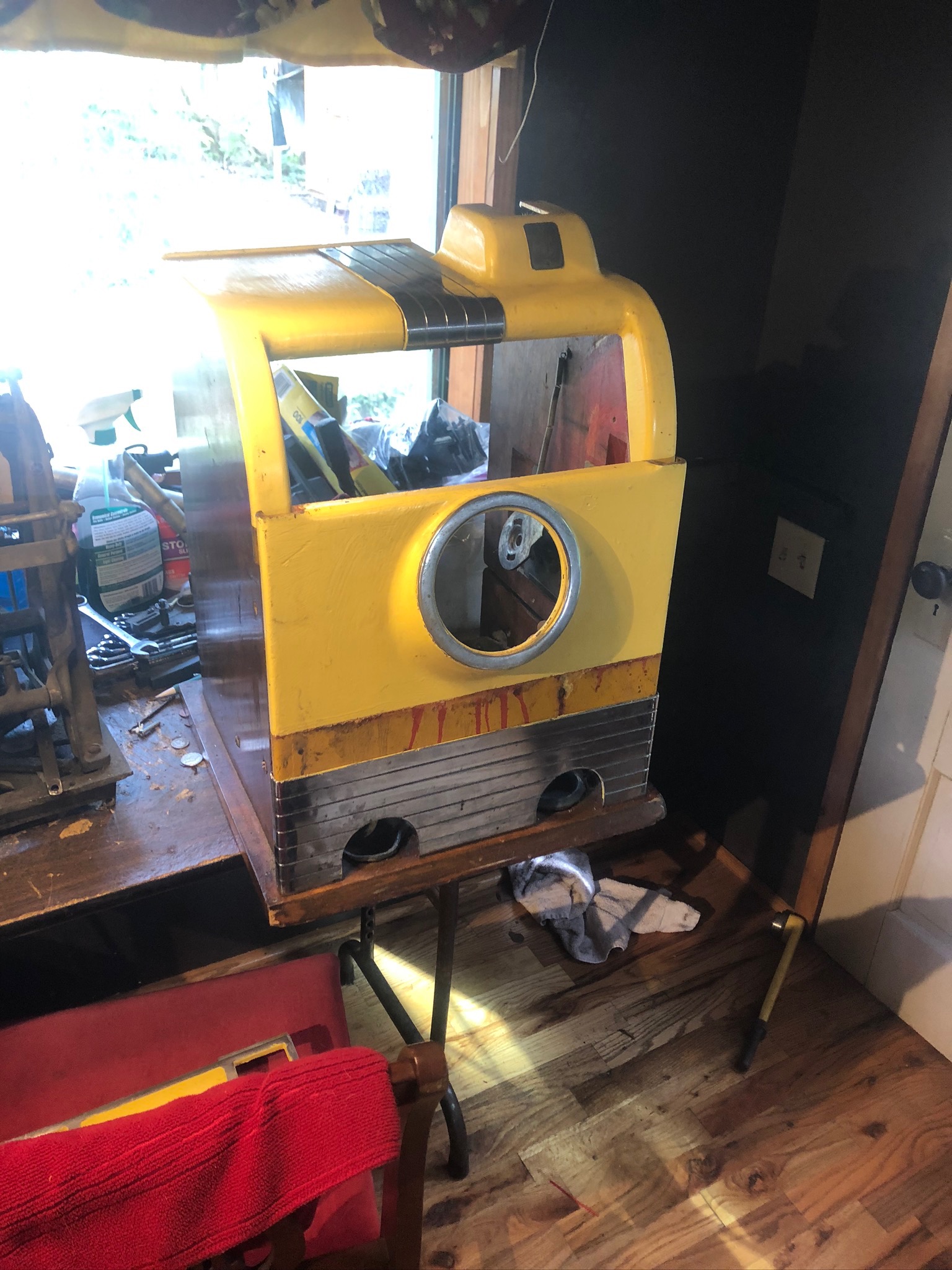

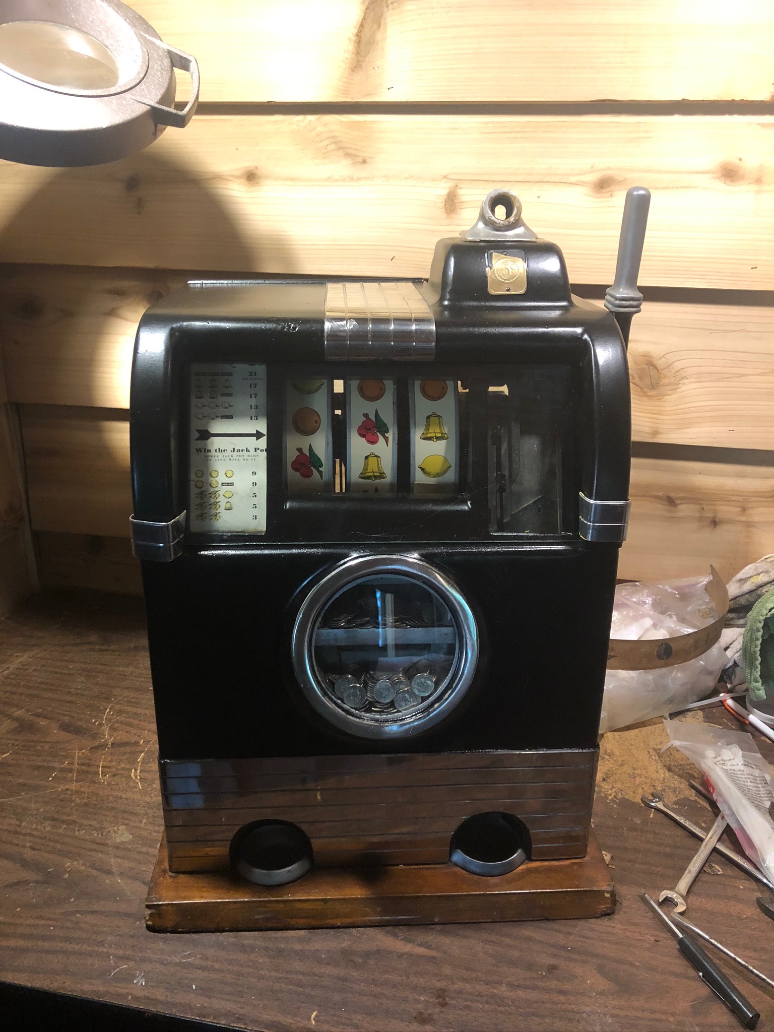

Postby wallruss001 » Sun Aug 09, 2020 12:50 pm
I have powder coated two machines. The Jennings was terribly pitted and moisture damaged, the Caille already had 3 brush coats of paint, all bad. Since these were gifts to my kids, they picked the color. I would investigate the work or recommendations of who will be doing the work. The original coater who did the Jennings moved out of town, the second shop did not prep as well.
I would not powder coat a original machine in decent shape.
