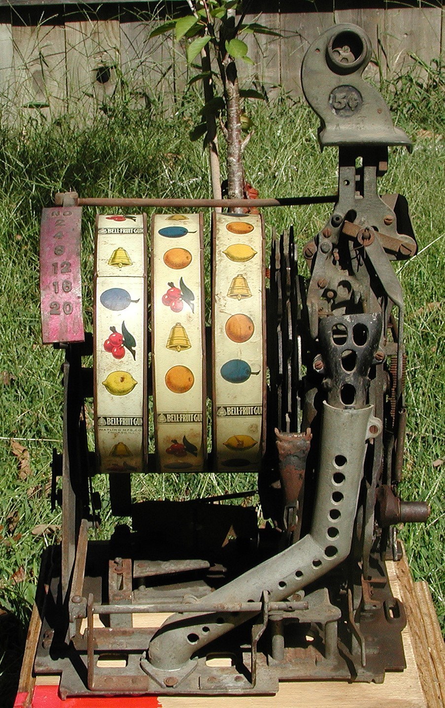

Hi there!
Could anyone explain or post a picture of the connection between machine and future pay bar? Its a Watling Blue Seal Confections.

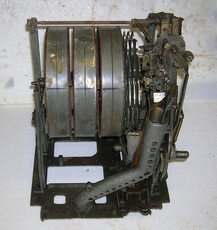

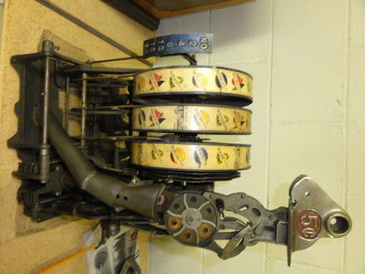

Postby gsx11r » Tue Aug 18, 2020 11:09 am
Hello
Ouch a lot of missing parts on your .
And more than you can see on this two photos .
Just give me the time to remove them from mine and I make more photos of the parts that you need .
Stephane

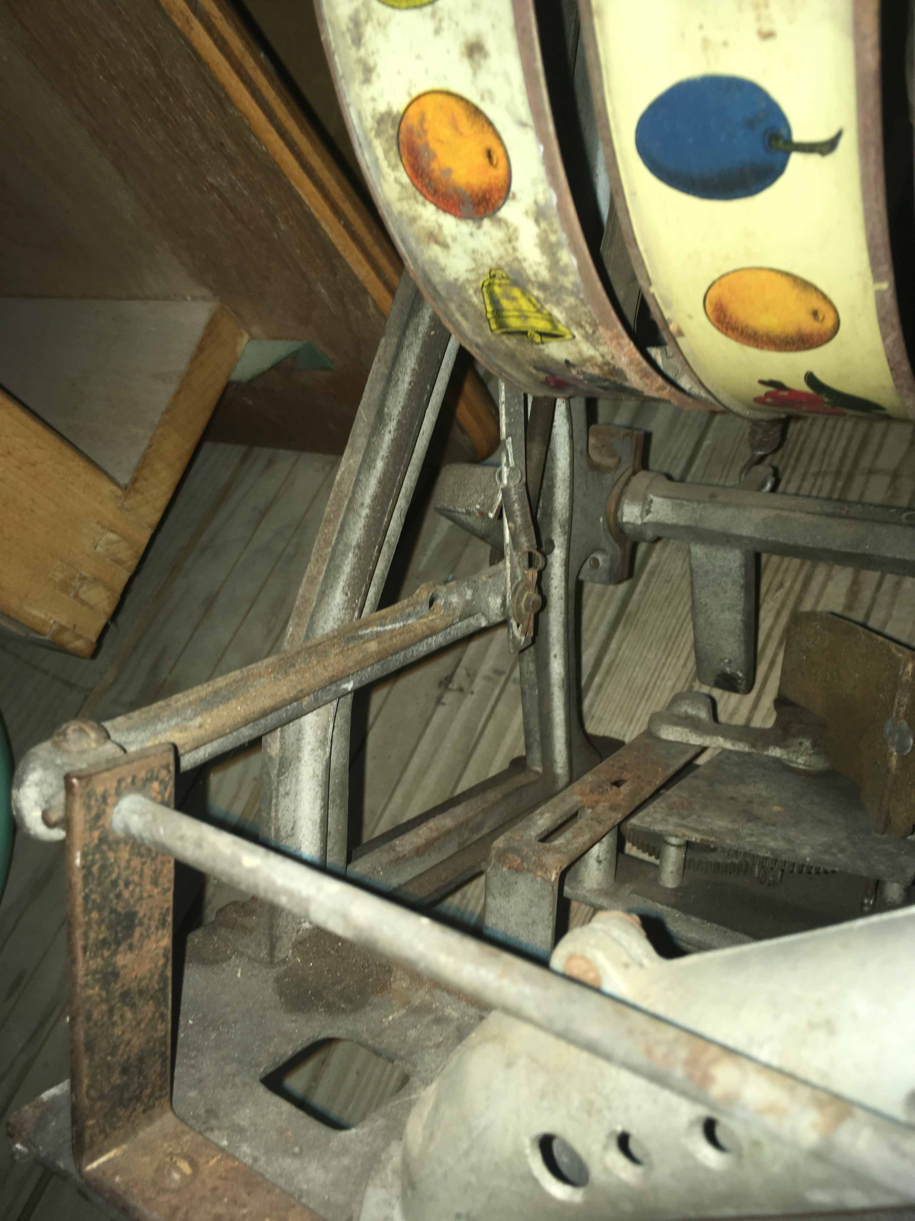

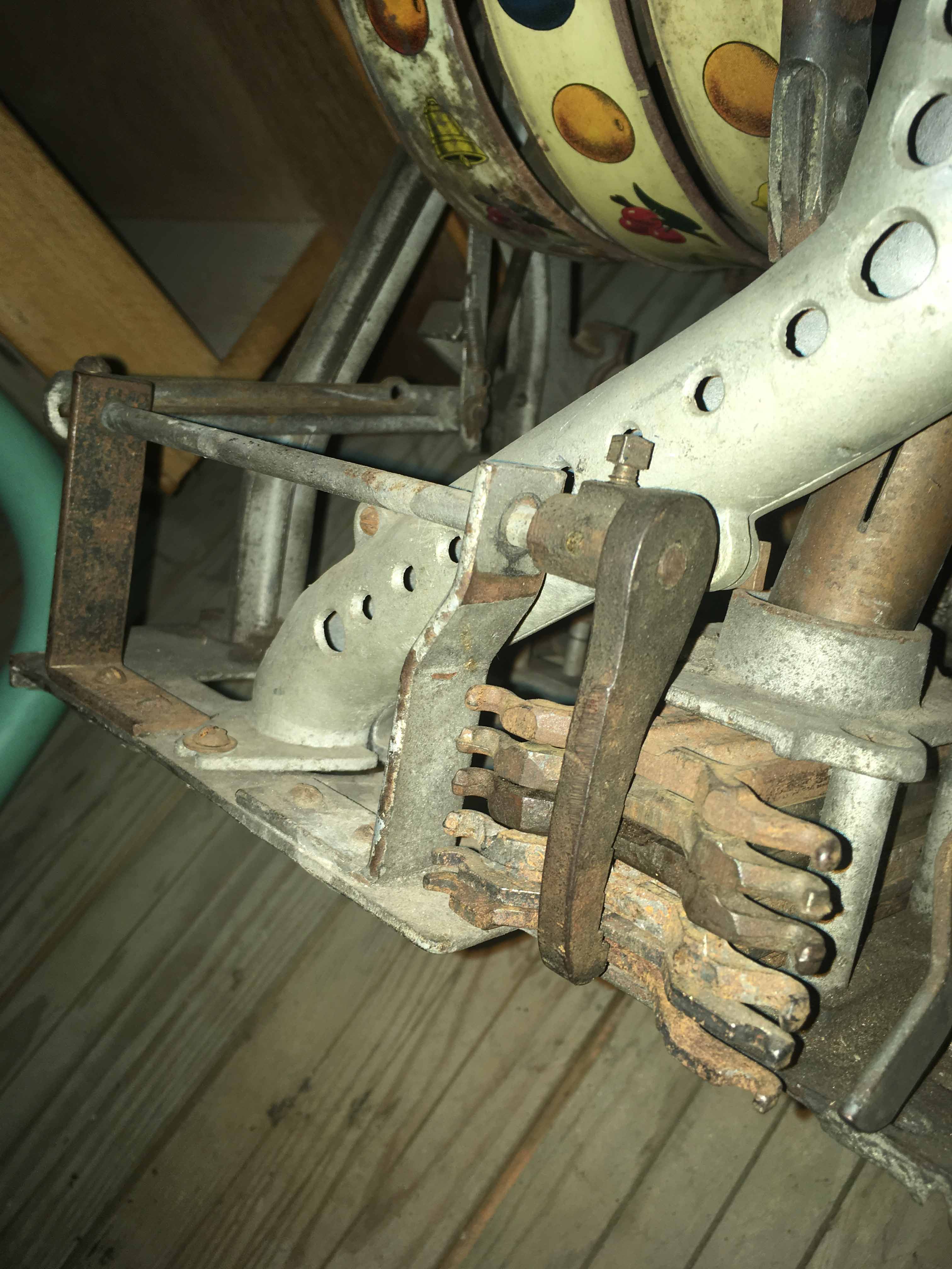

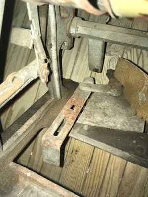

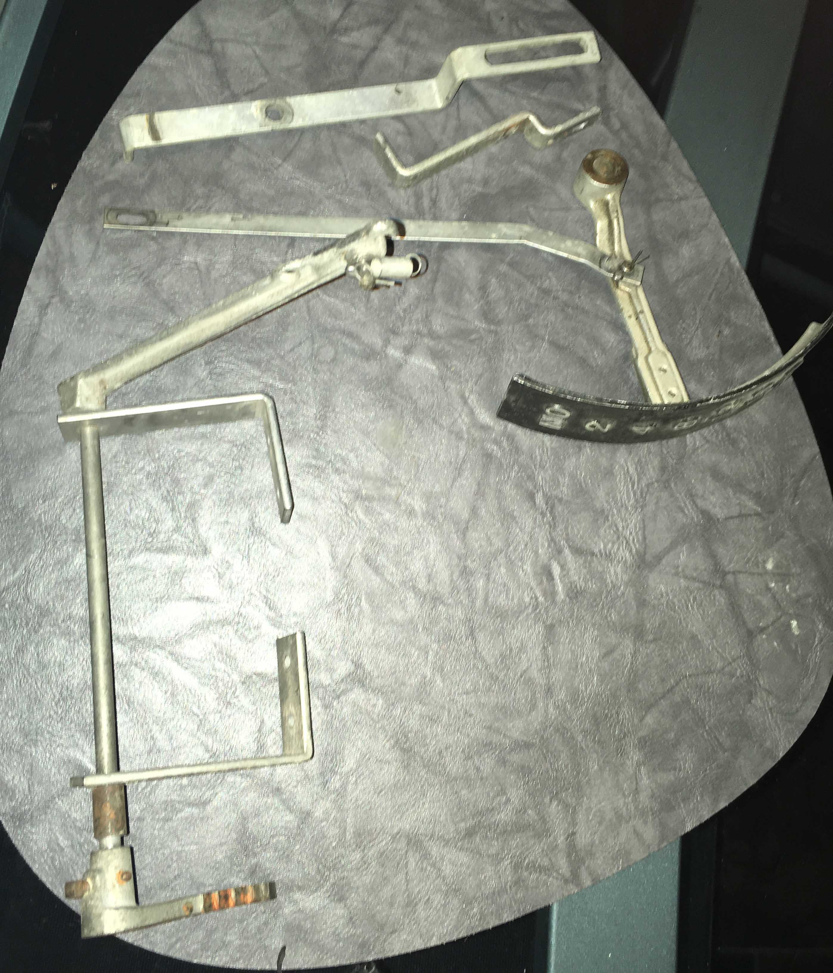

Postby gsx11r » Tue Aug 18, 2020 1:58 pm
Here is more photos.
Stephane

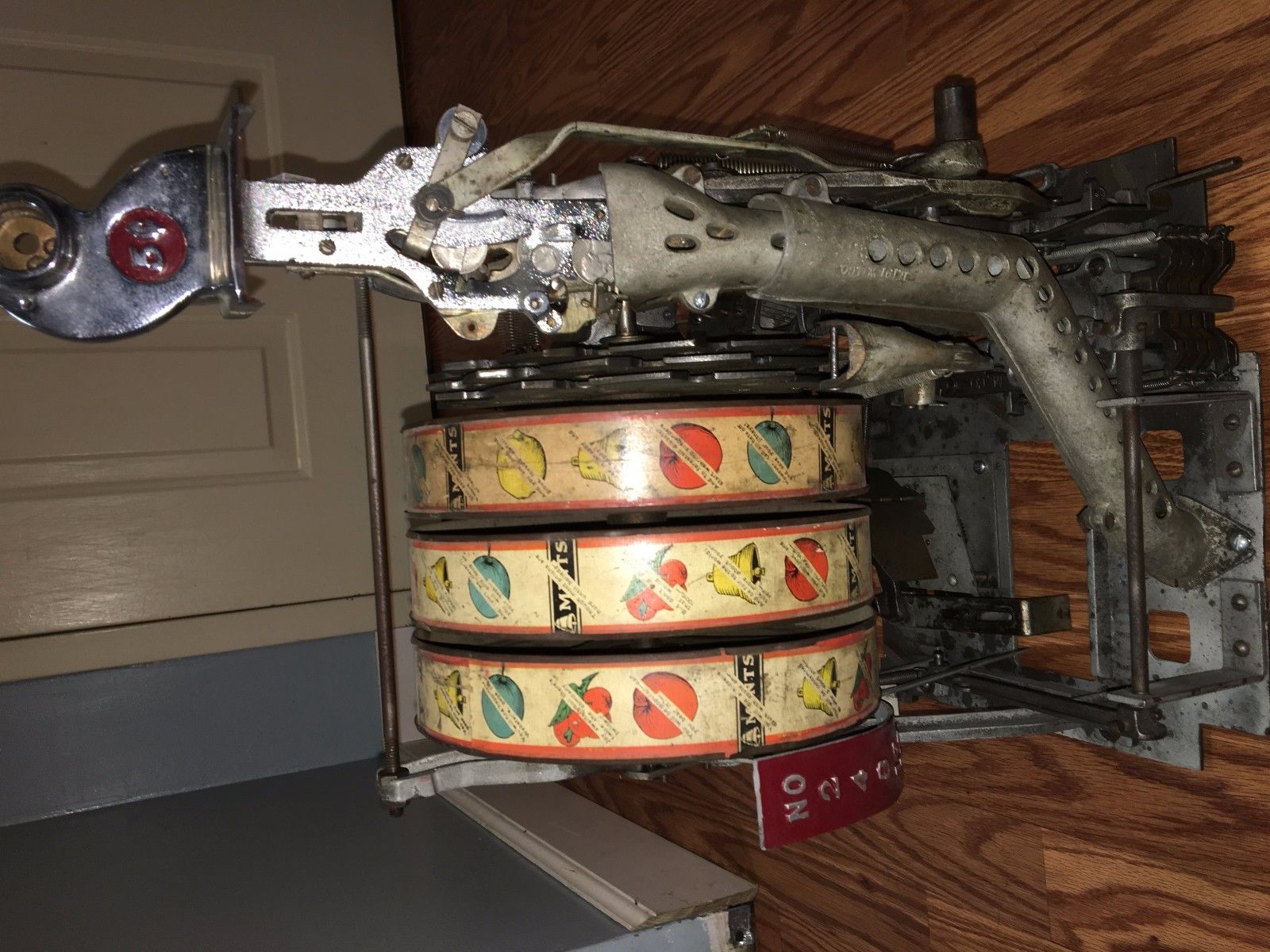

Postby flipper77 » Tue Aug 18, 2020 3:59 pm
Hope this helps. I have had two of these. Interesting - the knob next to pay slides on the one allows play out of the case - a short handle. Stephane provided more detailed pictures of the actual pieces. Bottom picture is same period Pace - note the future pay design is identical and the Pace has the small play handle also. Flip

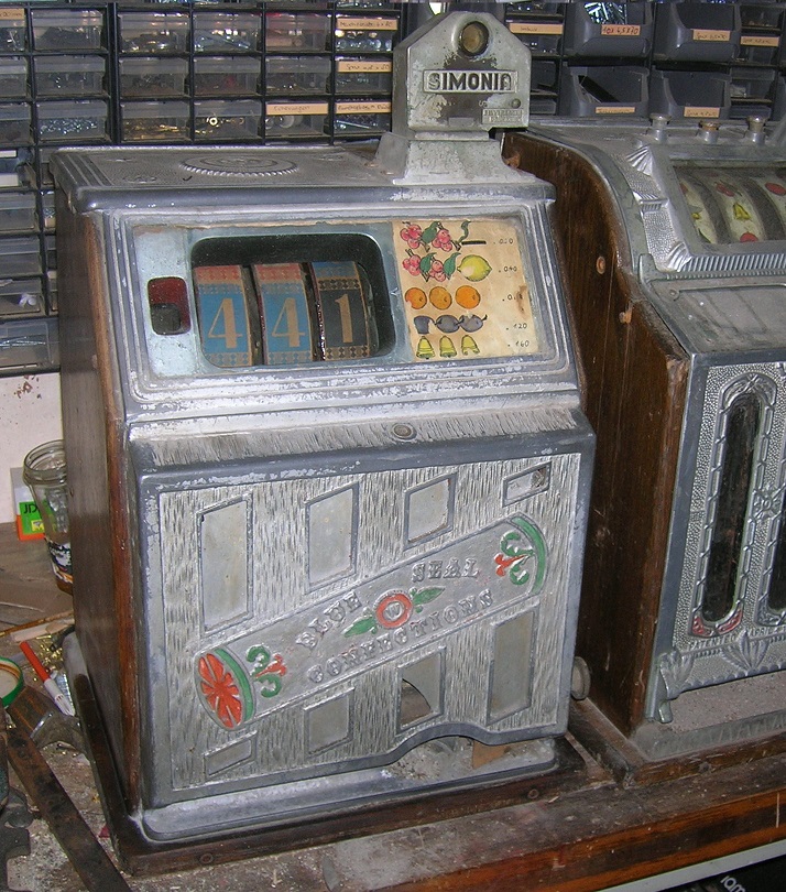

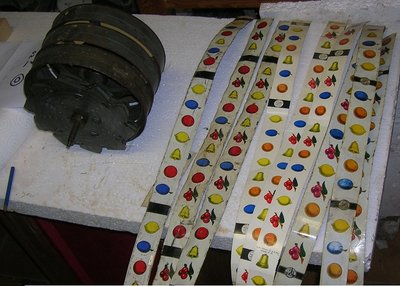

My machine were converted for the german market in the early 30s. After banning banning and WW II it was converted again (and attacked with a lot of silver paint...) in the early 50s and called Reitz III.
I started to rebuild it to the former geman version with fruit symbols on metal stripes:
