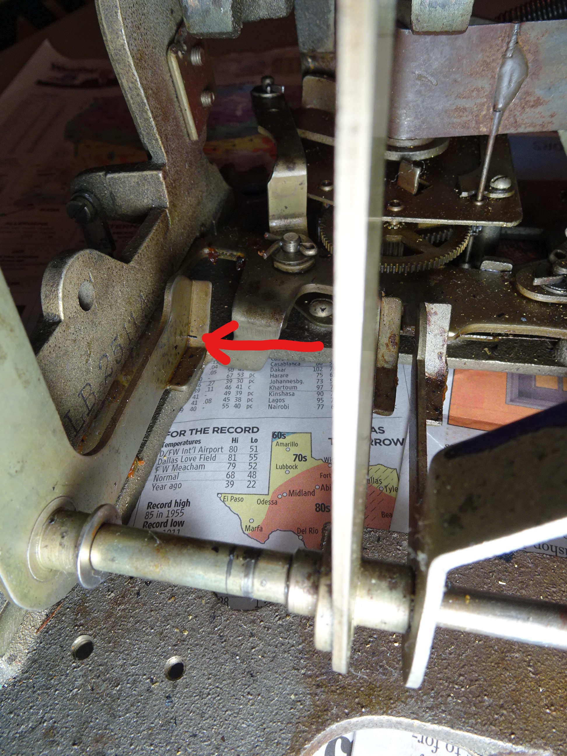

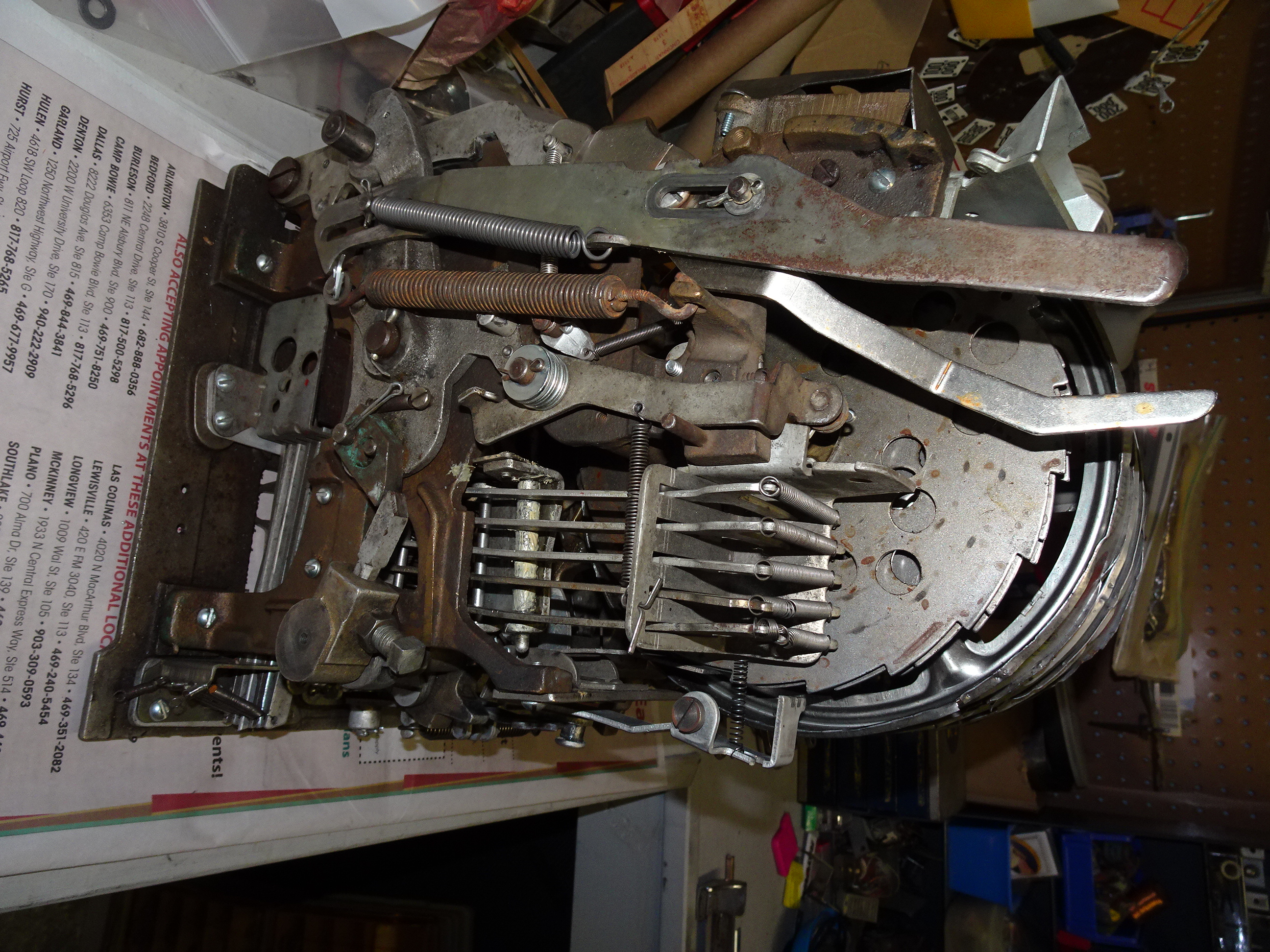

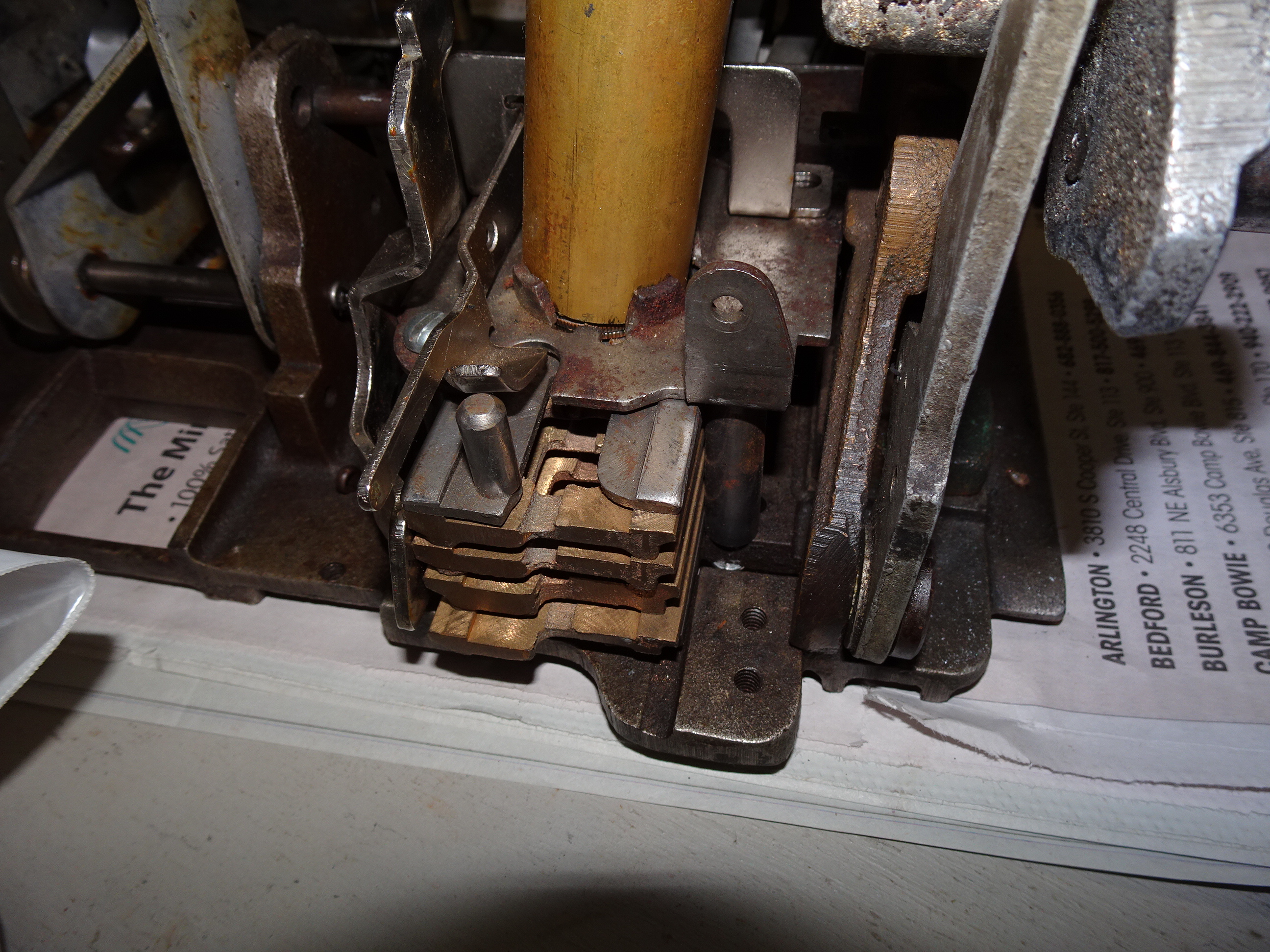

It is very tightly locked up mid-cycle and I can't seem to get it to budge. I have never encountered one in this state so I have several questions. Any help or advice would be greatly appreciated. I have attached a few photos that I hope will allow some analysis but I can provide more if needed.

Looks like your handle trip bar is not set correct. Its the last photo. Back off in it and try that.

Your were right on the money!
I backed off the chisel and was then able to exert enough pressure to get the machine to complete its cycle.

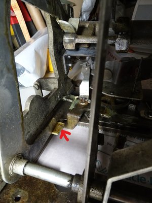

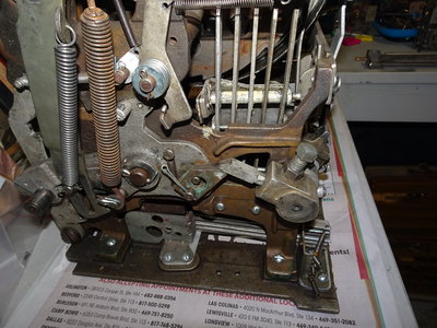

I have a Mills Black Cherry that I can use to compare various things to. I noticed today that there is a significant difference in the bottom portion of the reel stop levers....I am talking about the portion that impacts the reel timing lever assembly.
The first photo below shows one of the reel stop levers from my Black Cherry. Note the "ski jump ramp" configuration at the end of the lever pointed to by the red arrow.
The second photo shows one of the reel stop levers from my Chrome Diamond Front. Notice the "ski jump ramp" is simply not there.
All three reel stop levers on each machine are consist in configuration with their brothers.
Is this a change in design at some point or could the lack of a "ski jump ramp" on the Chrome Front be the cause of my reels stopping so quickly?
Thanks for your help.

Postby radiorich123 » Wed Dec 02, 2020 6:42 am
Yea that should be at an angle looks like its almost straight.

Postby oldslotman » Wed Dec 02, 2020 1:47 pm
That is your problem. Replace that first reel spot lever and you should be good.
