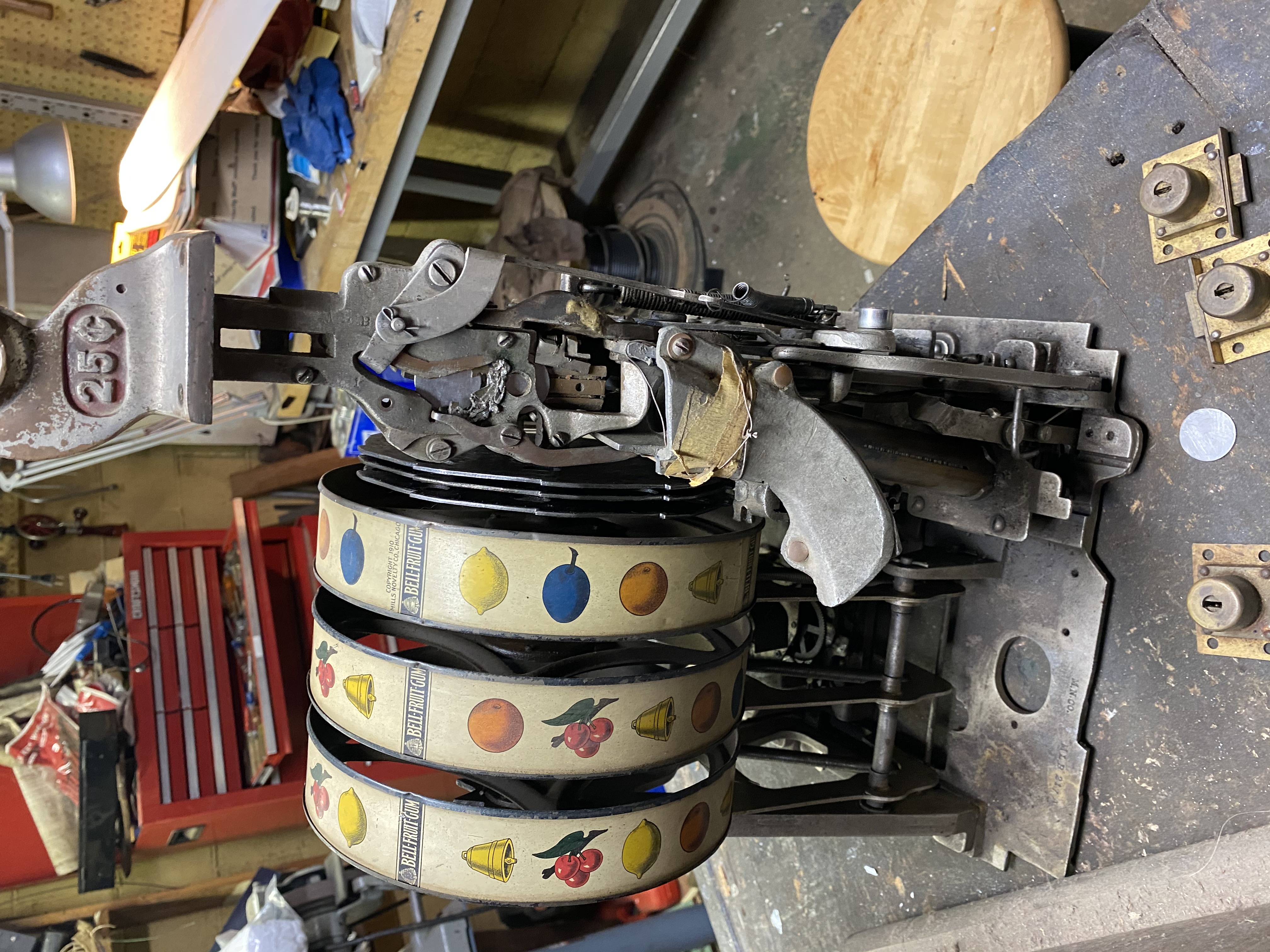

This machine has been in the family for a very long time. Story is my fathers uncle owned a bar and this slot was in it. My father is from Utica, NY and it has the Roberts Novelty Jackpot front. Roberts was in Utica. This poor machine has been fixed over the years by my brother and father using what we had laying around. Keep in mind we do car restoration as a hobby and are all fairly good at mechanical stuff. I have repaired many late model pins and a few Seeburg Jukes. I do board level electronics repair.
I have been having troubles with slugs getting caught in the neck. They were over running each other. These slugs are thinner then a real quarter. After looking at the coin slot and running some real quarters I believe my solution is to run real quarters.

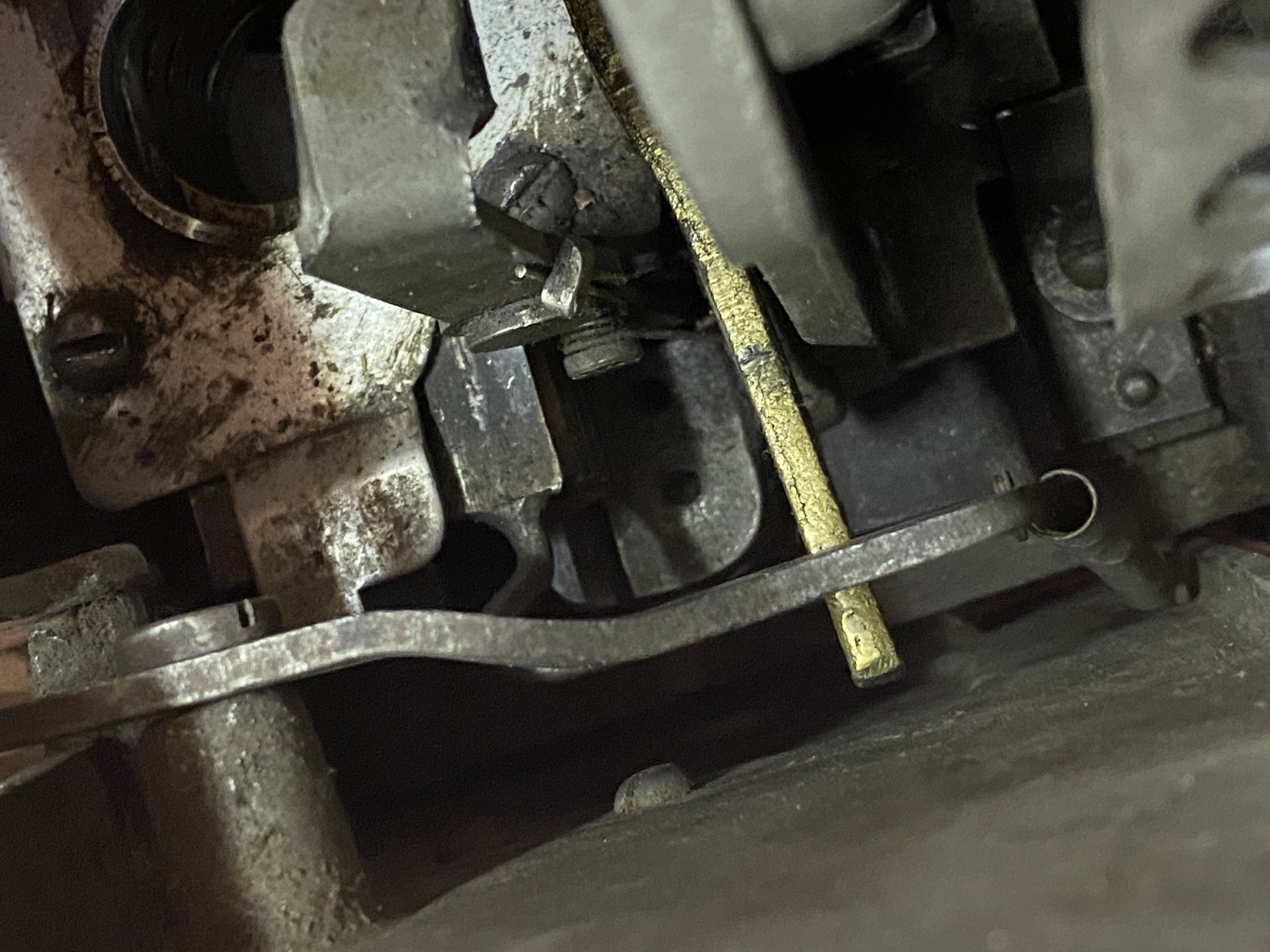

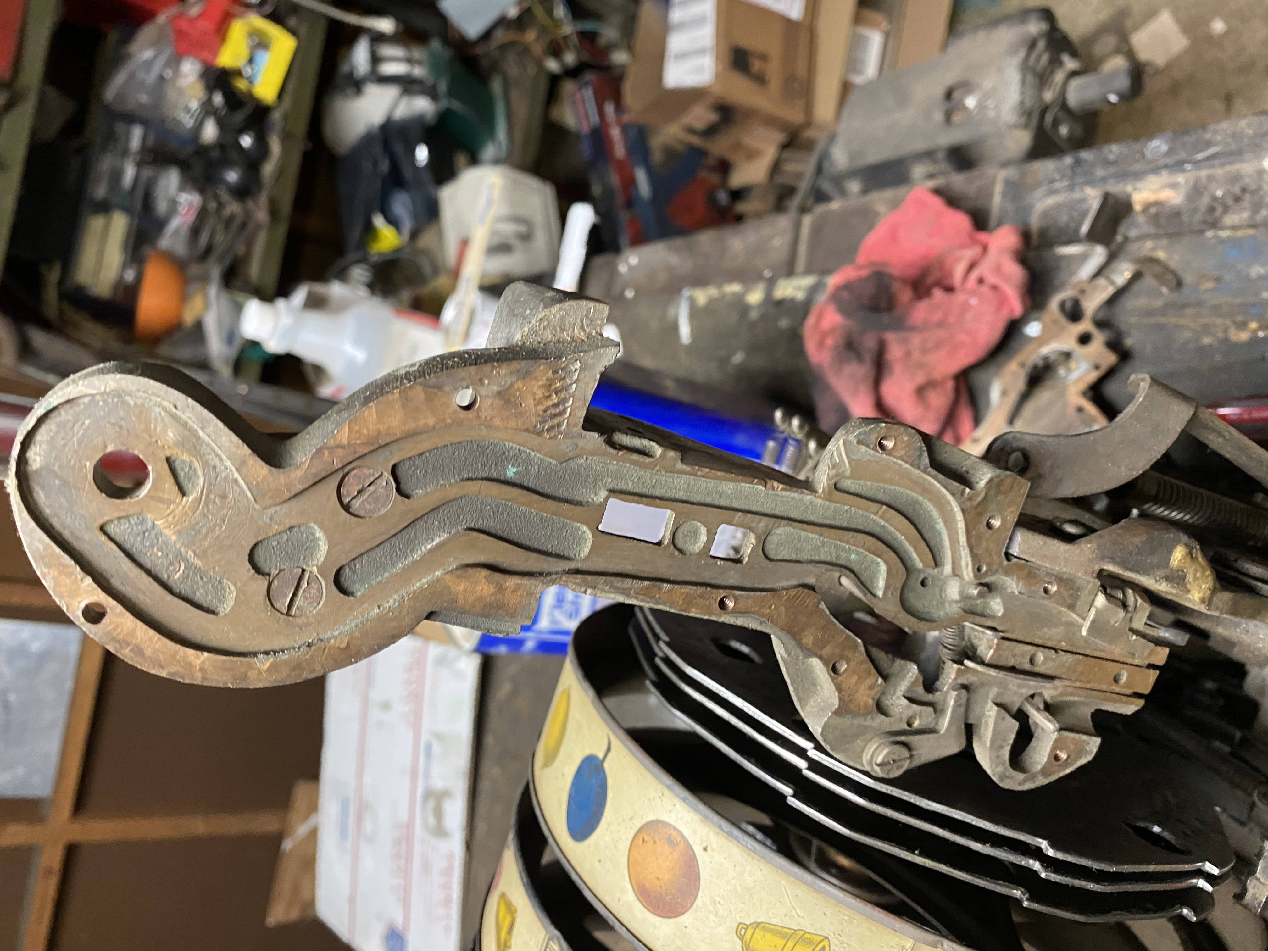

My other problem was making the jackpot part work. I thought I needed some piece that mounted on the front of the cabinet. Turns out when I tool out the coin tube I found this odd cast brass part that goes on top the wire from the jackpot slide. So I found the solution to that problem. I believe there is a special coin diverter that mounts to the casting at the top of the coin tube. One ear of this casting (I believe it to be a better quality pot metal) is broken. I am going to make a bracket and fix this issue.
Eventually I will want to rebuild this mech. My goal is to not fully restore it, but to mechanically get it back and leave the patina. One side wood is split and the base wood is split. I believe I can glue and clamp them back.

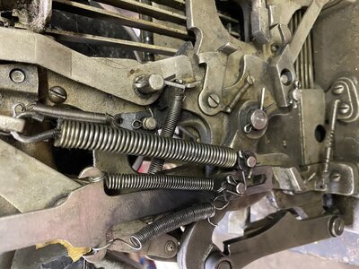

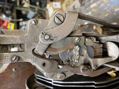

So first I need to properly identify the mech and then get what ever documentation that allows me to figure the correct set of springs I will need to replace them. Also some of the parts are very worn like the pawl that yanks the reels to start them spinning. I need to know which parts are wise to replace. Some parts do not seem to do much.
What book will show me all the parts of this machine? There is a Mills pdf I have been directed to from the Facebook slot group, but that is for a newer mech and nothing matches.

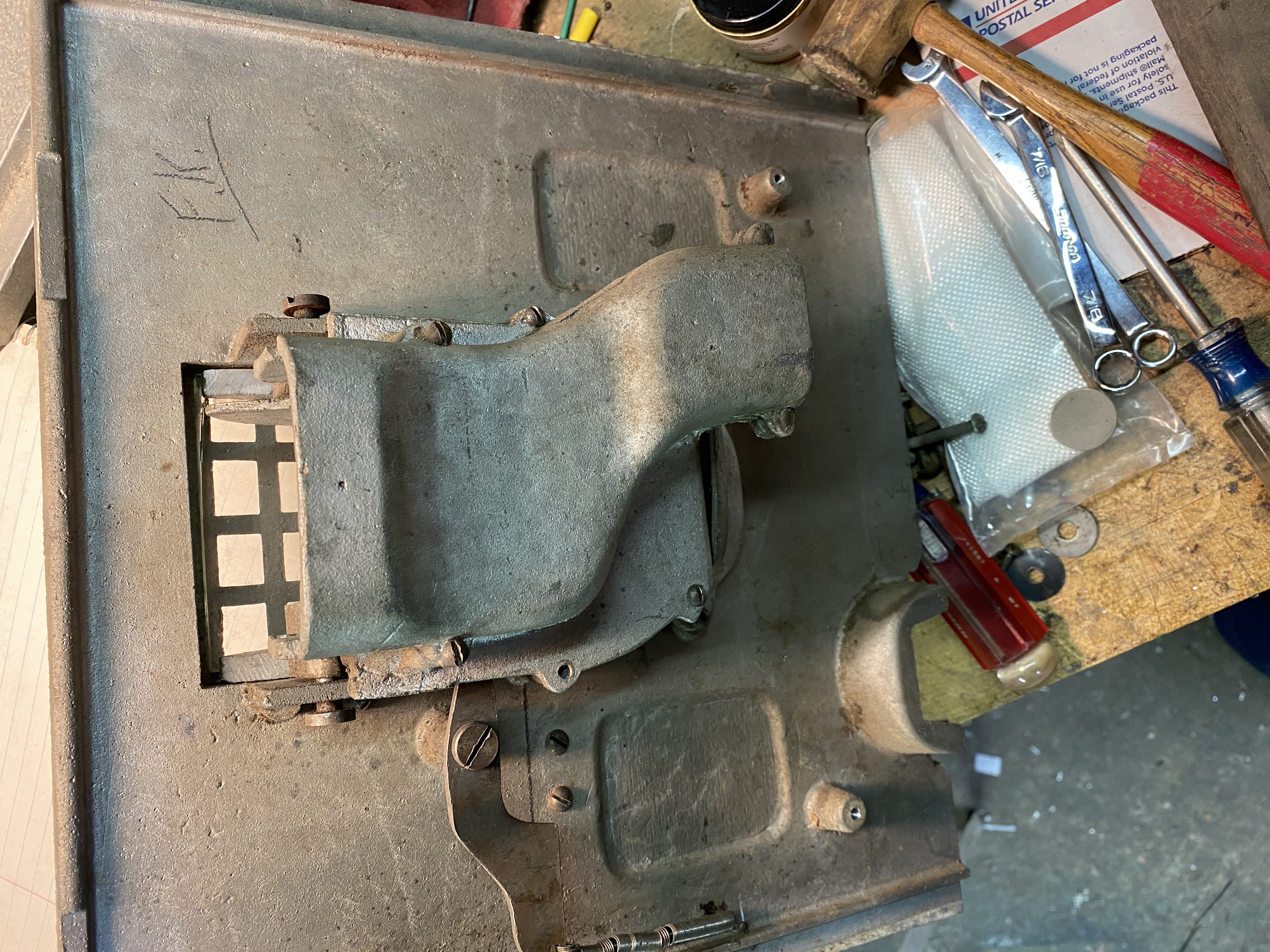

Where are the best places to get parts? Among many things, I need to fix the back cabinet lock, might just need a key. I need the cover that goes behind the neck. There are some pieces in the neck that are made up and I might need most of a neck.

I made a bracket to hold the jackpot diverter and got a slightly larger metric screw to hole the top of the tube to the frame.
