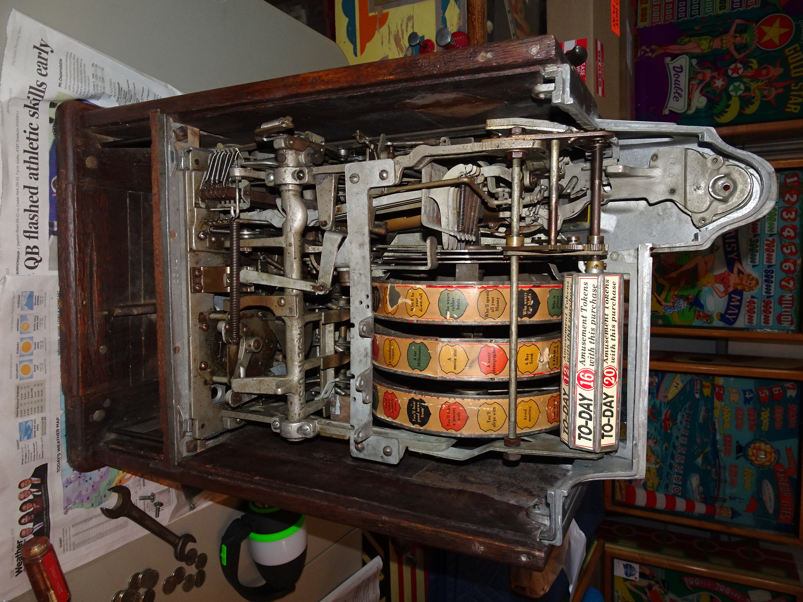

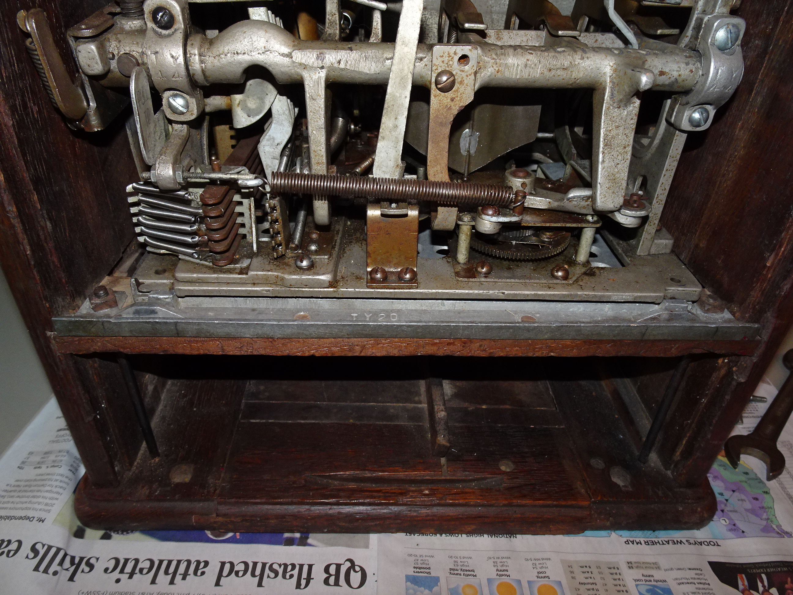

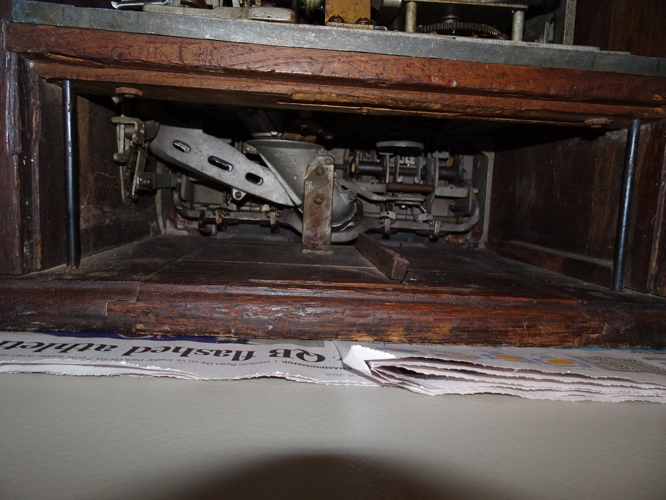

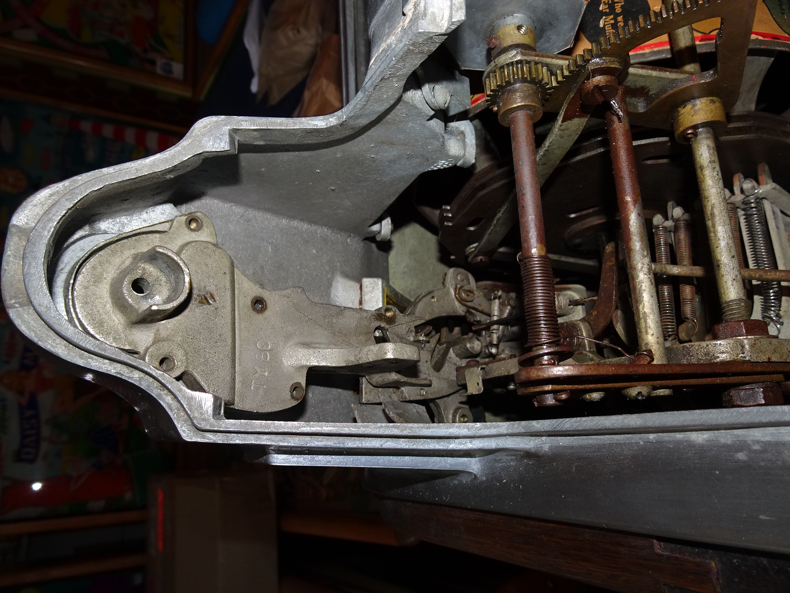

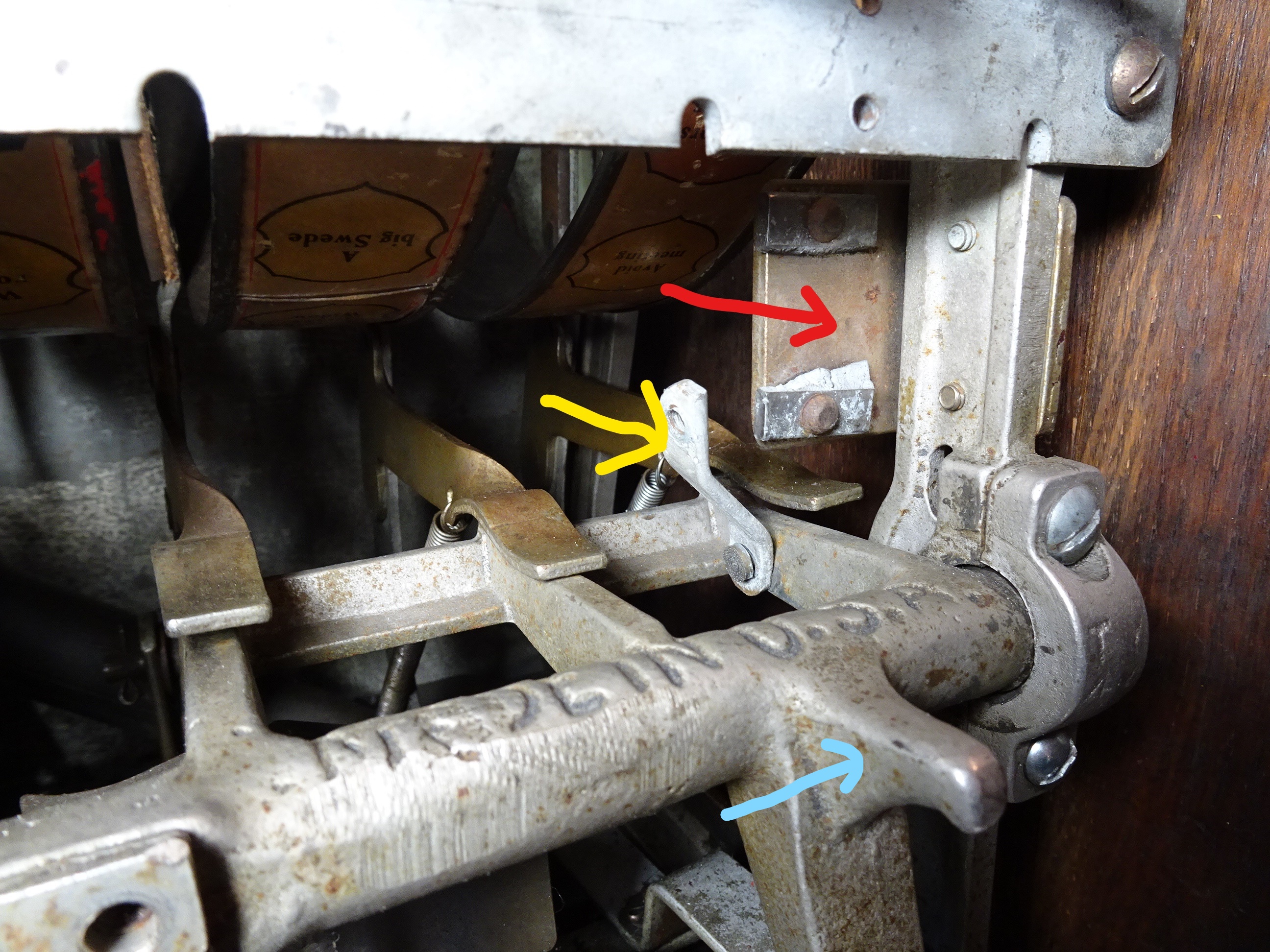

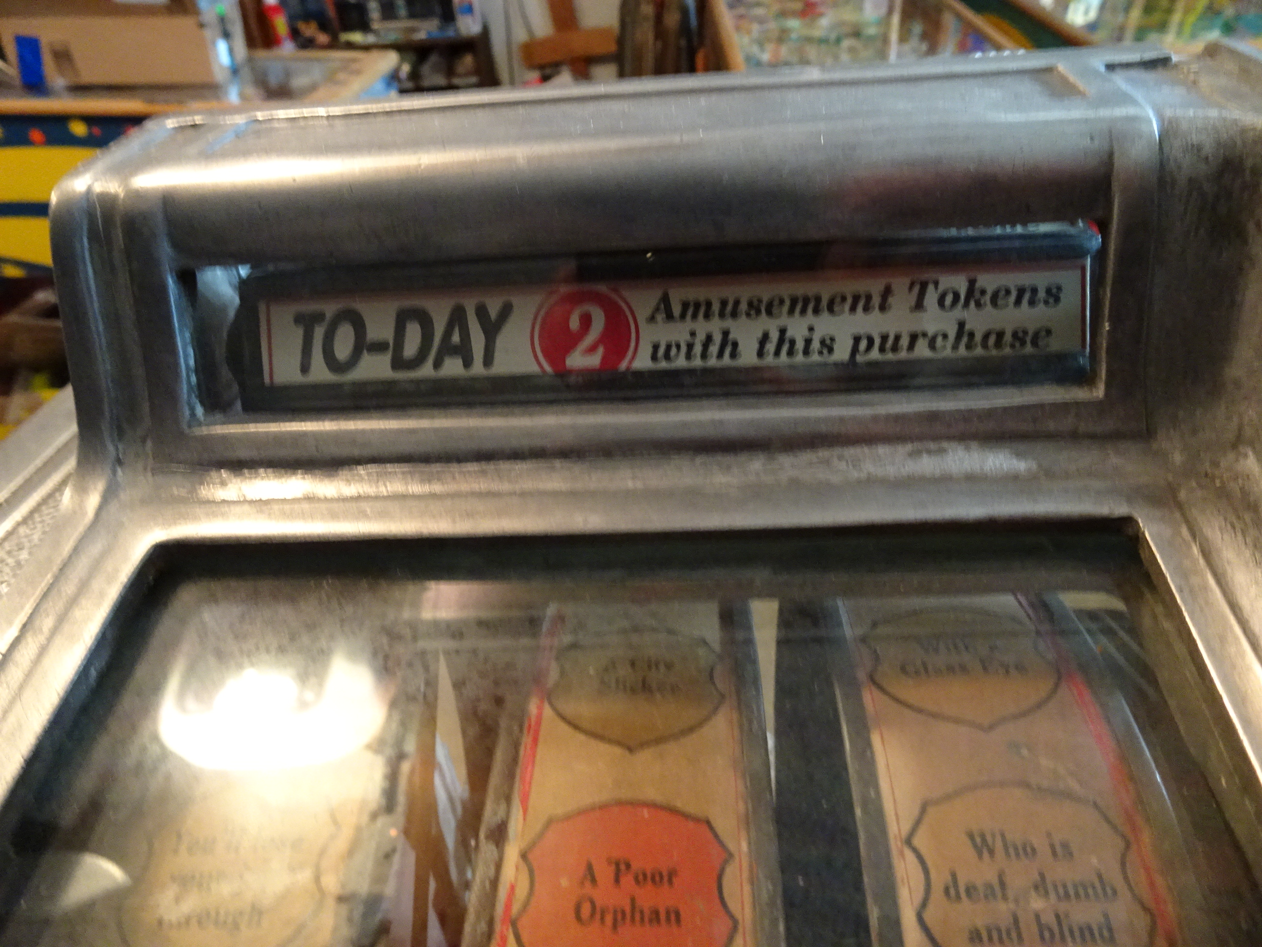

Postby WoodrailFanatic » Thu Jan 28, 2021 11:03 am
oldslotman,
Not sure what you want to see pictures of so here are several that I hope will help. If you need others please let me know.
One note....the machine is consistently showing a 2 coin win (see pic) when it should be showing the label on the drum suggesting you buy confections today. Could this be the issue? Any chance that because this unit is not resetting to its proper home something is engaged with the mech?
In one photo with the colored arrows....the red arrow is pointing to a plate that has a missing middle section broken out of it. The yellow arrow is pointing to a lever that is loose and should obviously be attached to something. The Blue arrow is pointing to a big finger on the main crank that I think is missing a large spring that attaches above on the bracket that holds the reel brake apparatus. I am making this "missing spring" assessment based on photos of a restored version of this same machine that is listed on eBay right now.
Also I will ask again....could the mint vendor be doing this?
Thanks for your help....much appreciated.

Postby oldslotman » Thu Jan 28, 2021 3:02 pm
I believe your problem maybe with the mech not resetting like you said. Something is likely still engaged and not allowing the removal of the mech.

Postby WoodrailFanatic » Sun Jan 31, 2021 8:57 pm
oldslotman,
I have looked and studied but cannot see where the mech has not completed its cycle. All three reel stops are fully engaged. The top payout fingers are all in contact with or protruding through the payout disks. The handle has returned to home position.
What could I be missing? The escalator? And again I will ask....could it be the mint vendor mechanism as I have zero experience with these.
