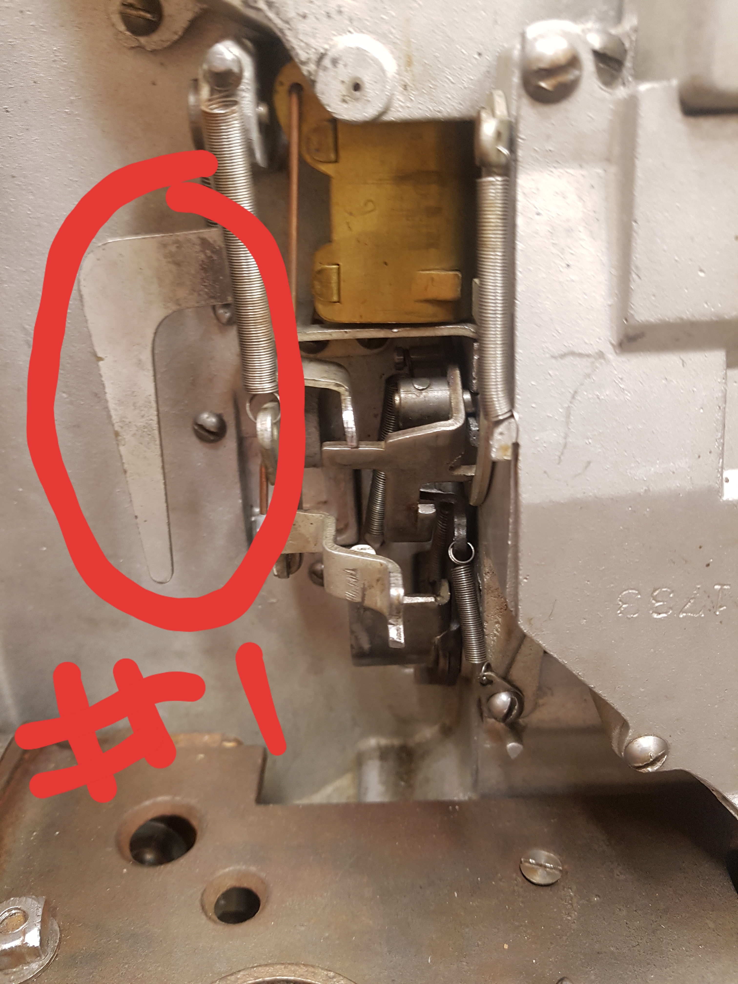

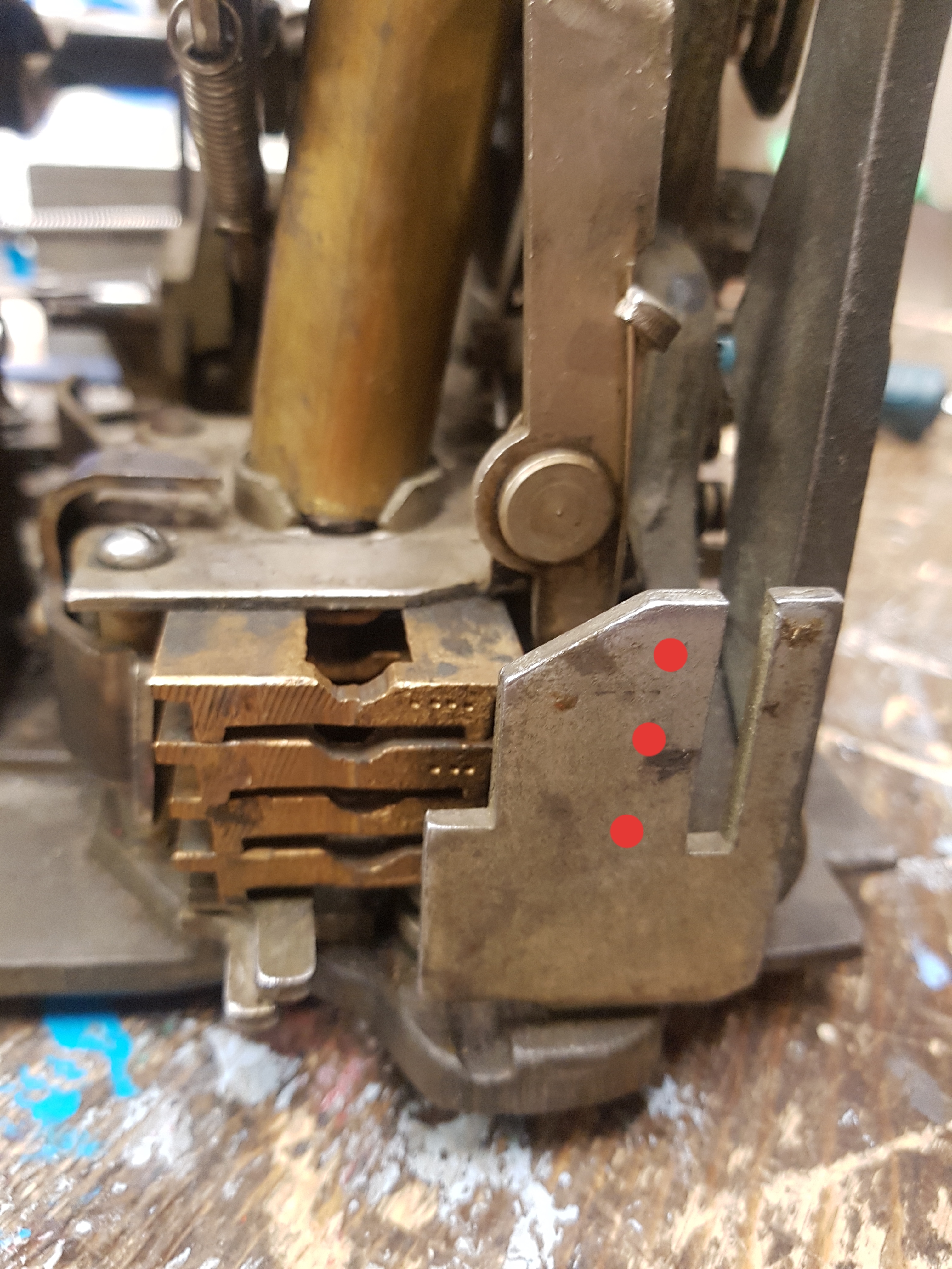

Hello all,
I am lost on how the jackpot is tripped on my poinsettia. The lever labelled #1 will dump the jackpot when the mech is out, but with the mech in, the lever rests against the mech (spot with 3 red dots).
I can not see what pushes this lever to dump the jackpot. Even with the top casting off, nothing comes to mind. I have also included a picture with the mech installed. The jackpot dump lever is the red dot, and where it meets the mechanism is the green dot.
I appreciate the help!!
Brian

Hi,
I guess the question I have is will it dump the Jackpot with the mechanism in the cabinet? (Is there an obstruction?)
Align the wheels with the mechanism inside the cabinet for a payoff by holding the fan blade in-between reels while you align things us.
(Guessing you already know how to do this)
If it does the payout, do ya really care how it does it?

That lever does not trip the jackpot. The jackpot works off of the top slide. Nothing pushes that lever to dump the jackpot.

My machine does dump with the mechanisim in the machine if done manually. But if I line up the reels to pay a jackpot, it will only do the 20 nickel payout and not dump the jackpot.
Oldslotman- thank you for the reply, I will further investigate on how the top slide makes the jackpot dump

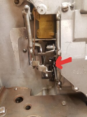

Postby Briandhyde » Wed Mar 17, 2021 2:06 pm
I have the issue solved now, I was fixated on the lever being the trip for the jackpot.
The piece on the jackpot (red arrow) was installed wrong and not releasing the jackpot when the top slide moved in. Once i switched it around to the correct position, it works like a charm.
Thank you again guys and to Oldslotman for getting me into a new train of thought!

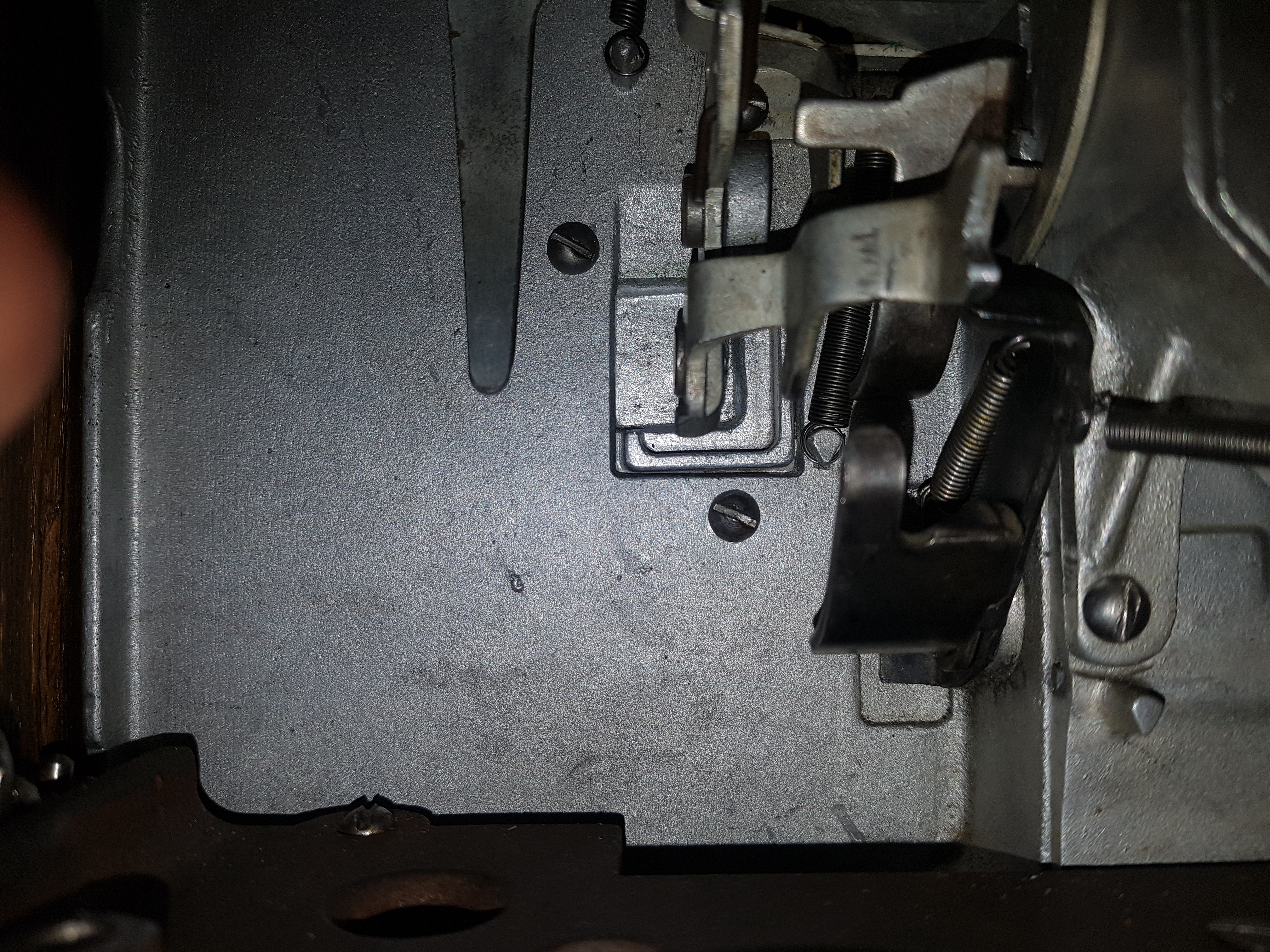

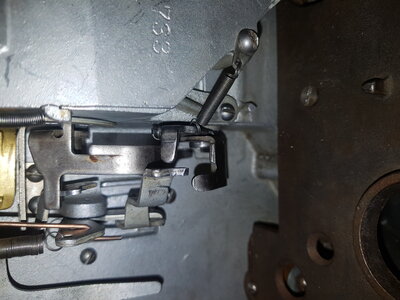

Postby jumpinjaxsisfun » Wed Mar 17, 2021 3:25 pm
Will, can you send better pictures of the jackpot mech. Like close up of all parts. I have the same problem and was told the book wont help as close up. NEED them BAD... Please help if you can Iv been working on this for a long time now. This may do it. Thanks so much in advance. Vin

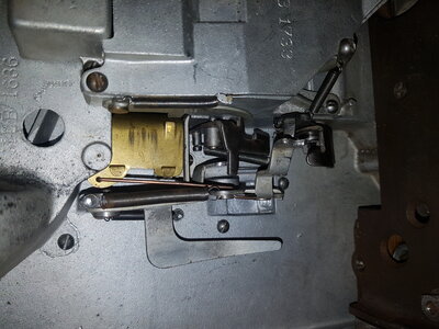

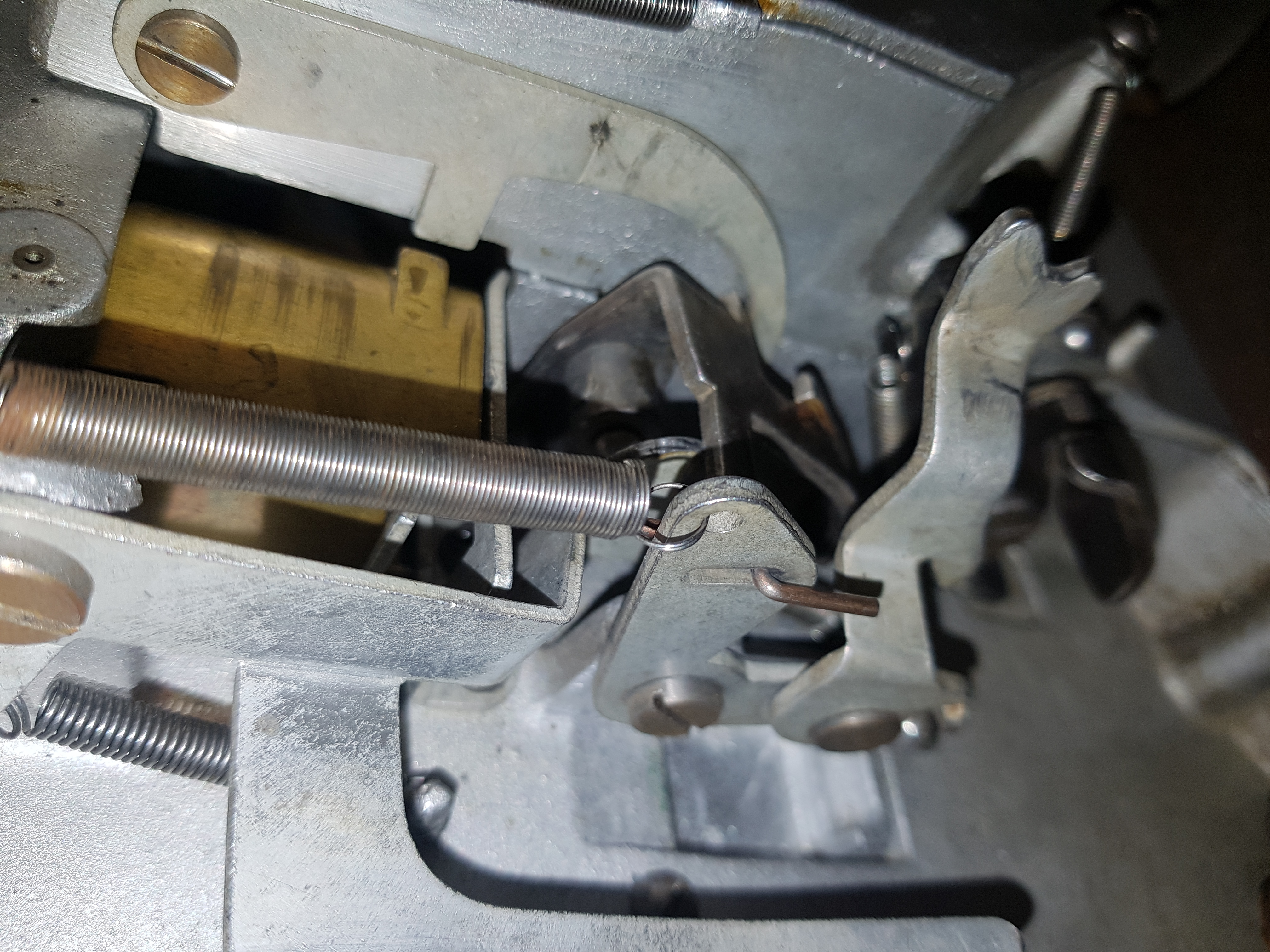

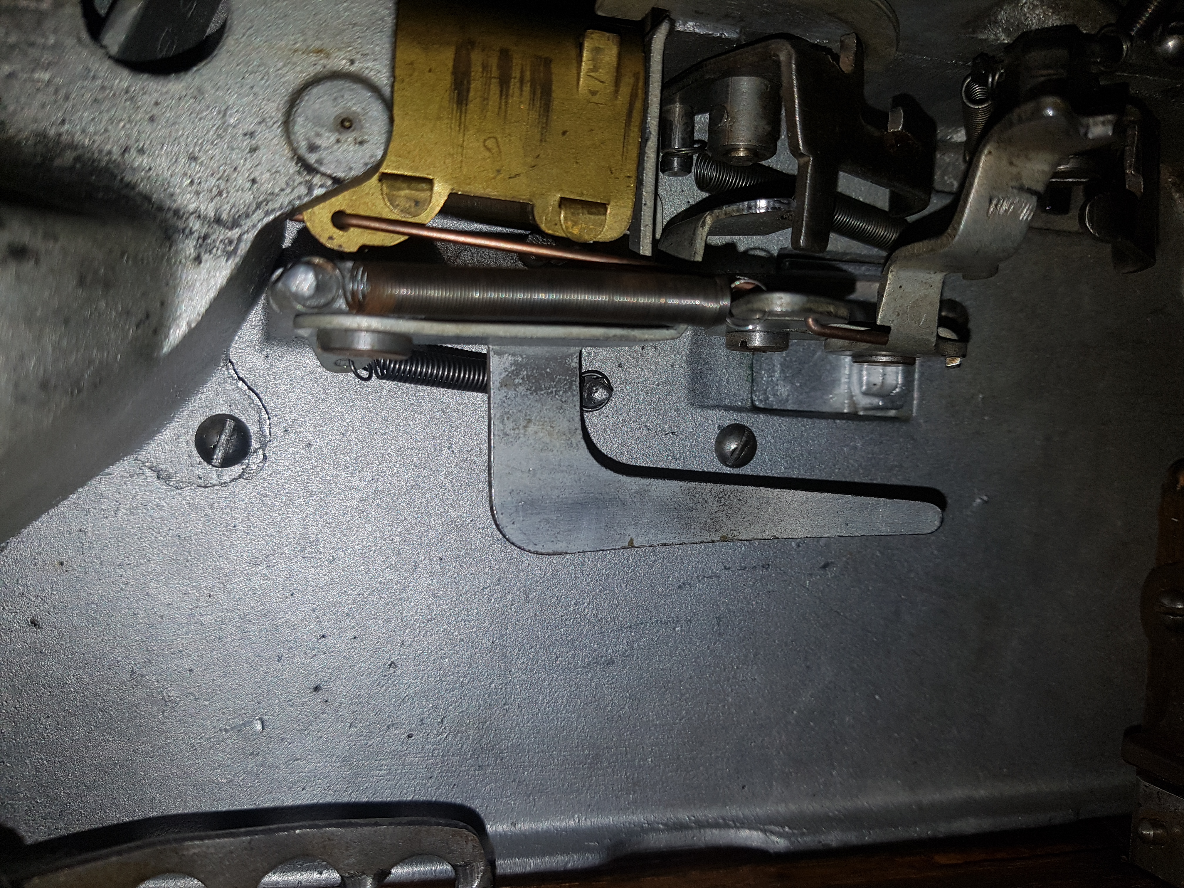

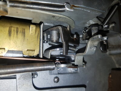

Postby Briandhyde » Wed Mar 17, 2021 5:22 pm
Hope these help with any jackpot issues you are having
Briandhyde
Posts: 6
Joined: Tue Nov 17, 2020 6:39 pm
Re: Poinsettia jackpot trip lever
Postby jumpinjaxsisfun » Wed Mar 17, 2021 8:12 pm
Thank You B&H, I'm on it. shots are great. The best pictures so far. Indeed will help. Let you know how I make out. Vin
