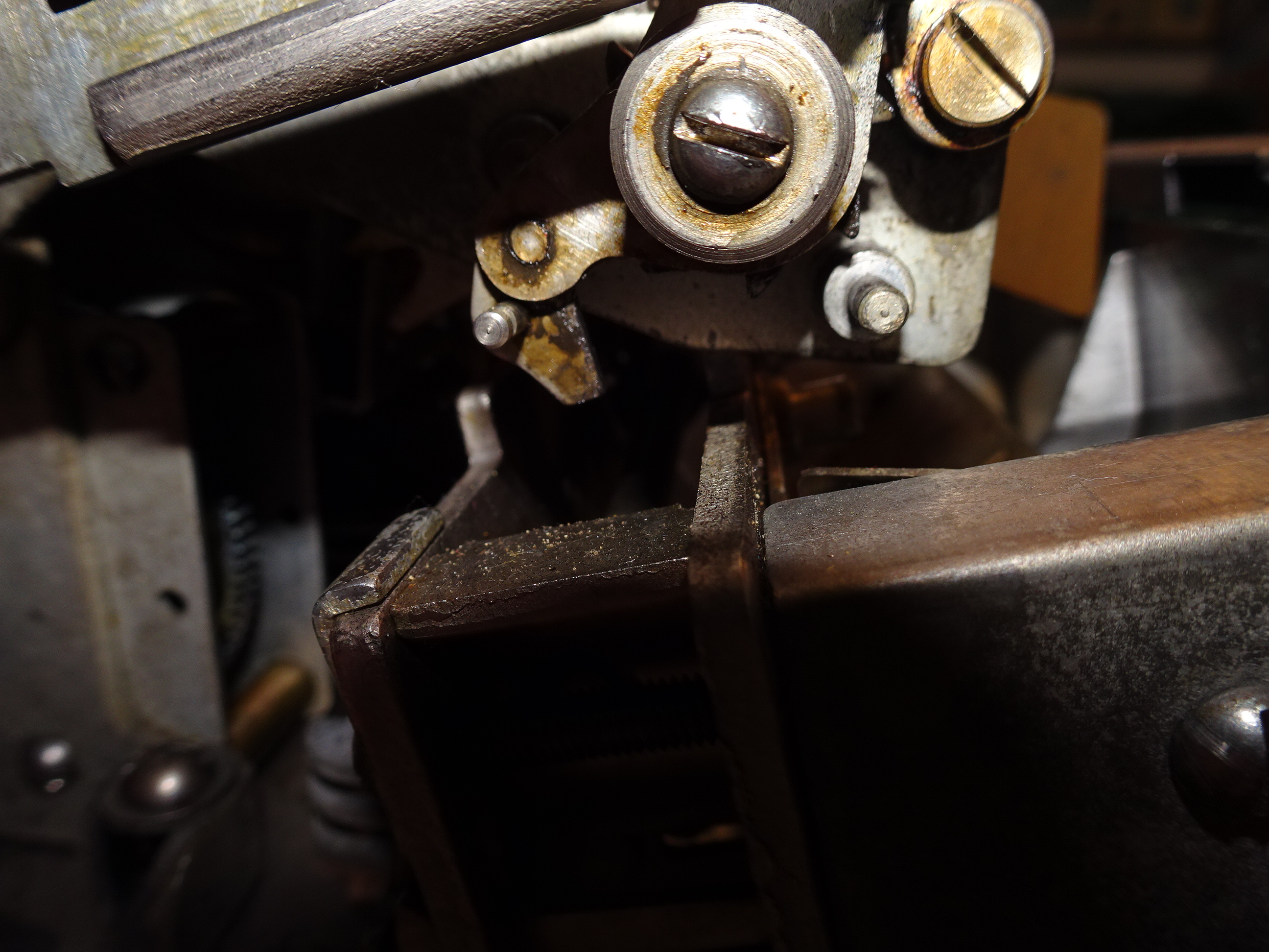

It should alternate and it could be a few issues. Underneath the copper chute there is a small lever that needs to be behind the small flap (as pictured). Also the left side ratchet might me missing a spring. Sometimes the two rods in that area are frozen as well. A picture would help.

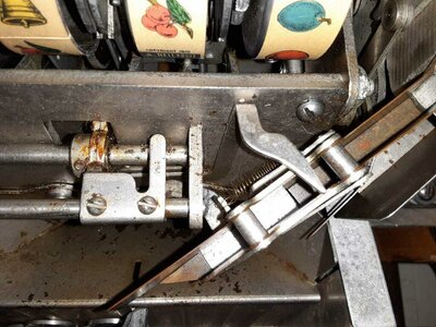

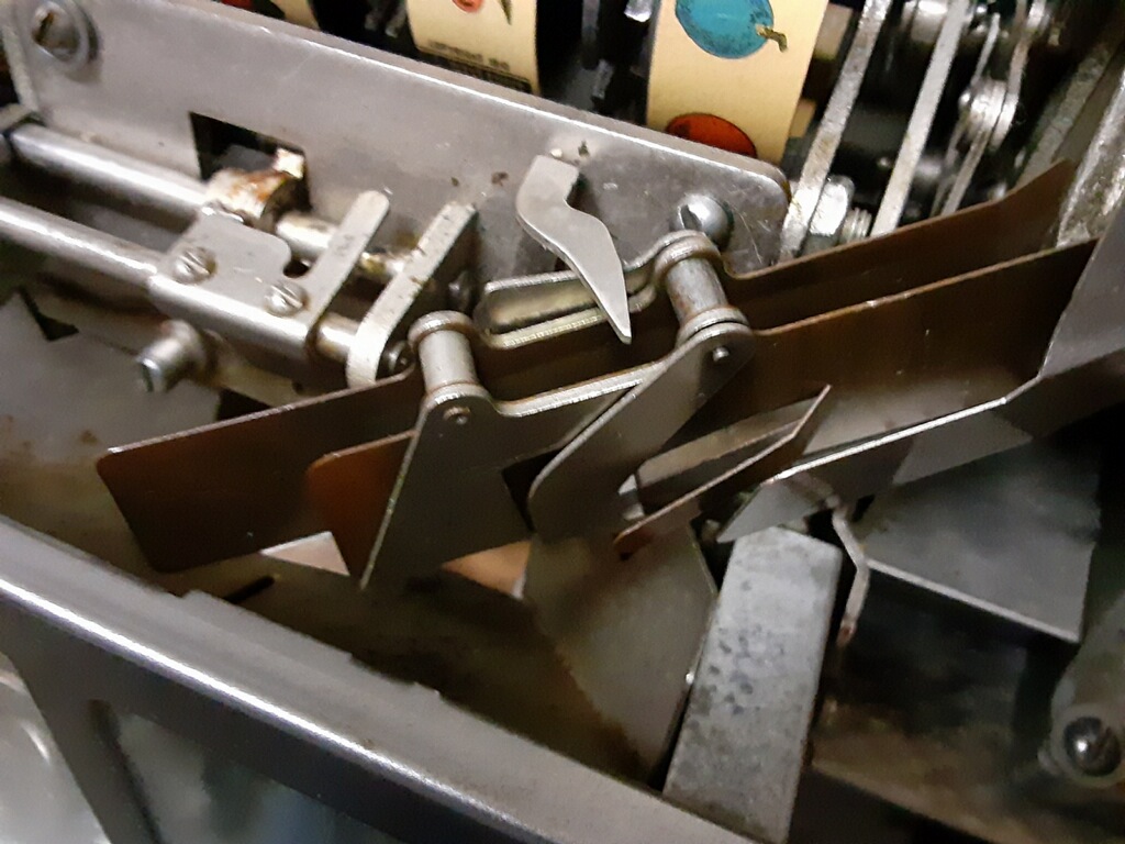

Are you saying that the element that rides on those two long rods to the left should be moving back and forth? I am seeing no movement of it when the machine is cycled.....and the chute does not make any lateral movement at all.
Here are some photos....

The cam (with the old grease in the center) should rotate and that in turn cause the flap that interacts with the coin chute to shift. That causes the chute to move slightly left and right to fill the jackpots. That operation relies on the ratchet mechanism on the far left on each pull. Take a picture of the left front when you have a minute.

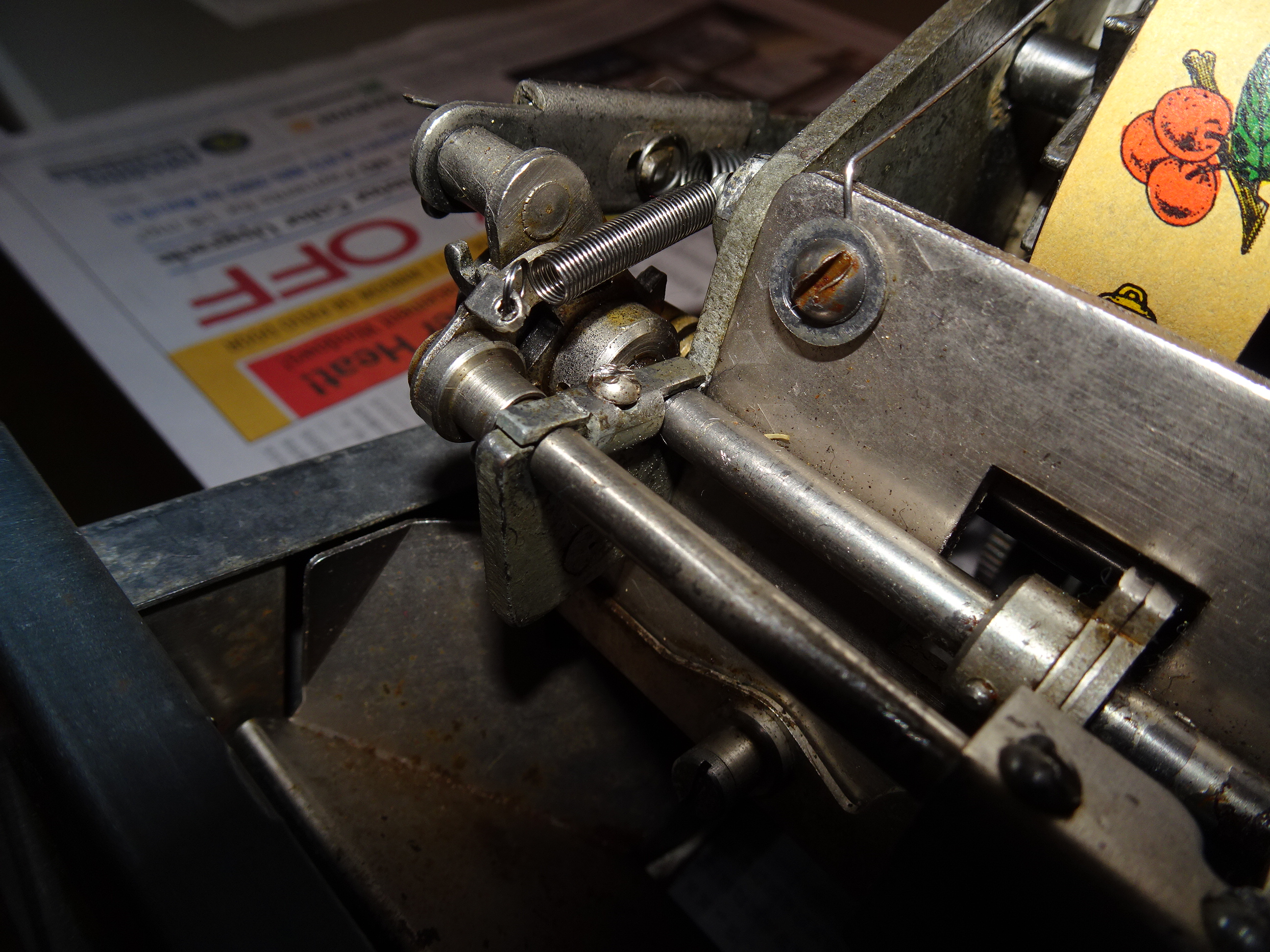

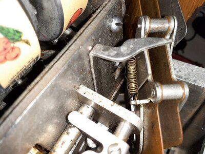

Ah, thank you....you have pointed me exactly where I needed to be looking to better understand things. I can rotate that cam on the rod with my finger....and that does articulate the chute as it should. It is not rotating when the mech cycles.
And I think you hit the nail on the head when you said that I might be missing a spring...a couple of photos attached. I assume on the first one that there should be a spring running from the stud on the left to the one on the right?

Yes, that spring is missing on the underside. I'm away for a bit so I can't send a pic. I may have an extra spring in my QT parts stash also. Also the top spring looks incorrect. Will keep you posted.
