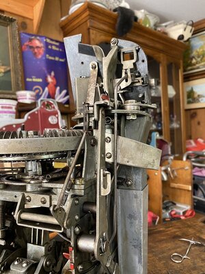

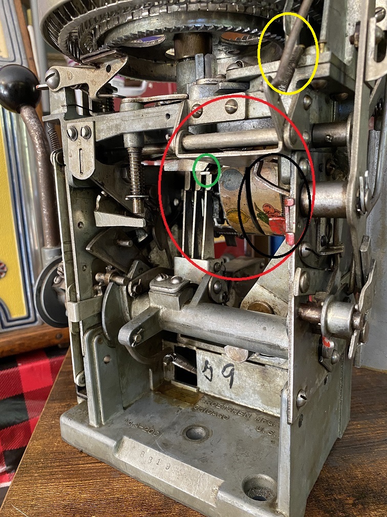

Here are some pictures. The pic with the circles outline a part that I have no idea what it is for, except for the fact that the rod with the yellow circle, goes up to the coin head. Like it's some kind of adjustable lockout, but the part itself is not even directly connected to the main cross cam.

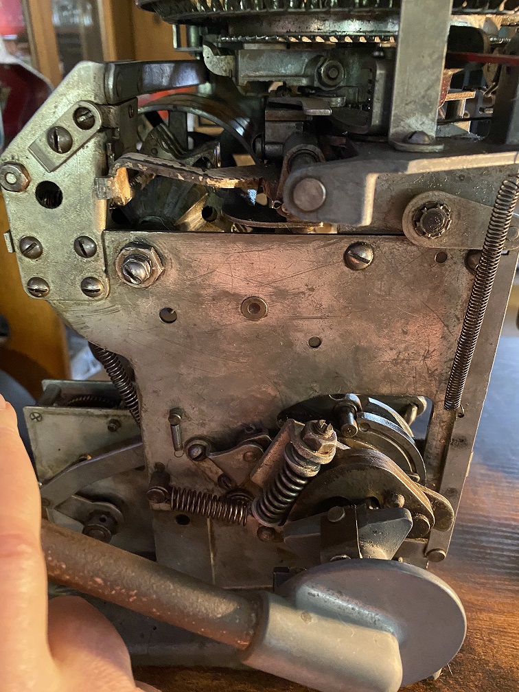

Maybe you're responding to someone else's PM or something, but the ball-joint to the payout plunger return arm isn't the part I was talking about. Look for the bronze rod attached to the kicker, that goes back diagonally to engage a notch in the handle gear. What I see in one of your pictures is a lot of ruts and grooves on the inside of the frame where that bronze conrod & kicker assembly has been reaming out the metal as it scrapes against it over and over; I think just a few more burrs in the way could kill its function cold. I recall also that the little screws which hold the kicker front-stop plate to the frame can thread in so far as to project to the inside of the frame and hit the conrod/kicker as it swings forward, also stopping the handle cold: the four screws are of slightly different lengths, and having one in the wrong location can interfere with the kicker.

1) Bronze rod and kicker assembly move freely. No obstructions, no burrs, metal is not really reamed out, those are just some "grease trails."
2) I even disengaged the A-23 Reel Spinner Arm Push Rod (bronze conrod), off the notch on the outside of the arm, handle goes full stroke to the bottom bumper, so, it's not something on the handle side of the mech.
3) Reel stops fingers move freely. I'm able to pull them back with my fingers, about an inch. Further than that, I'm up against the A-212 Main Cross Cam, which of course, is not completing it's stroke.
4) Linkage on the right side of the A-121 Main Cross Cam is also free to move (as far as Cross Cam will let them), no obvious choke points, levers and rods going up to coin head are not seized in any way.

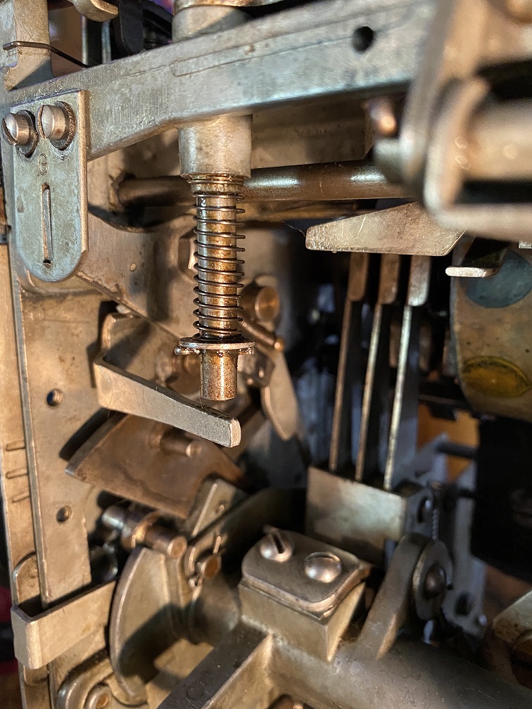

5) At this point, you would think that some of that linkage above the left side of the A-212 Main Cross Cam (picture one below) is preventing the full cycle, but the A-204 Cam on Part A-212, A-92 Lift Dog, A-88 Trip Arm Bracket and the lever (spring loaded), that pushes up the A-79 Dog Lift Stem (going to the carousel), all this linkages move like the should, springs are correct.
I still cant see what's keeping the A-212 Main Cross Cam from completing it's stroke.
