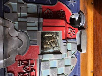

Postby lilmac55 » Fri Dec 24, 2021 10:07 am
If you are talking about the coins in the glass towards the bottom, I had to open the area and add the coins. To my knowledge the coins must be placed manually. Theses coins are not part of the jack pot they are just display.

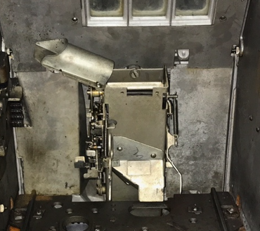

Postby Shane » Sat Dec 25, 2021 12:17 am
Here is an example of a complete jackpot mechanism...

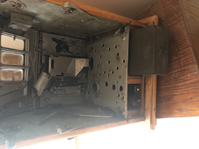

Postby lilmac55 » Sat Dec 25, 2021 10:07 am
The brass tube fills with coins to be paid out. The fingers at the bottom of the pay out tube determine how many coins drop. When the tube is full they drop to the cash box though the chrome slide down to the cash box. Pictured on the bottom right. The display window is behind the coin box slide. It must be removed to add or remove coins from the display. You will note my machine is missing the coin management system on the left of the cash box slide. It works fine with out it just means the tube is filled again before any money goes to the cash box.

Postby Shane » Sat Dec 25, 2021 11:38 am
Compare your jackpot mech to the one I posted. Yours is missing the springs and levers on the sides that control the coin flow. It appears you just have the shell of the jackpot mech with no internal components so the coins avoid the jackpot and reserve jackpot and flow direct to the cash box.
