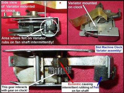

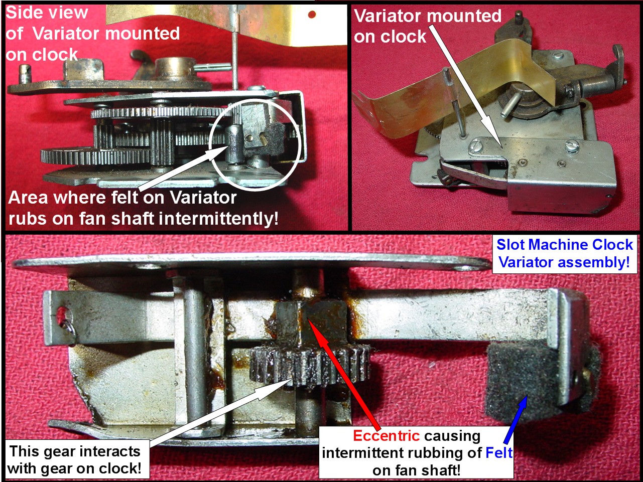

Interesting way to watch payouts and maintain your Bally's, you must suffer from OCD like I do! :lol:
As to them repeating themselves, all reel slot machines, mechanical and early electronic, due to the spinning cycle of the reels "Repeat" themselves with some consistancy, even with variators in the E/M slots, clock timing and reel mech installed, the spin of the reels have their own cycles, controlled by length of time for first reel locks up, second reel lock up and third reel lock up, Etc. The time between these reel lock ups, even with variators installed as the variators have their on set cycle if working properly somewhat control the time between payouts with minor variations and facilitate the "House Percentage", Charles Fey when he invented the first three reel slot machine in the late 1800's and early 1900's I believe was aware of these cycles!
House percentages were also controlled by the reel strip configuration as well which is well known, very interesting if you think about it!
And that doesn't even take into consideration the "Bugs" some casinos used on their slot machines along with "Patching" reel strips or pulling the fans off of the clocks to have it run out faster so as to lengthen the cycle between payouts, especially Jackpots by having the reels lock up quicker shortening the timed reel lockup cycle!
Thanks for your comment!
Bona Fortuna!
SAMPLE OF AN EARLY MECHANICAL SLOT CLOCK VARIATOR

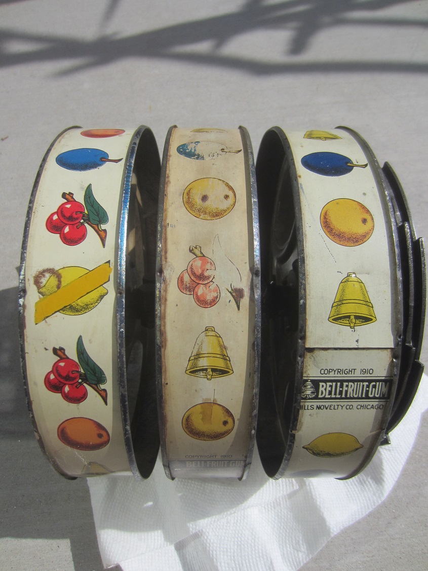

wow Monti they were not kidding when they say the HOUSE always win with all those tricks up their sleeves! Is that felt only used on the EM slot clock variators or on the Mills, Jenning machines also? Does this 10 stop reel look like it was patched at some point in its life?

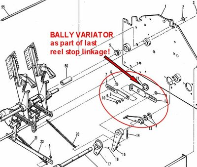

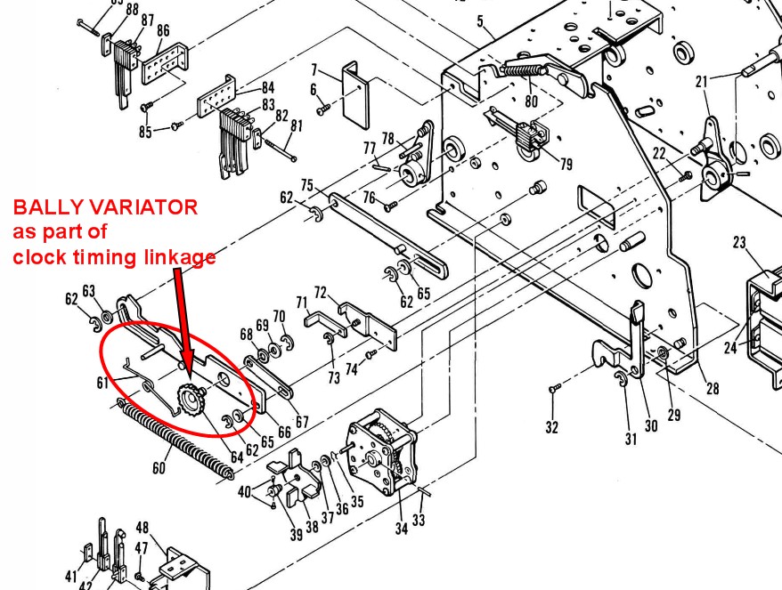

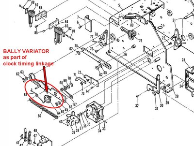

Bill!
The clock variator shown in the previous post was one used on the mechanical slots, Mills, Jennings, Pace, Etc.
The ones shown below were used on the Bally's on the reel mech assembly as shown below as part of the clock timing action and also the last reel stop timing!
As for the reel strips you show the difference in aging of the strips shows changes were made at some point!

Hard to tell whether your reel bundle has been patched from one picture. Looks like a nice well used original with the Free Play lemon symbol gone. Probably removed the free play finger on the mech as many operators did to improve profit.
