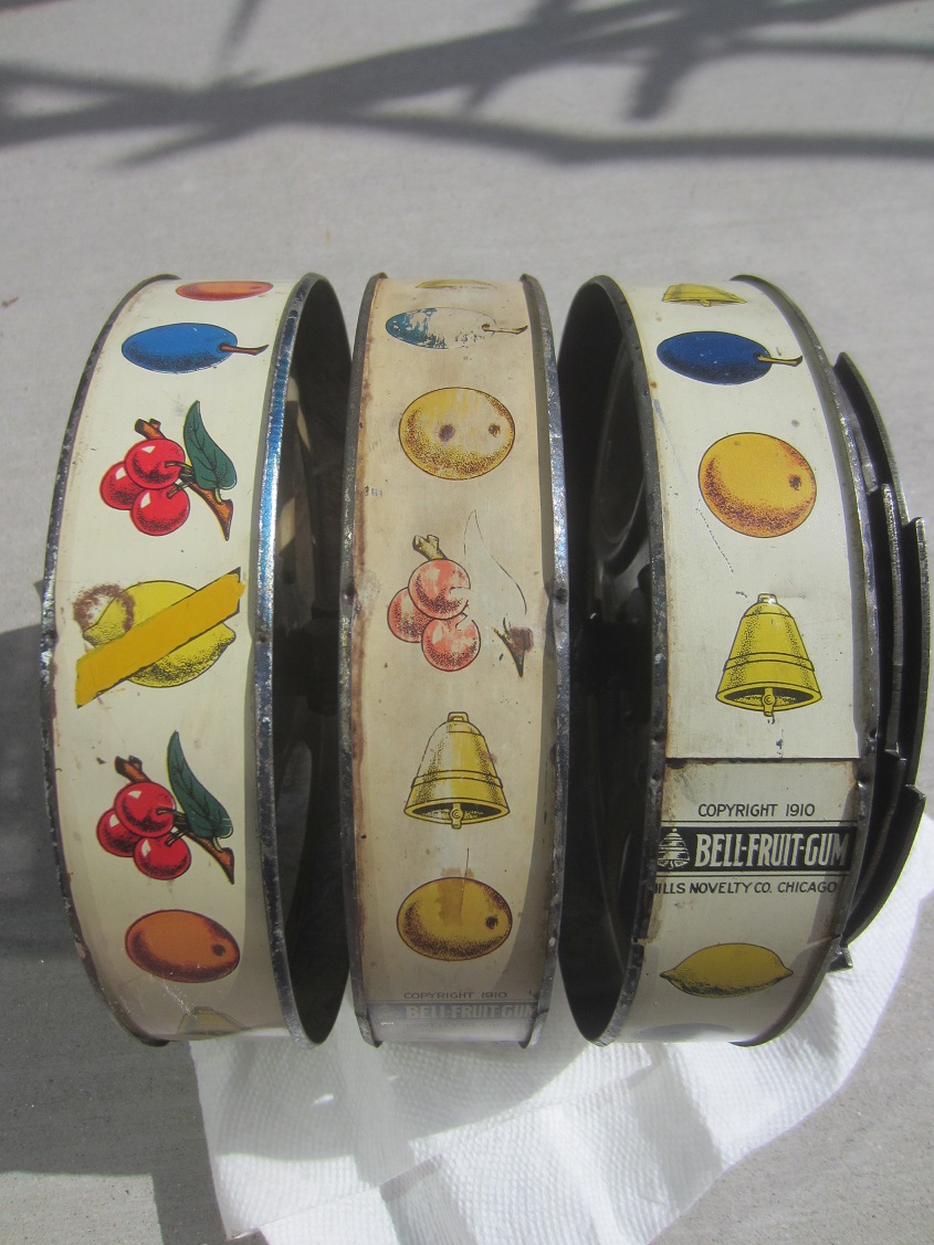

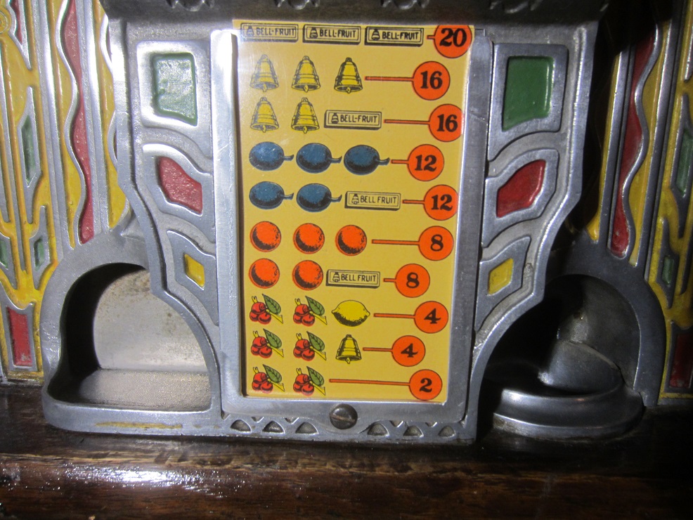

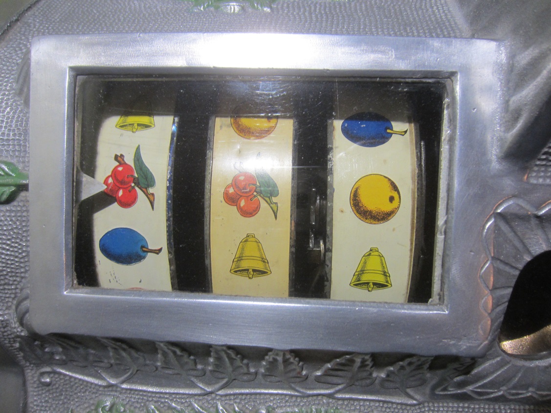

Hello All, I want to replace the reel strips on this modified Mills/Pace machine but some and not all of the payouts are off by one symbol. I "am not sure but the symbols for the 10 stop reels seem like the reel strip symbols is for a 20 stop mechanism? Not sure on this subject but i included a picture of a win of 4 coins with the symbol of Cherry/Cherry/Orange but think it should be a Bell. Thank you Bill
20 symbols per reel with #1 starting from left side
#1 Reel=(2) Lemon (5) Cherry (4) Orange (3) Plum (4) Bells (2) Bell/Fruit
#2 Reel=(0) Lemon (5) Cherry (5) Orange (3) Plum (5) Bells (2) Bell/Fruit
#3 Reel=(3) Lemon (0) Cherry (5) Orange (5) Plum (4) Bells (3) Bell/Fruit

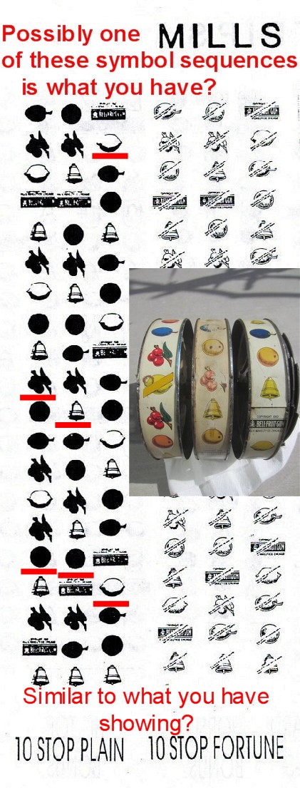

This portion of the RICK FRINK Reel Strip Catalog may help you and you can contact him for ordering the reel strips!
He is and has been for many years the go to guy for reel strips since the late 70's early 80's!
The reel sequence or the order of the symbols on each reel, which you do not show are very important with every other one only used for payouts in a 10 stop slot machine configuration which I am sure you understand!
Also if the reel strips are carefully removed there should be a number on the bottom of each reel strip designating the usage however it is apparent that what you have is a mixed combination of reel strips or appears to be!

I am assuming from what you have shown on the reels pictured that the reel strip sequence you have is similar to the one below on the left from Rick Frink's Catalog!
And also as Old Slotman stated if you look at every other symbol starting from the Three Bells the Triple Bars could only come up once when aligned accordingly!

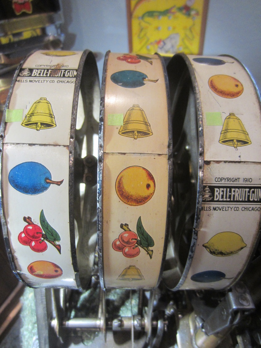

Per oldslotman suggestion I lined up all the 3 bells making sure the payout fingers and reel stops were locked and this is the symbol sequence that I have but I don"t see that on the picture you posted Monti. Should I line up each payout symbol/fingers and mark the reel symbols with tape?

From the latest photo of the reels, strip #2 second reel and strip #3 third reel could be right as they end and start correctly but whats in between in the sequence?
Reel strip 1 seems to be the odd ball!
What you might want to do is write down the symbol sequence of all the reel strips;
Strip #1 starting with Plum, Cherry, Orange -------- fill in the blanks-----------------and ending with BAR, BELL
Strip #2 starting with Orange, Cherry, Bell ---------- fill in the blanks-----------------and ending with Cherry, Plum, Bell
Strip #3 starting with Bell, Lemon, Plum ------------ fill in the blanks---------------- and ending with Plum. Orange, Bell
THEN THE BIG CHALLENGE check the pays against the reel discs as who knows what combination you have there!
I think I explained that right, any expert thoughts out there!

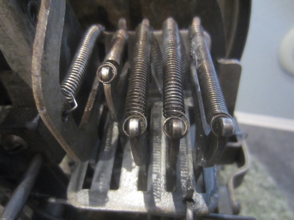

Hi Monti Here is the sequence with filling the blanks using initials of symbols. I confirmed all the winning combinations using green tape on the symbols which corresponded with all the payout fingers going into all 3 reel holes, The Jackpot fingers lined up through the reels but no payout so either the spring is weak or its got the wrong payout slide but that's just a guess on what's going on here...looks like a reel mystery!! appreciate all the feedback so far on this issue-Bill

Why doesn't your first strip start with what appears in the picture of the reel bundle you post on here? As Monti has said about the starting sequence and what appears in the picture, yet you say now that it starts with B/F, Be, CH...... and the picture shows it starts with P, CH, O..... Not sure what the confusion is with this.

Did it payout on the three bells? It looks like in the picture that the payout finger did not go through all three disc.
