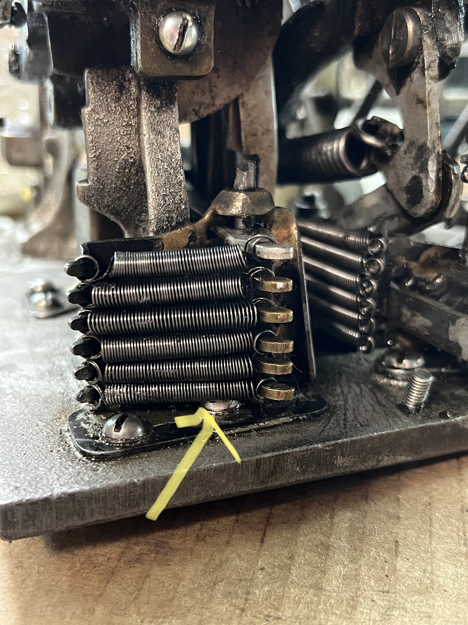

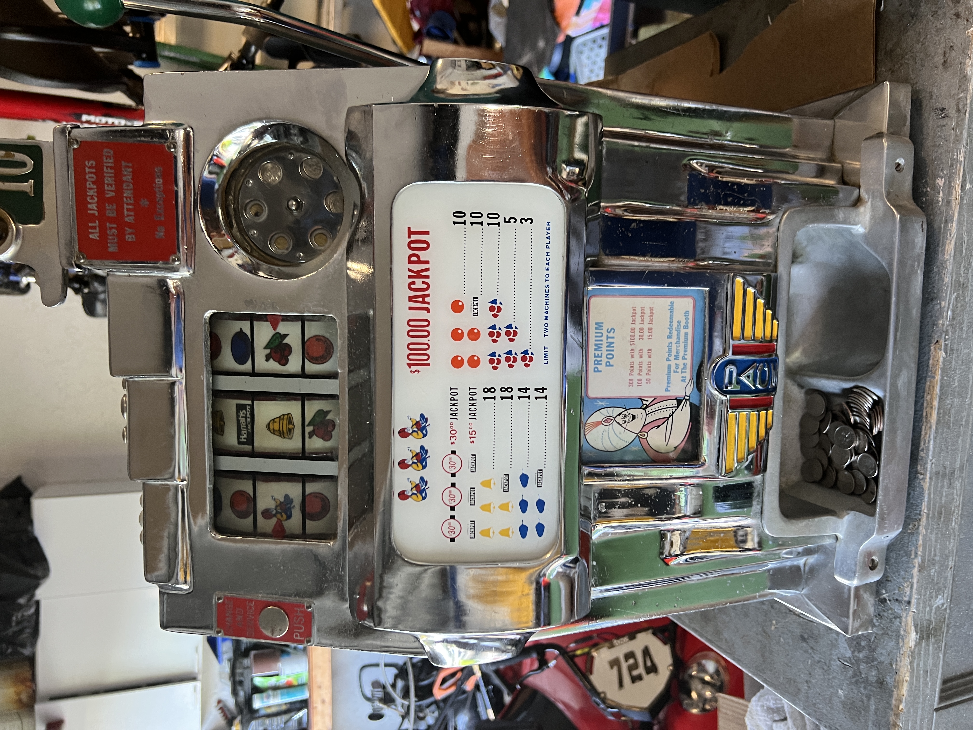

Working on an old pace mechanical.
Got the reels spinning & stopping correctly, and the slides are all cleaned and moving well.
Machine is paying 3 coins for wins that are not on the card.
Most of these non wins are on the left reel. I thought maybe the reel strip had slipped, but this does not explain why it is winning so often. Every 2 or three spins triggers the 3 coin win.
Any clues to what would cause this?
Thanks!

I would suggest checking the spring for the bottom slide (not the safety slide), as well as how that bottom slide lines up with the lower payout finger. The lower payout finger spring may have come off, or the lower payout finger isn't contacting the bottom slide, causing excessive payouts.

Turns out it was a weak spring.
The rebound froM the top fingers indexing the reels caused the 3 coin lever to bounce out, intermittently.
Thanks for the advice, and definitely to Tim Jim.
Great lesson learned!
