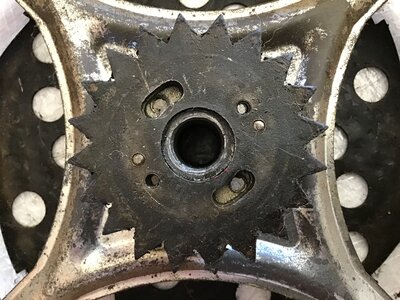

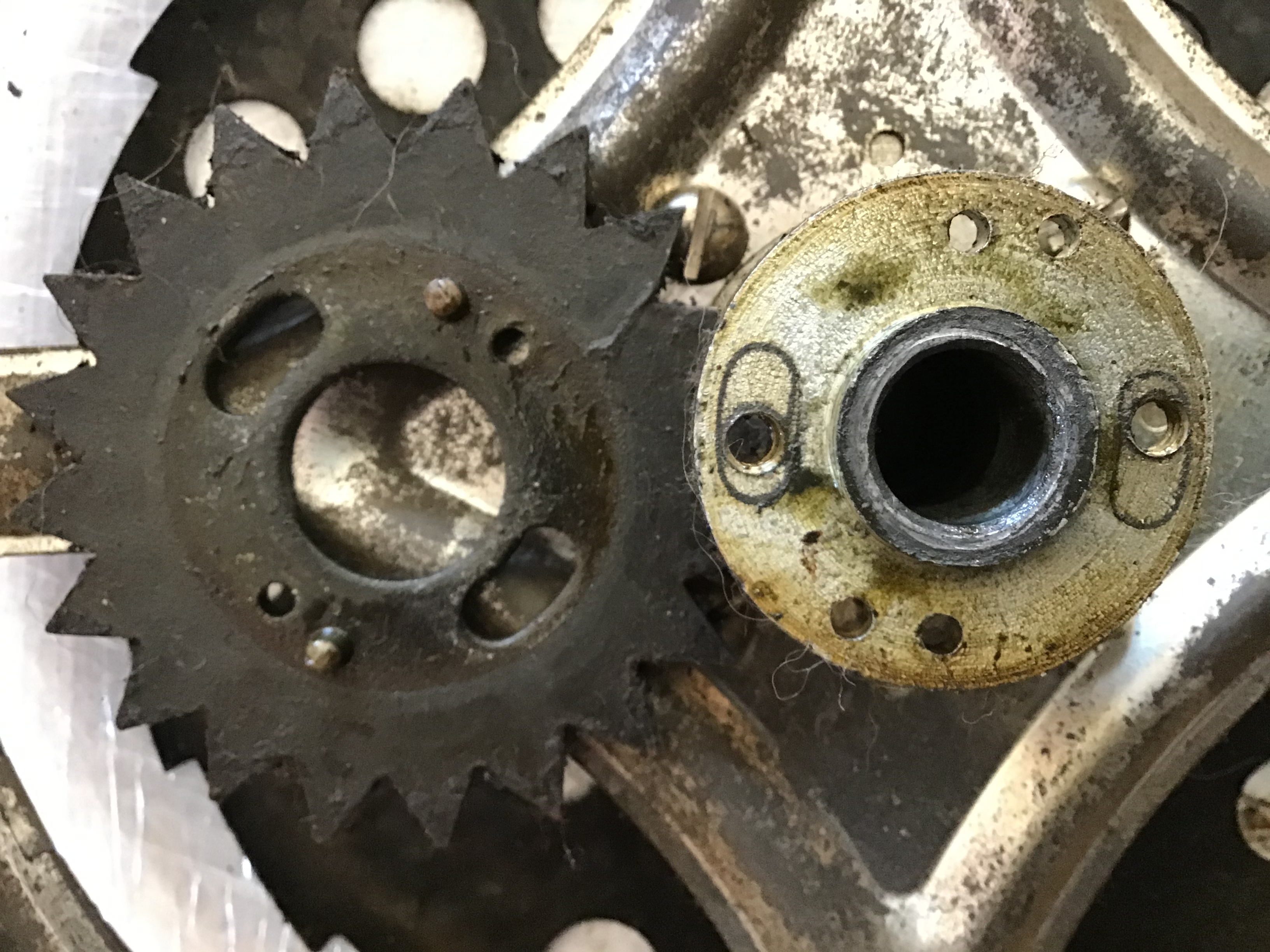

I’m cleaning up a Mills reel, the sprocket is pinned with a couple options. What’s the options to the pin placement? Any difference on how it’s replaced? Here is a couple of pictures hopefully helpful to my questions.

So as to make fine tuning adjustments for the vertical pay finger to align properly and correctly with the holes in the payout disc after the reel stop lever enters the star being shown here to stop the reel on completion of cycle!
Then if the reel tapes/strips symbols do not line up perfectly on the pay-line uncrimping the reel tins and gently rotating the strips on the reel tins to line up if necessary!
I believe Dave Berten still has the crimping tools for doing this task better than using a screwdriver to un-crimp the tin and lone nose pliers or some other tool to crimp!

Thank you Monti, I ended up using the same pin holes that it originally was. Now I need to figure out which reel strips I need to get for it. The new ones I got were not the correct ones. Going through a big learning curve right now. Hope to get it together sooner or later.
