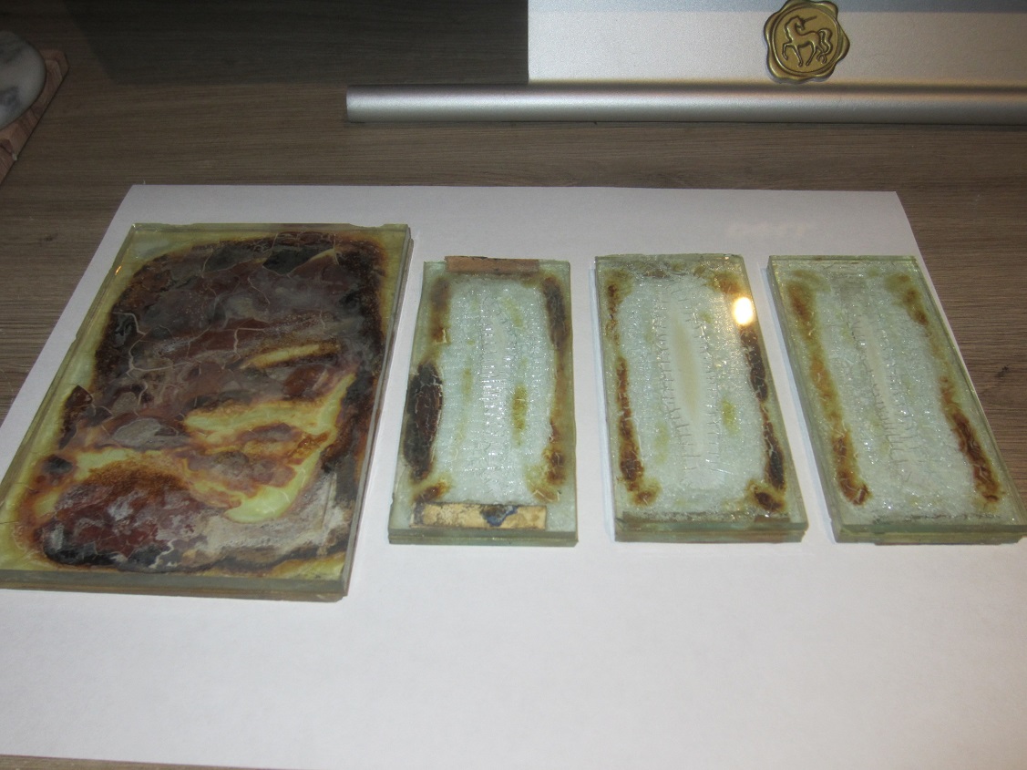

Hello All, I was looking for any suggestions on saving the reel and jackpot glass from my 5 cent Mills castle. They appear to be older replacement glass since they are glued together to make the correct thickness. I was going to submerge them in vinegar or alcohol but thought I would see if anyone had a better solution. Thank you Bill

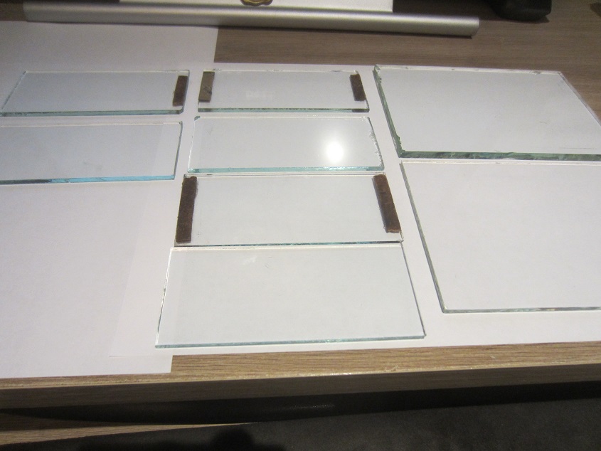

Hi George, I tried to post a picture but no good because of the attachment quota but it looks like what you have described. I soaked the jackpot glass in kerosene and that separated the glass and removed most of the plastic lament. I will try the thinner on the 3 reel glass pieces to see if that works any faster. Too bad we cannot post pictures because it would be cool to see the original glass from the Mills factory. Thanks everyone for your replies

Thank you Dave, The thinner worked great on the reel glass. Here is the before and after pictures of the glass and Thank you MONTI for the original glass example picture!
