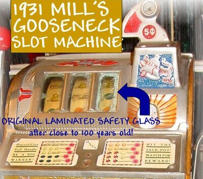

by MONTI
Thanks Dave!
Working now my Friend, you can get back to your summer fun! :lol:
Caio!
Re: Restoring Mills Glass
PostPosted: Mon Jul 25, 2022 8:04 am
by Bally Bill
Thank you Dave, The thinner worked great on the reel glass. Here is the before and after pictures of the glass and Thank you MONTI for the original glass example picture!
