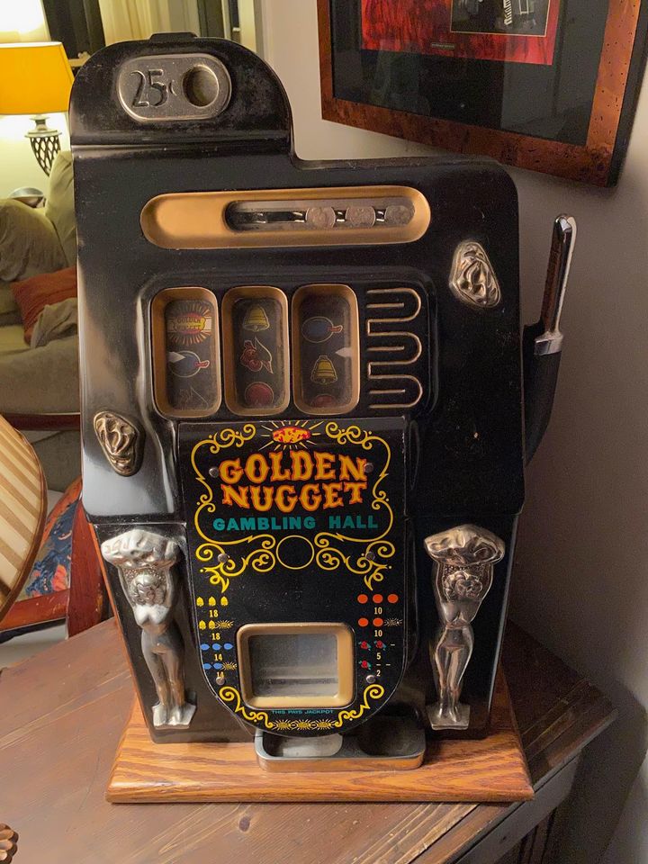

Postby capt7310 » Sat Dec 10, 2022 4:39 pm
Just picked up this Golden Nugget, was all complete got it for a great price, the owner said he had it for many years but it needed an adjustment, he said it never paid out correctly. So after hours of looking into the reel strip book and checking out reel strips from Mr. Frinks catalog, every symbol seems to line up correctly, but I keep getting mystery payouts. If I line up Orange, Plums, Bells and Jackpot it pays correctly, but then every few pulls it will payout random on 2 different symbols. I'm at a loss. Any help would be much appreciated. Thanks

Postby nvmos2 » Sun Dec 11, 2022 12:48 pm
These fake Golden Nuggets seem to vary widely in quality and reliability.
Since "it never paid out correctly", you've probably taken the obvious first step;
Perhaps the reel discs don''t match the reel strips; when it gives a random payout, check the reel payout discs to see if there is a hole and the fingers are properly calling for a payout.
If the fingers aren't detecting a payout, it could be a number of things; you'll have to trace the payout system to find the worn part/spring that is allowing the payout slide(s) to release.

Postby capt7310 » Sun Dec 11, 2022 2:51 pm
Thanks for the info. I actual noticed the vertical fingers were bent at the bottom and 2 of the horizontal fingers were also bent. I straighten them both out and it was playing great, but it stills pays out on 2 plums and a orange and 2 orange and a plum, very frustrating, maybe I'll make it mystery payouts LOL

Postby Shane » Sun Dec 11, 2022 3:25 pm
As mentioned, you can map out the pay combinations by turning the reels and referencing where the disk holes meet the payout fingers. The closest holes to the outside are cherrys, then oranges, plums, bells, Jackpot.
When a hole lines up with a payout finger, the symbol on the front should match up to the appropriate hole position.
I'm guessing your reels strips are close but do not exactly match up with disks.

Postby marsonion » Sun Dec 11, 2022 4:18 pm
capt7310 wrote:...but it stills pays out on 2 plums and a orange and 2 orange and a plum, very frustrating, maybe I'll make it mystery payouts LOL
I had a similar problem with a Pace Primadonna (the first slot I ever bought): it would pay out correctly on all oranges, but also payout sometimes on two oranges and a plum, and sometimes even on two plums and a bell. What I found was a very loose/wobbly third reel payout wheel, and vertical fingers that were bent in such a way as to probe the adjacent symbol-hole (sometimes) on that wobbly third payout wheel. Stabilizing the loose payout wheel and bending the vertical fingers to make them "stay in their lane" solved the problem. I got the impression that both the wobbly wheel and the canted fingers combined to create the problem, and that one or the other alone would not have caused the odd payouts to occur.
