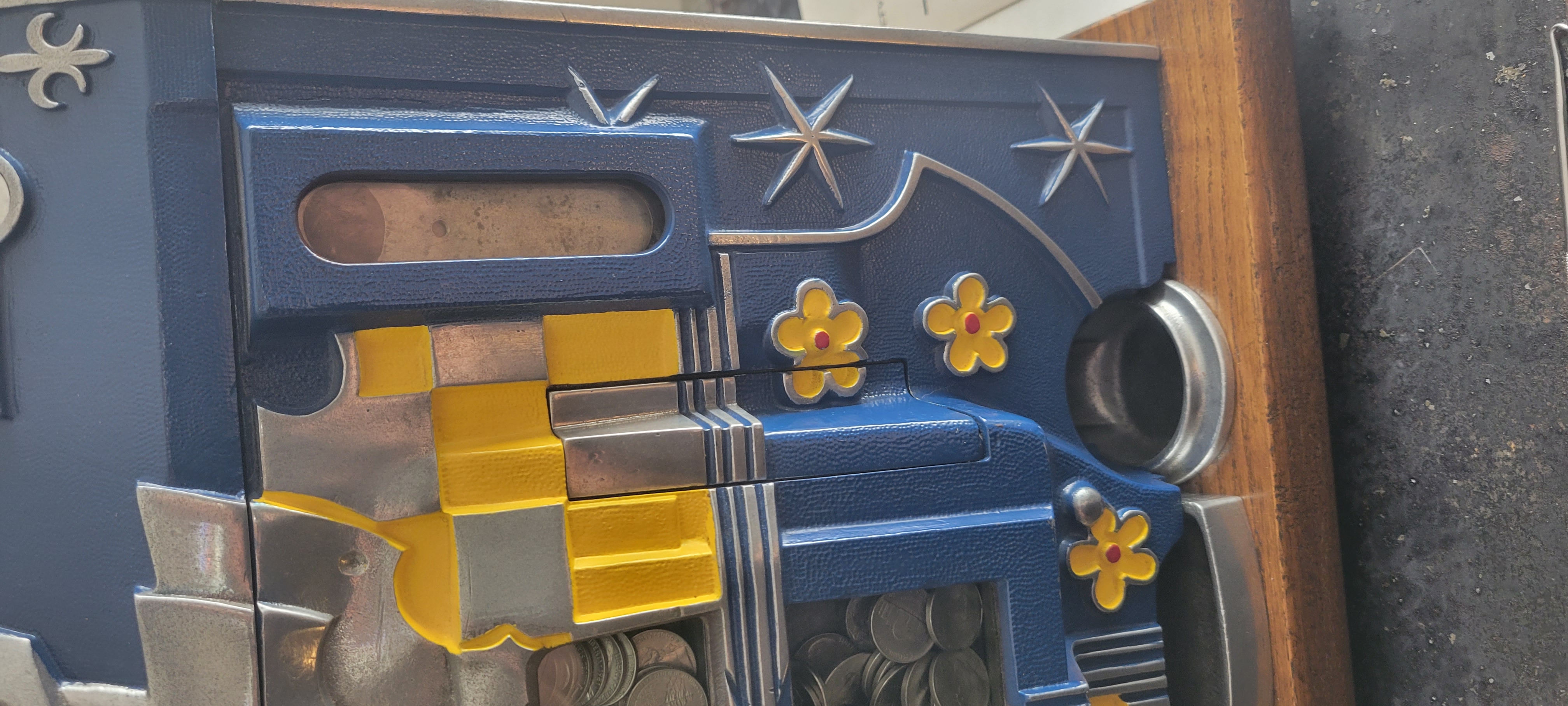

Does anyone know where I can acquire the correct golden award tokens for my castle front machine?
Also, it has 3 holes on the front casting underneath the reel window, can anyone tell me what they are for?
Thanks!

Holes were for skill stop buttons

You can find tokens on eBay and the holes in front were for reel stops but they removed them what a shame
