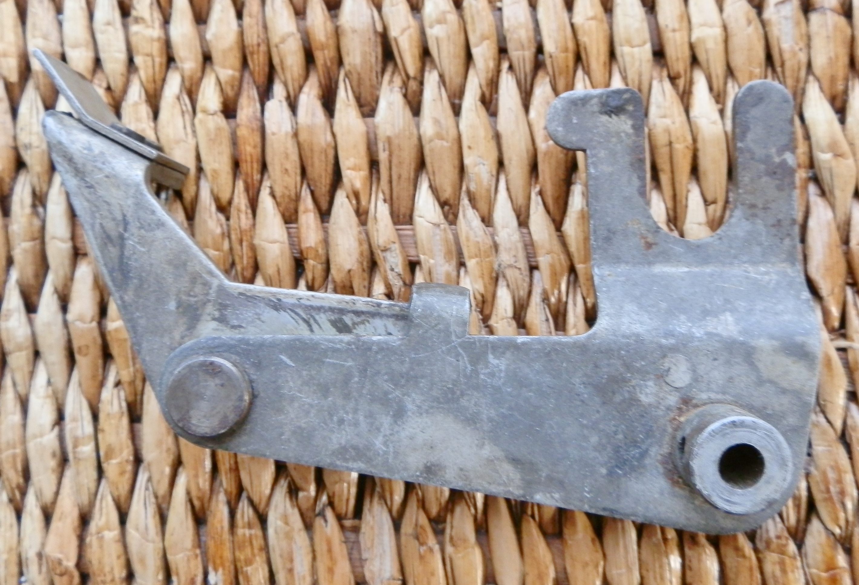

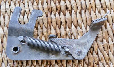

Postby insertcoinhere » Sat Jan 07, 2023 12:10 pm
I have a Silent FOK that several years ago I was trying to gather parts to put together the linkage that prevented play if the mint vendor was empty. I never did get all the pieces and am thinking of resuming that quest. In the meantime, I found a part laying around that I can't identify. The machines works fine, pays out, JP works, etc, so I don't think this part is crucial to the operation but just have no idea what it is for. Is it related to the vendor linkage? Anyone know what it's for?

Re: What is this part (Mills Silent FOK)
Postby oldslotman » Sat Jan 07, 2023 3:06 pm
Reel kicker
Postby altort » Sat Jan 07, 2023 3:49 pm
That part is the reel kicker must not belong to that slot or it would not operate, as far as the coin return parts for empty vender, what parts are you missing? the front vender parts, mech parts or the escalator parts? I restored one long time ago and had a spare cabinet with all those parts, not sure if i even still have any of them any more, if it would help you I can send you a link with all the pictures of those parts apart and re assembled in place.

oldslotman - Thank you for the quick response. Now the mystery for me is how did I end up with a spare....
