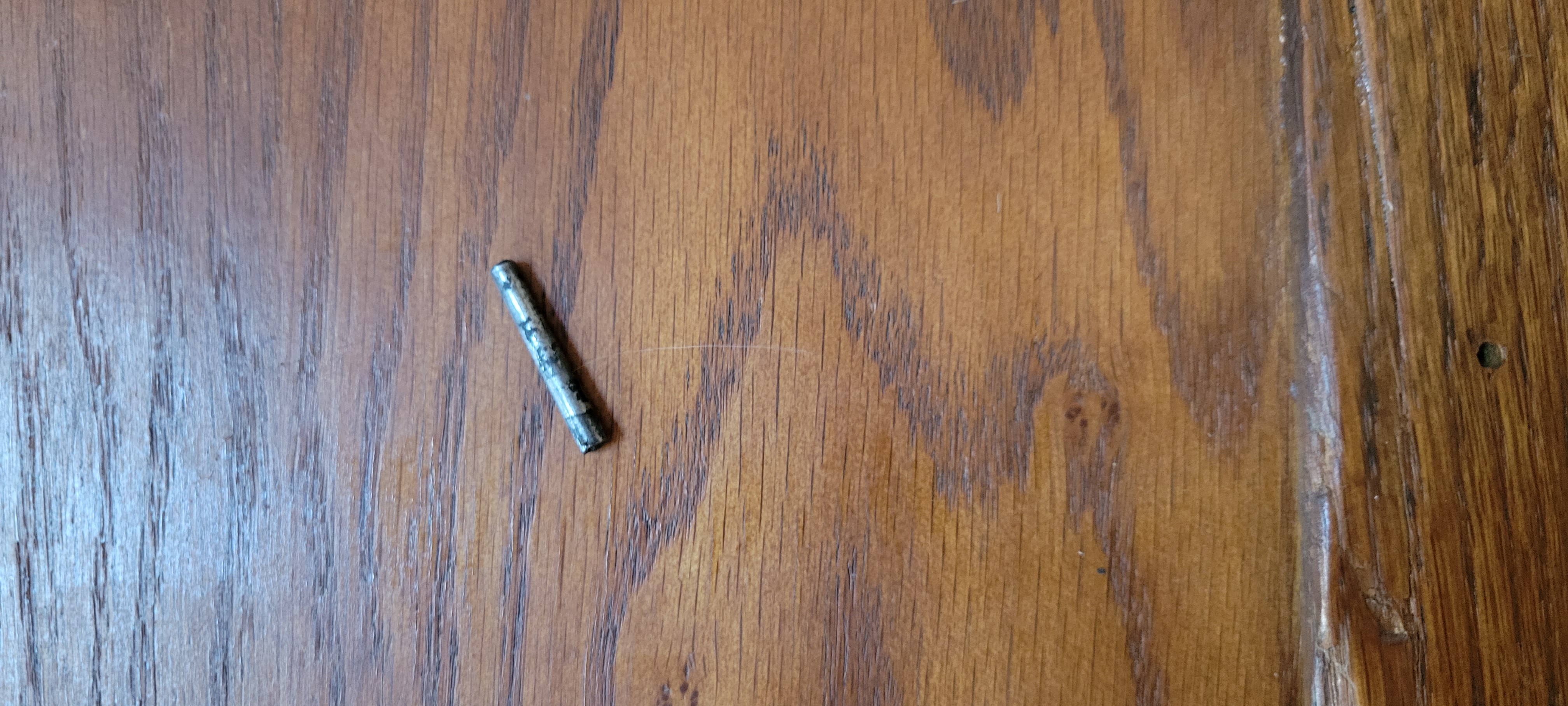

Hi George, Thank You. Did what you said Came right out. I know why the wheel does not spin, this roll pin fell out when I took out the mech. I can't seem to locate where it goes. The main gear gear where the wheel goes into also fell off, I'm assuming the wheel shaft is what supports the gear. Again any help is appreciated. Thanks Paul

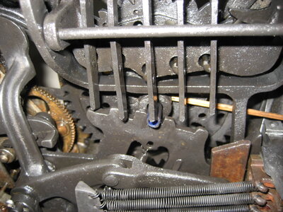

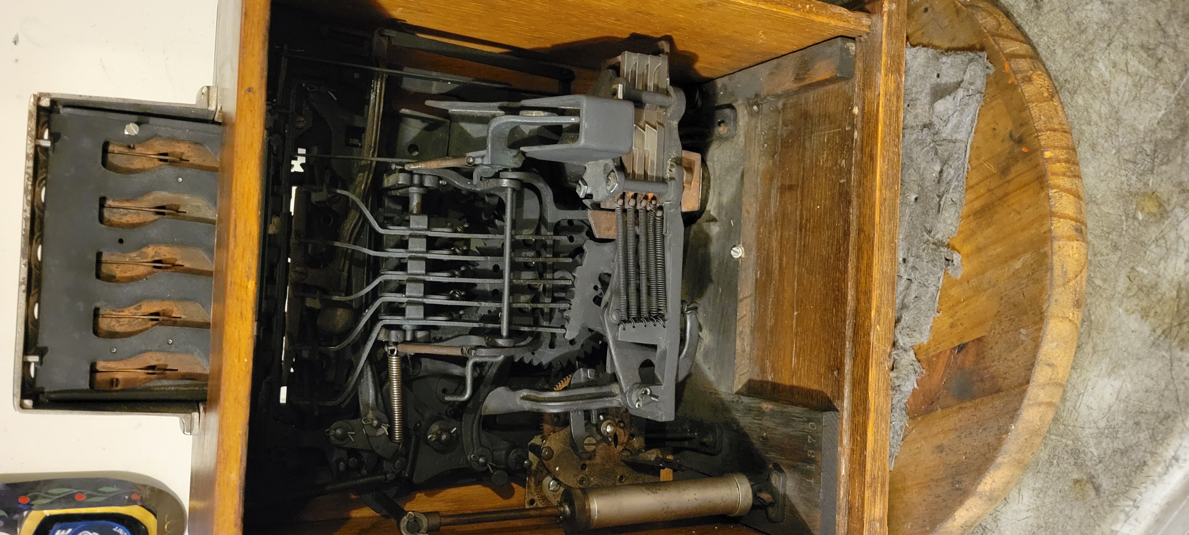

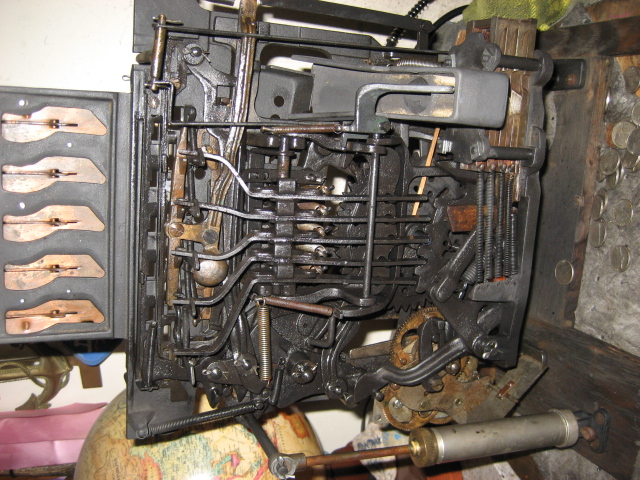

Does anyone have any pictures of the mechanism for a Ben Hur or a diagram. I can't seem to figure how the wheel connects. There was a roll pin that fell out and I thought it went all the way through to the main gear, but it can't because the wheel will not spin. Any pic or answers would help. Here are a few pic. The brown is a pointer where the hole is for the main gear, the otheres are just random, to see if I'm missin something.. Thanks

Found a pic from Morphys Auction, it help with figuring out what needs to go where. Very surprised with collectors on this site with 50+ yrs experience and no responses.
