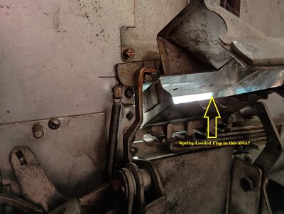

Hello All,
I have a Jennings Duchess that the coins will not fill the jackpot. They just go straight to the drop. I believe it is missing a spring-loaded flap (or more) that will divert the coin into the jackpot. I have posted a photo showing the upper part of the jackpot. If someone currently has a Duchess, could you please post a photo showing this area so that I can fabricate something similar?
Thanks in Advance.
63mini

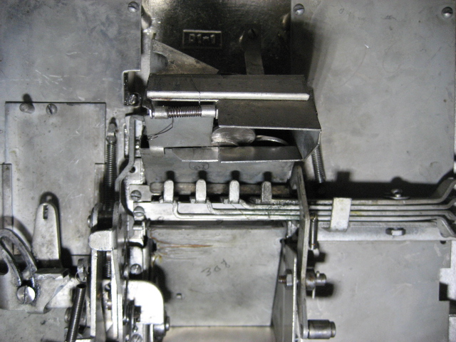

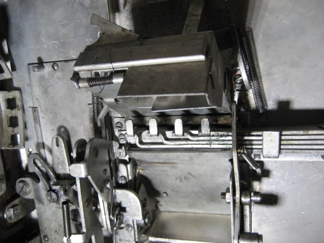

Postby capt7310 » Sat Feb 17, 2024 9:22 am
Here's some pic of my Duchess Jackpot hope they help. Good luck Paul
capt7310
Posts: 363
Re: Duchess Jackpot Photo Request
Postby 63mini » Sat Feb 17, 2024 10:34 am
capt7310,
Perfect! That's exactly what I needed. It seems pretty Easy Peasy to do. I think the most challenging thing will be the spring tension.
