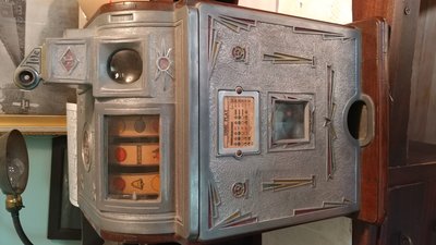

Finally had a chance to get a local slot off the price guide referral for an original Jennings Victoria. Has original rear doors and cash box but the upper door is missing its lock. Took a chance as it wouldnt play at the sellers house but I pulled the mechanism out and it looked complete so I was certain it was something minor. Got it home and began to clean and lube it, and thats all it needed. Even the complex jackpot mechanism works. Still has the original back door instructions. Sellers dad bought it for $50 in the 1960's. Ive attached a couple pictures.
Looks like you found a nice original machine.
Glad the price guide helped you out. I think a few people are finding some good machines via the referrals but don't want to advertise that fact so there is less competition for them. :D
