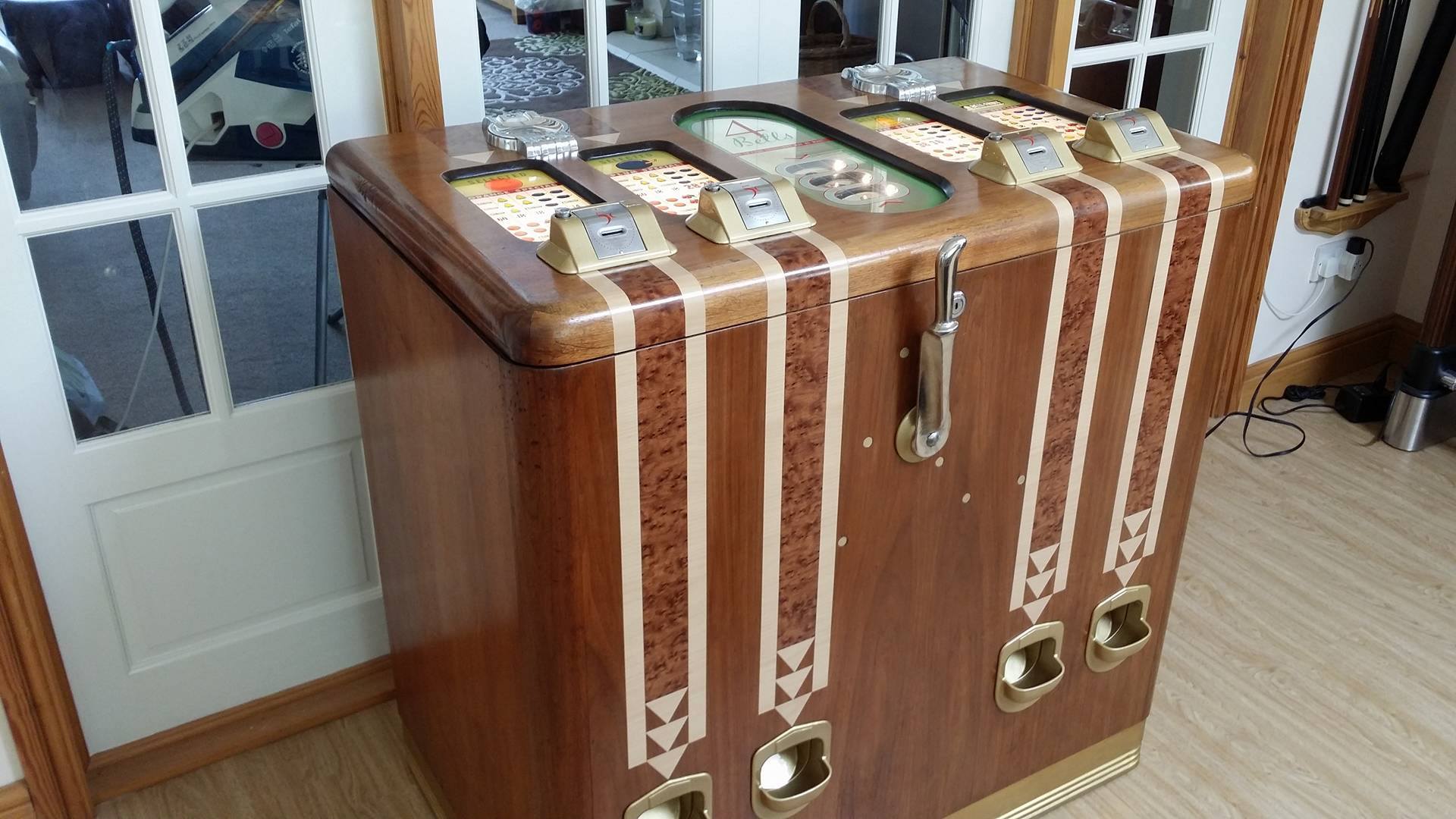

Can anyone identify this machine? Is it fully mechanical? Value? Really interested in possibly buying it but I cannot find any info on it.
Just getting into antique slots and thought this was very unique

Hi,
The machine in question is NOT a Jumbo Parade, but a Mills Square Bell, without seeing a better picture I would think it has been taken from its original cabinet and installed in another cabinet, in the published picture it shows what looks like a wooden coin entry, when in fact the original had a metal low top housing that held the escalator (See picture of the Mills Square Bell).

I think you nailed it, I’m not sure if Mills didn’t make many of these but this is the first one I have ever seen. I thought it was all mechanical but I’m guessing the skill bonus is electrical.

top info above from Freddie!
he is also correct that they are, indeed, undervalued.
Glass and electrics put people off?
You asked for value, I would say $600 -$1200.
Glass looks good so nearer the upper estimate.
is the skill feature working?
Yes, it is electric, but very simple affair that stops the clock just before the fifth click until the little ball switches the middle contact on the skill field.
Pace done a blatant copy of the mills Square bell that is far more numerous called paces reels.
The horse race model was the Saratoga
Mills eventually dropped the square bell for the Four bells in late 1939.
