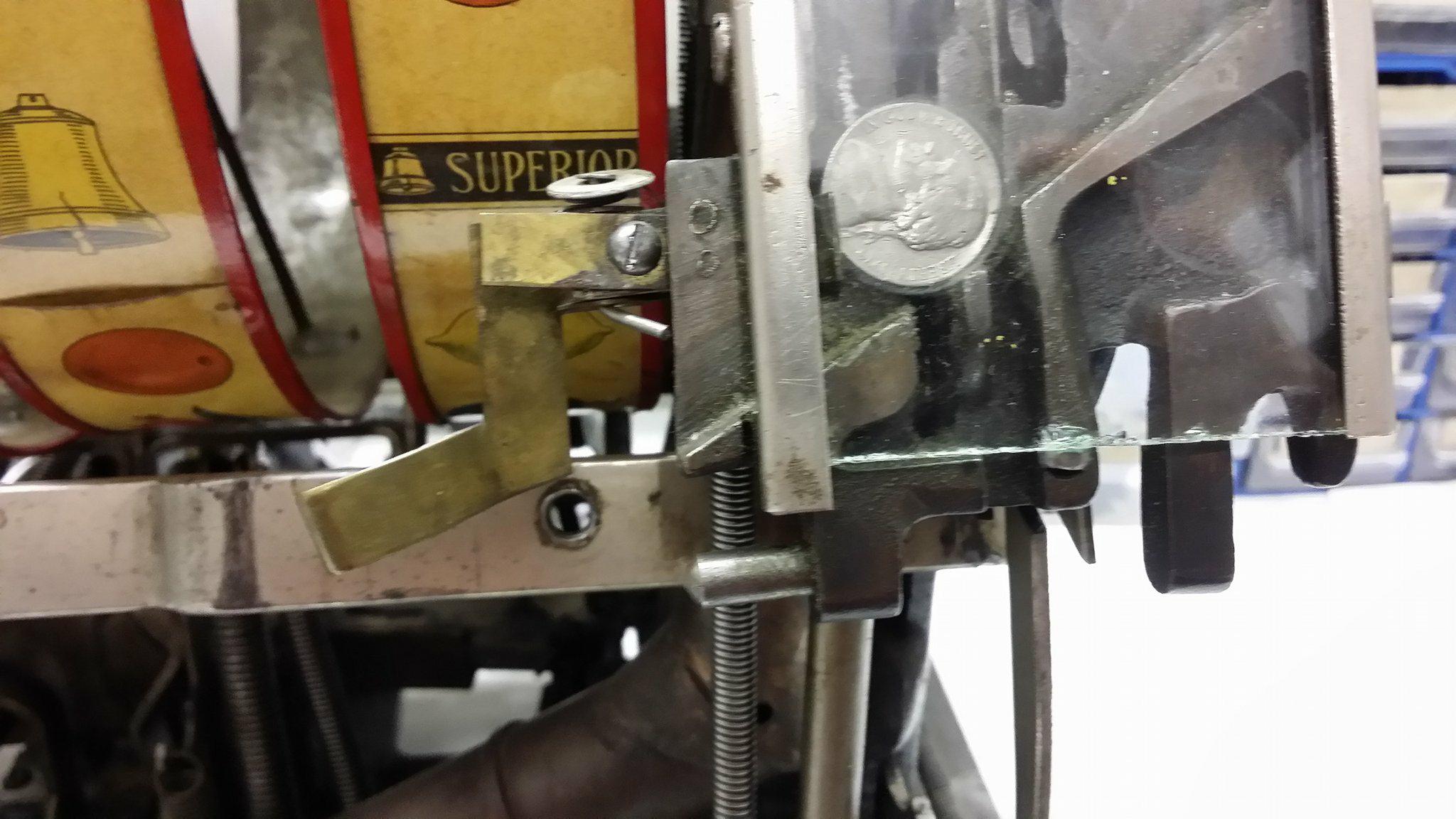

I have an Early Silent Sphinx.
My issue is with the 2 cherry part to fill the jackpot.
not sure whether the linkage to the payout finger is missing or the Sphinx was designed to fill the JP some other way??
see pic of my present set up that looks home made!

I sorted it.
the early Sphinxs do not filll the jackpot via the 2 cherry pay.
there is a little brass L shaped lever at the bottom left corner of the escalator.
it swings freely in a square hole cut into the channel that feeds the jackpot.
once jackpot is full it shuts off ensuring subsequent coins played are lifted up the escalator into the coin tube.
