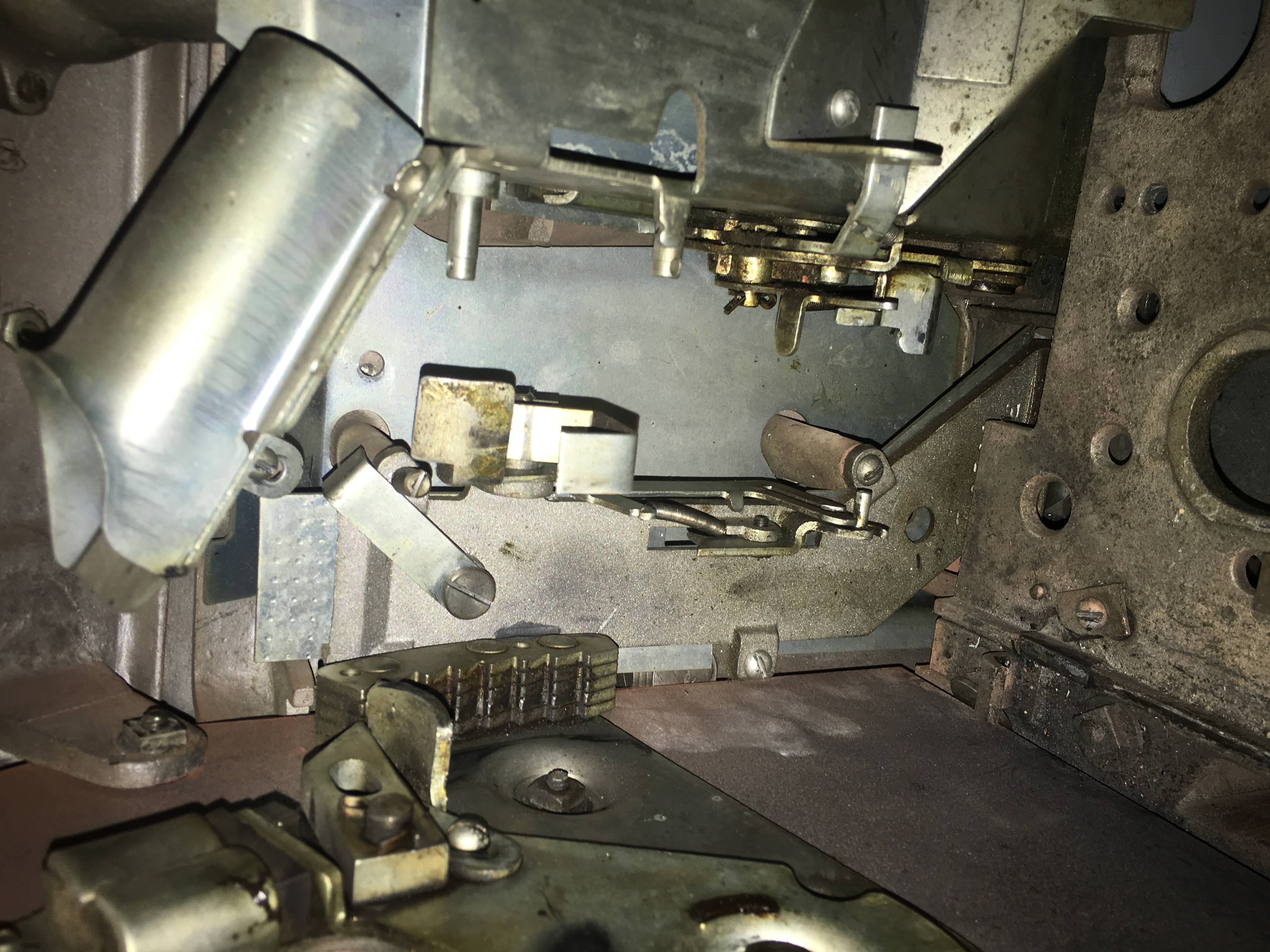

Postby Rickromero0078 » Thu Mar 08, 2018 8:50 pm
This is the inside of my mills high top Bill wild machine that came from the Mapes is this a token vendor inside if so how do I determine if it works and what size tokens it takes was there different sizes for different denomination machines?

Postby mechanic » Fri Mar 09, 2018 12:16 pm
The token unit looks complete, you shouild also have a long bar that runs from the back to the front of the mech and should be connected to the backspin lever that sets behind the reel disks. Tokens will be the same size, the difference being the token color for the machine denomination. They come in Brass, Silver and Gold color. Check with mrslot1 he should have them.

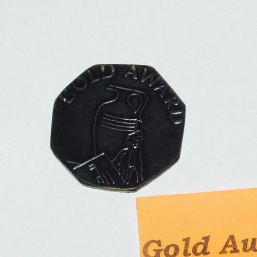

Postby gsx11r » Fri Mar 09, 2018 1:33 pm
If I remember well , there are diferent color for diferent denomination.
BLack for 50c
Gold 25c
silver 10c
Brass 5c
I Don t know for the 1c , maybe cooper !?
And I m maybe don t give them in the right order , so let me know !!
It look ike this one ! An octogonal gold award

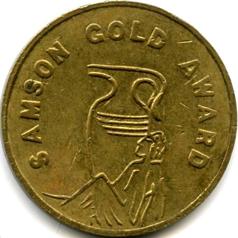

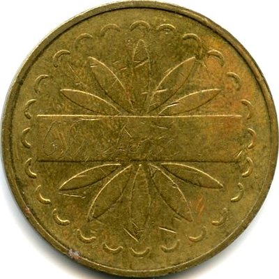

Postby Anglobritish » Sat Mar 10, 2018 9:29 am
Hi Guy's,
The attached pictures are of the Vender Tokens that were used in Mills Novelty Company's Extraordinary machines, by their British distributors
