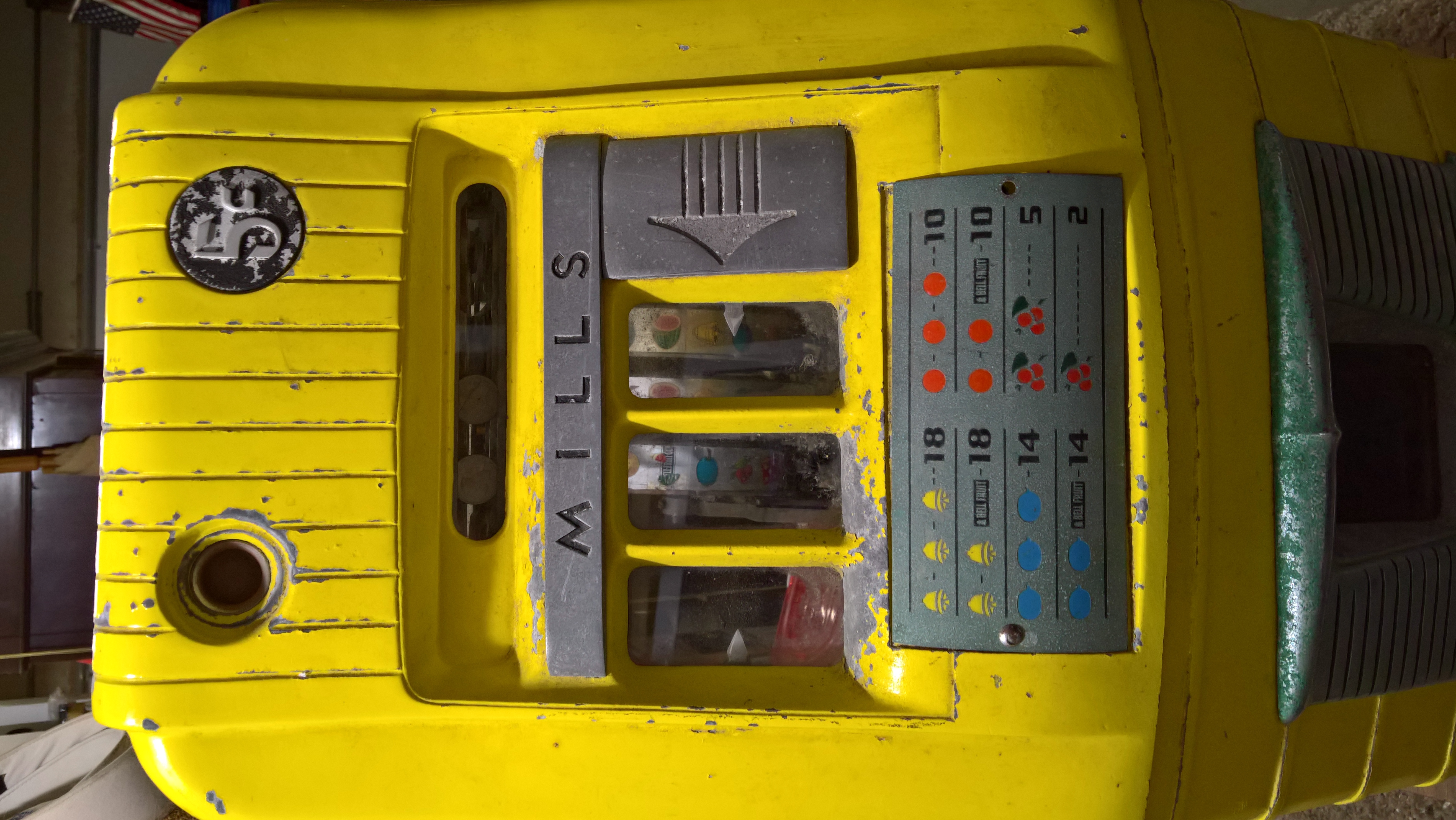

Exterior
It is presumptively a Mills escalator Jewel Bell (at least the case seems to be), but the mechanism is a bit unusual. It is a 2-5 20 stop that has been modified. I cannot discern a serial number or other identifying marks, other than standard Mills part numbers on the base plate.

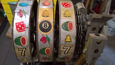

First of all, the reel strips appear to be a customized set of silver Mills CC-537. The strips have overlays in certain locations of various uncommon symbols: Melon, Dice, Eightball, and the 7. Some of the overlays have begun to peel due to age and deterioration, showing stock symbols underneath (lemon, i.e.)

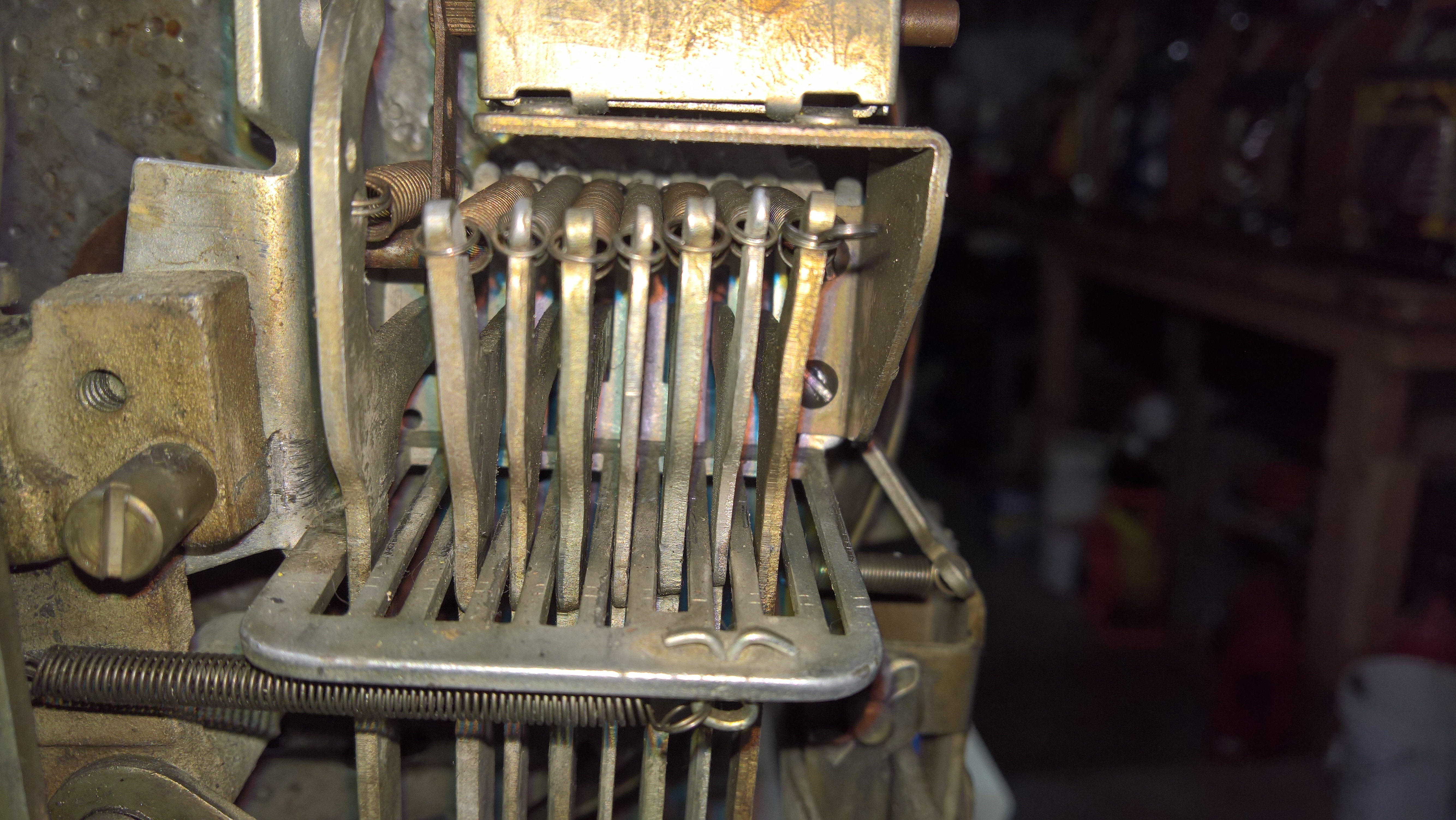

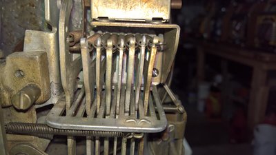

More significantly, each of the overlay symbols has a corresponding payout lever that has been sandwiched in between the normal cherry-orange-plum-bell levers. That makes for a total of SEVEN separate payout levers, plus the jackpot. Looking at the below photo, counting from right to left, the payout levers are:
1. Cherry
2. Melon
3. Orange
4. Eightball
5. Plum
6. Dice
7. Bell
8. 7 (Jackpot)
The reel discs are properly slotted to facilitate the additional payout levers.
Payout Levers

I have audited the payouts in regard to the reels, and in addition to the normal payouts, in the event of a sequence of of three melons, or three dice, or three eight balls, each win will pay 20 coins. The 7-7-7 combination will also pay 20 coins, but it is the only award that triggers the jackpot lever. There is a single BAR on reel one and on reel three, but no BAR on the center reel, so there is no possibility of a BAR-BAR-Bar win.
The case has a fixed coin window "jackpot" that is not triggered by the mechanism in the event of a 7-7-7 win, so I assume that the machine is intended to be an "attendant-paid" jackpot.

It is a Mills Jewel with a patched reel bundle. The three thin fingers go to the Melon, Dice and 8-ball symbols. Triple 7's should either act as the bars and trip the jackpot or if a guarenteed jackpot then the 7's trip the token vendor releasing the token into the money tray. Most of these patched bundle were done by Operators or if it was in a casino then the casino mechanics did it. All Mills factory machines had matching strips, Mills did not make odd patched strips that I am aware of. Maybe the open fronts made later in the 60"s
