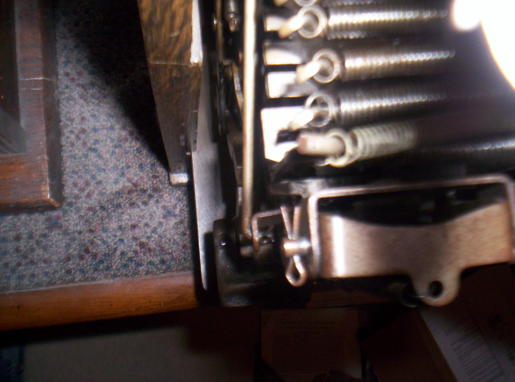

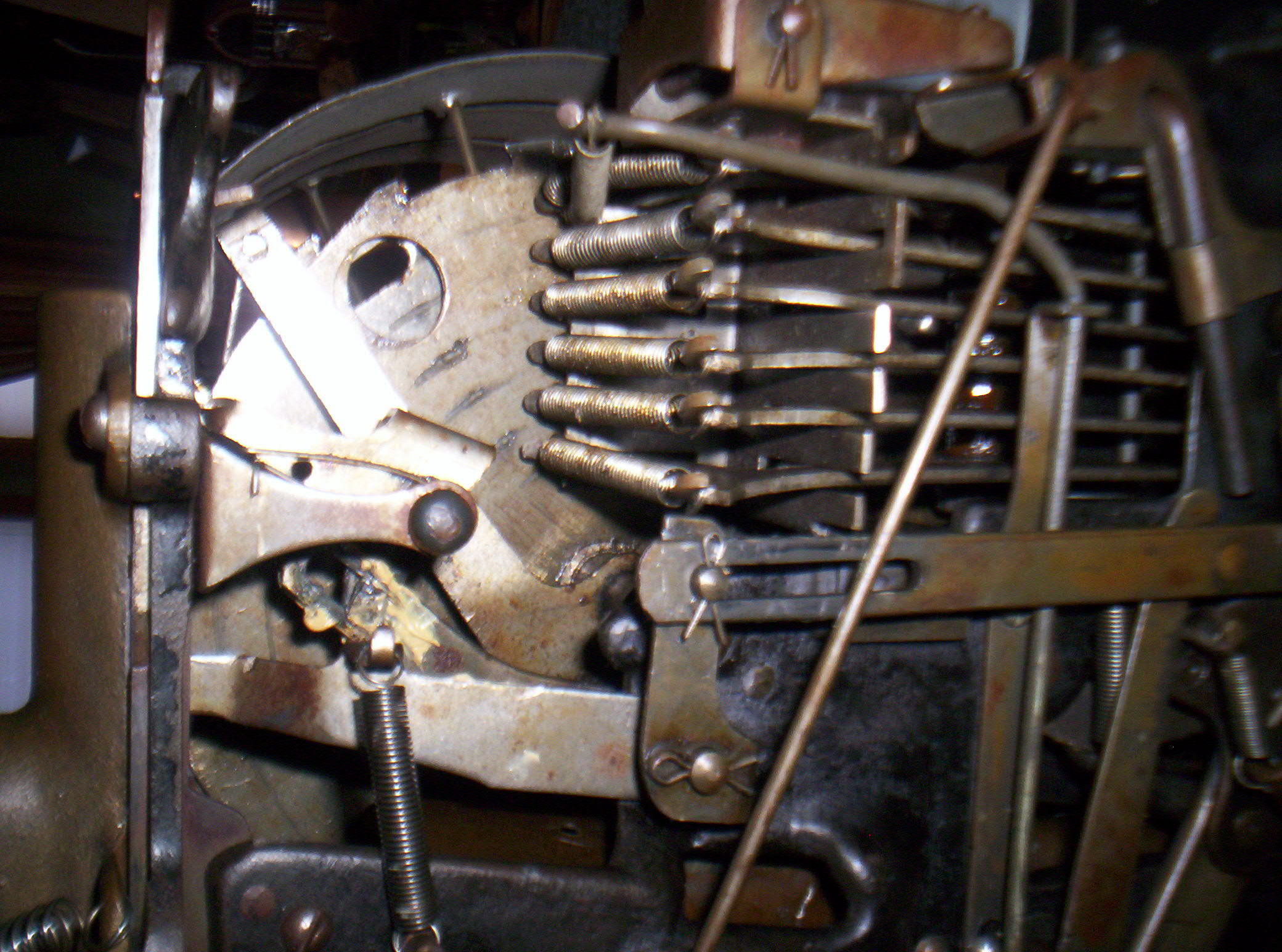

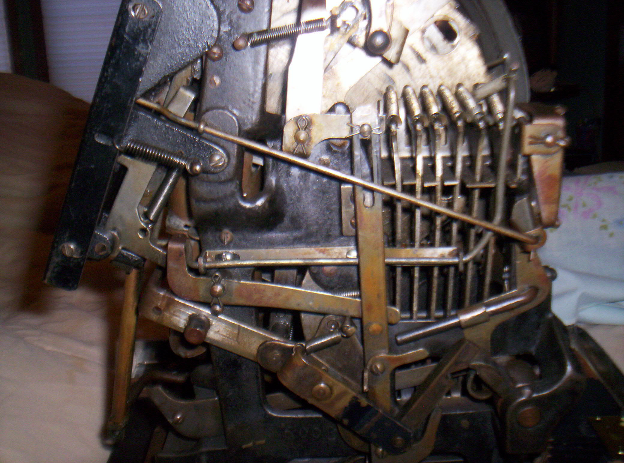

Picked it ip today and the payout scale is 19-21 ,15-17, 15-17, 11-13, 11-13, 7-9 ,7-9 ,4,4 and 2. Machine has a 17xxx serial number. I do have a question about the jackpot fill. It isnt working and I think I'm missing a spring. I took a picture and pointed to where I believe one end of the spring hooks but where does the other end go? All my Caille literature shows later (i believe) superiors and doesnt show this part.

Nobody can help on where the spring goes? I did find a picture on the net but cannot blow it up enough to clearly see. Is mine an early machine being serial number 17xxx?

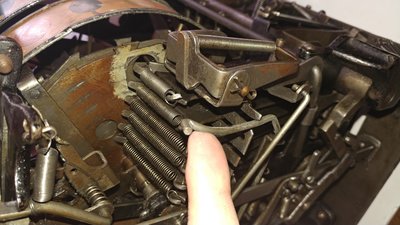

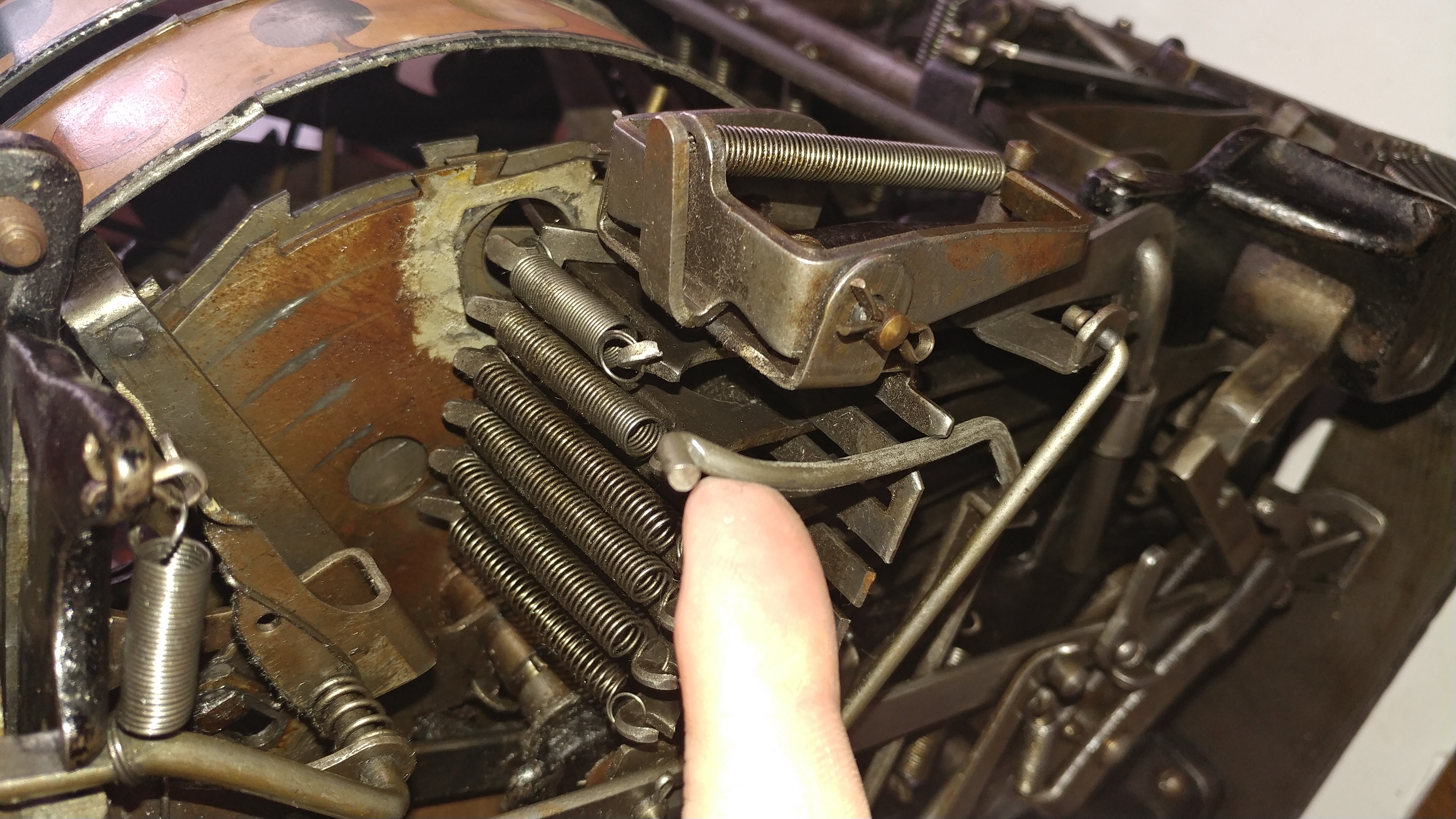

Postby oldslotman » Sun Feb 12, 2017 1:21 pm
Here is a picture of the kit.
