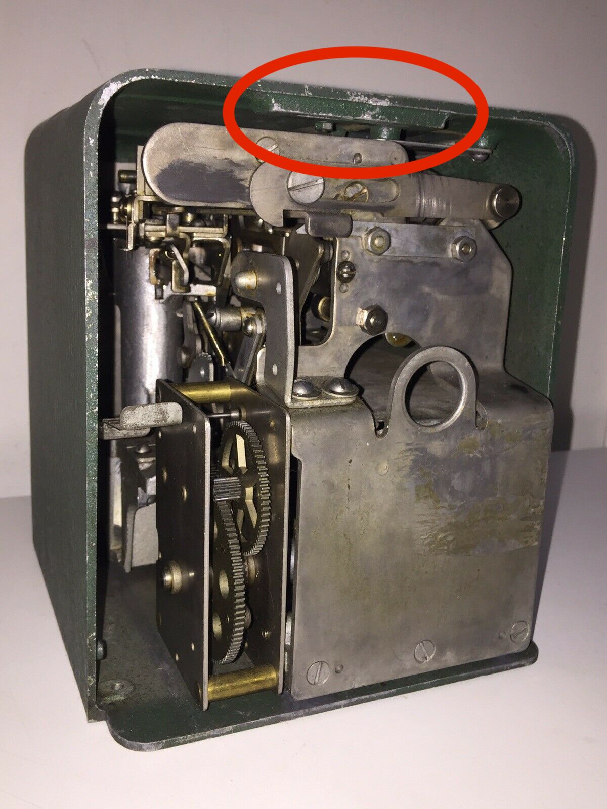

I just realized I have a case (see photo - stolen from eBay since I'm not home) that has the cam lock catch as part of the case, and not part of the reel window frame. This particular VP has an earlier serial number (7623) while the higher numbered units seem to have the catch as part of that frame. I wonder why they stopped making that as part of the case? Was it too easy to break open the door I wonder?
This case is also much lighter than my other VP's. It weighs about the same as one I have that appears to be polished aluminum.

As we know, Mills and the other makes made modifications to their machines as the model production progressed.
I have 2 later model VPs (38xxx and 48xxx); the lock catch is part of the window frame; seems to me that would be stronger than a simple lip on the case center section.

The rest of mine are later models with the window frame catch as well. I've been organizing my pile of 6 Vest Pockets to see how many I can make (looks to be 3) and that's when I realized the difference in the case with the early model which is just four digits. I have a couple of Dave's repo back doors. They definitely are not just "plug and play" so to speak. It took me quite a long time just to get one to fit on a later model case. It's great he has them, but they're thicker than the original, which required considerable grinding, filing and sanding. I also used some epoxy as filler for the pitting. I wish I was a better metal worker! And the "regular" back doors won't fit on the earlier version since those cases have that cam catch that protrudes from the top.

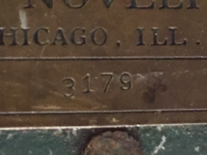

The early model I have is s/n 3179. Somewhere I did read on the internet a list of s/n's and dates but I have no clue where it was.

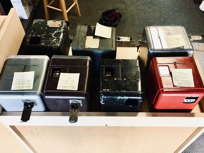

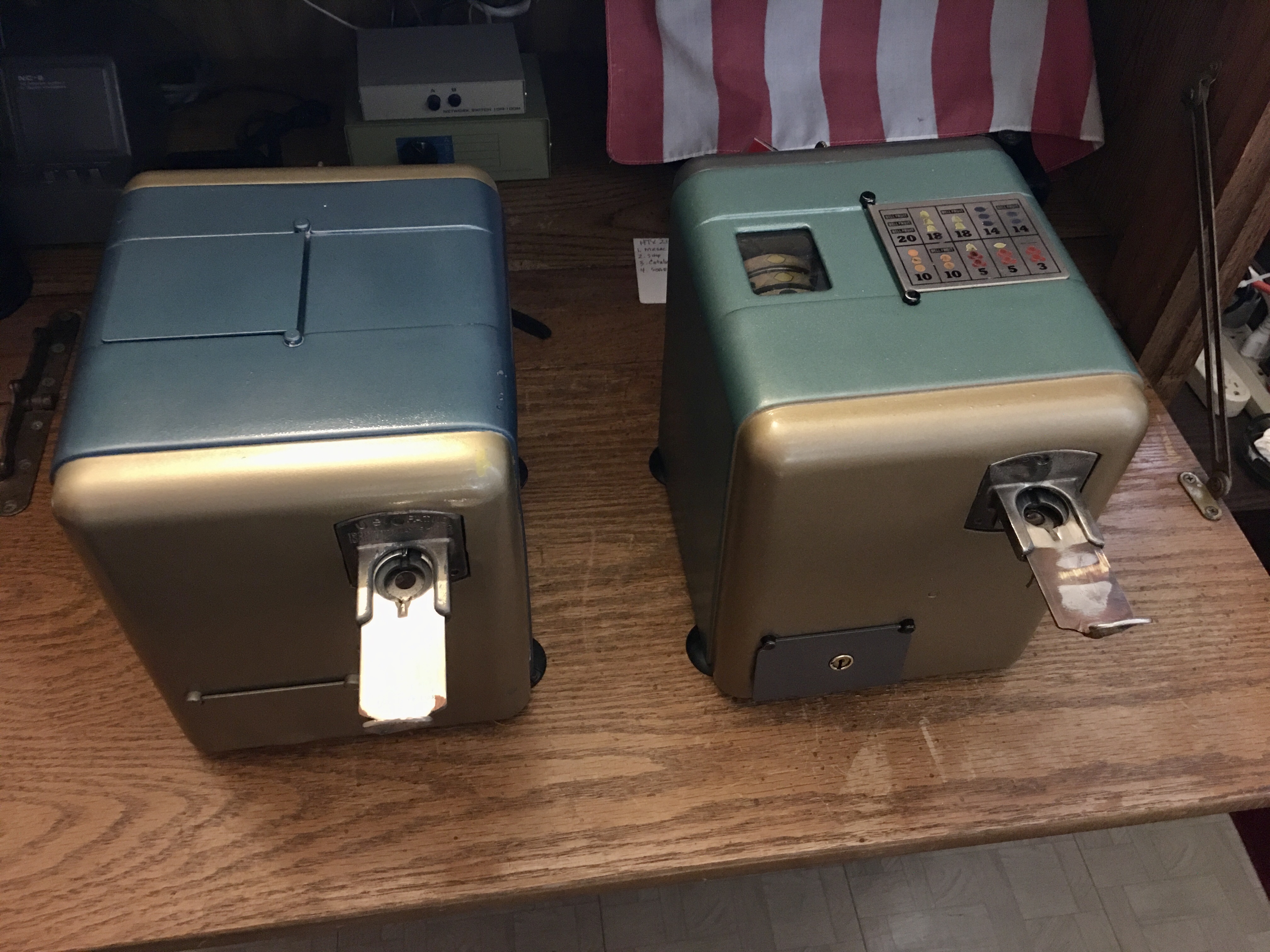

Here's a shot of my Vest Pockets - Two restored in my room and then four more complete, two parts units, and one case (with lids and original feet in great shape!).
