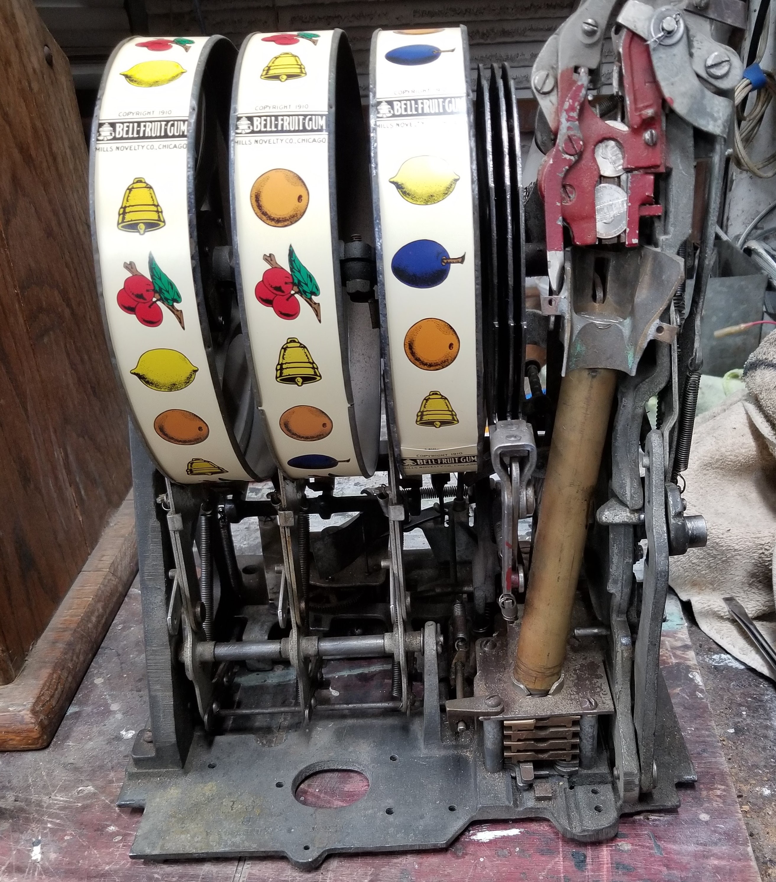

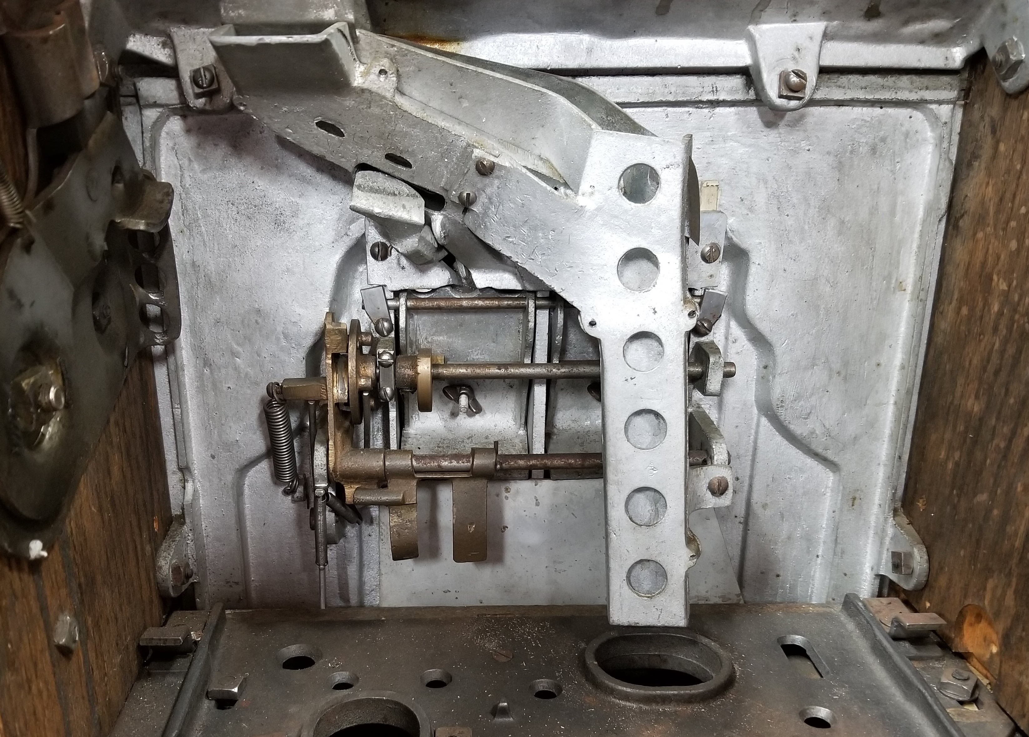

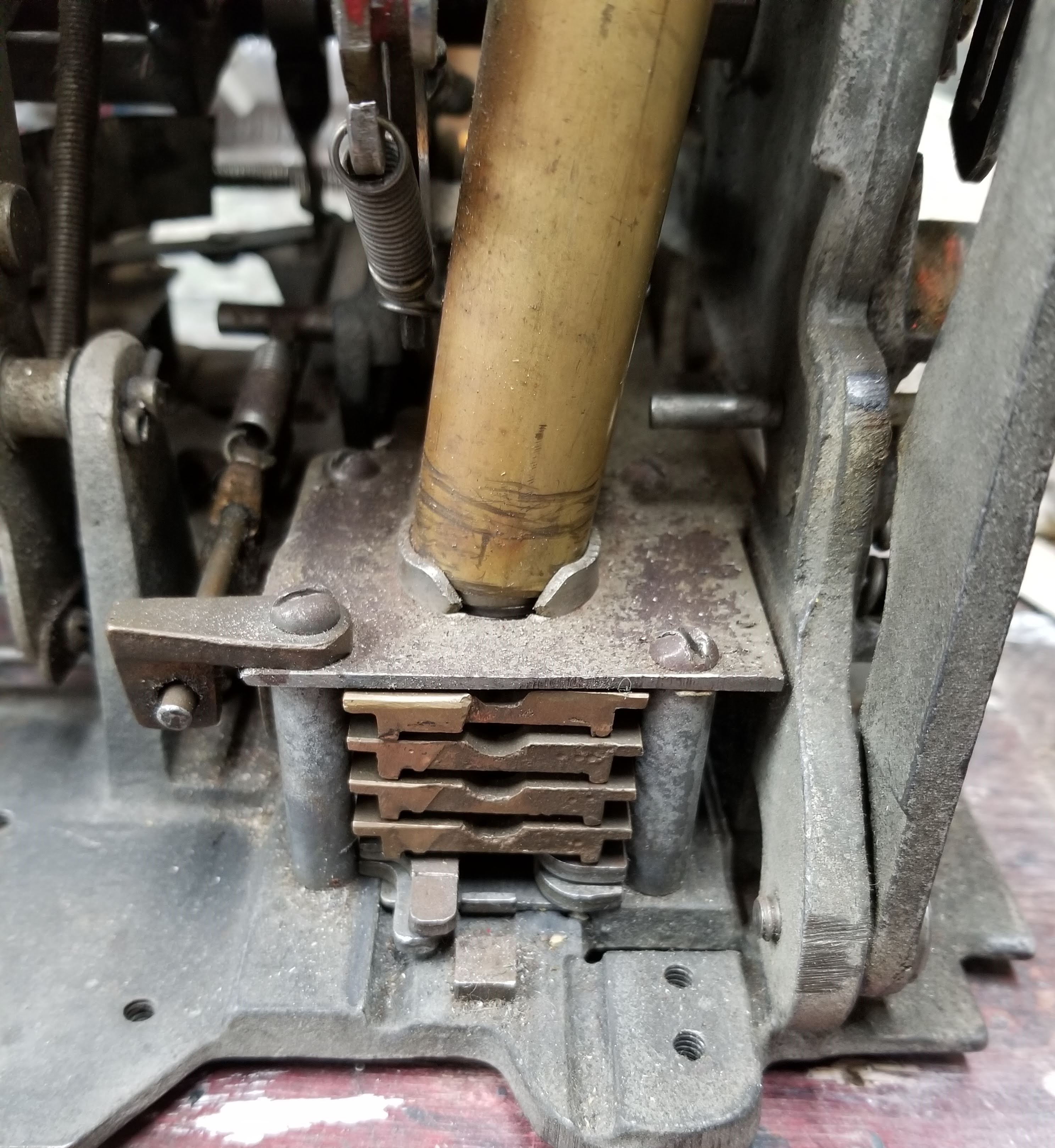

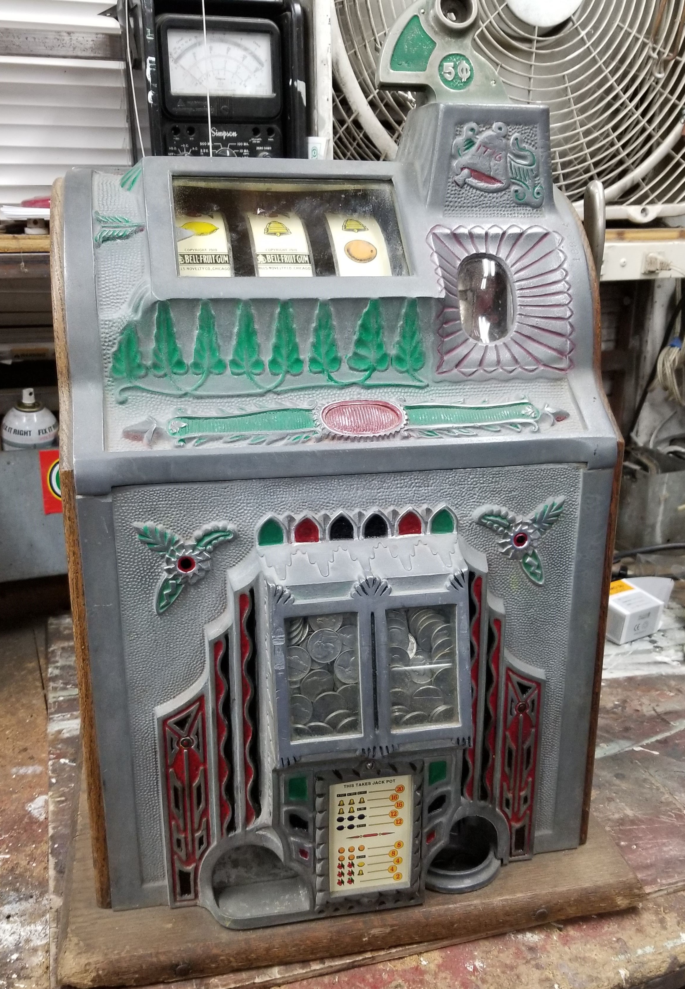

I have a older slot machine and have everything is working except the Jackpot. I think I am missing some linkage that trips or pushes the jackpot but cannot find what it looks like. It does fill the jackpot windows and I can push the jackpot levers to make it dump.
My question is what am I missing and can anyone point me in the right direction to purchase one. Also a little info about this would be interesting.

Looks like it is OK. There should be a lever on the jackpot itself that operates off of the top jackpot slide. When that slide goes back the lever on the jackpot will trip the jackpot.
