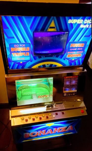

Hello! I'm looking for any information on a Super Dice Mark III by Bonanza Enterprises LTD 1988. I have the machine and absolutely no documentation. The machine fires right up but goes to error "Call Attendant 6". Any information would be greatly appreciated.

Thanks Dave! It was actually your video that led me to this site. I was looking for information on Bonanza games and found you on YouTube. For the most part I'm a Bally EM slot guy but do like the unique games as well. I had been looking for a game like yours and could never find one that was complete. Today the Super Dice popped up in conversation on FB and I immediately bought it and picked it up. This game has several optical sensors that I'll be testing and hope I get lucky.

Wow I've never seen this machine before. Looks very interesting. I've worked on newer slots and one of the biggest issues if they are getting errors is the battery that backs up the main memory looses it's "juice" and causes issues with the internal programming. See if you can look for it on the boards. That one will probably look around 3/8 dia and about an inch and a half long. Take a volt meter and check the voltage. Usually they are supposed to be around 3.4 volts but it should be printed on the battery what voltage they are. A low battery voltage can put up several codes not related to the battery itself so I'd start there.

ThirdGenAmusement, thanks for the reply. The battery is the first thing I looked at and is suspect to me. I picked the game up last night and the first thing I noticed was that an external battery holder had long ago been installed on the MPU board. It's currently using 3 AA Alkaline batteries in series measuring 4.77 vdc. Looking at the board circuitry I do see a diode and resistor as part of the battery circuit and as the board is printed as such, I deem correct. What I don't know is if the external battery was an attempt by a previous owner to get the machine working. Without any documentation, I also do not know what the original battery callout was or what voltage the board wants to see. This game has several buttons and switches scattered around, but nothing on the MPU or anything that currently affects the top screen message or that gets me into a menu of some sort. The board has a repair tag of Good 8/5/98, so it worked as of 22 years ago. Ha Ha! Any thoughts?

I agree that the batteries would be the first thing to try. After that unplug all the connectors, especially edge connectors that might be on the board and make sure they are clean.
I have found that many times unplugging the connectors and just plugging them back in fixes intermittent problems.
