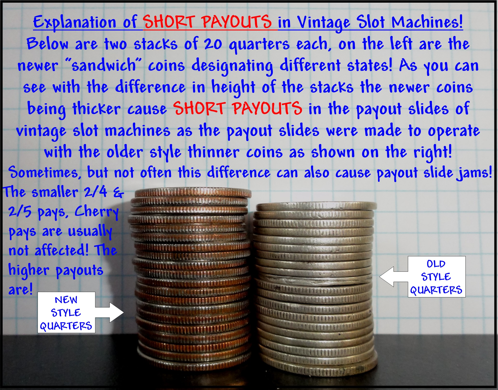

The diameter is not as much the issue as is the thickness difference and payout slide issues could occur!
Wrong payouts on higher pays and possible slide jams!
Try it the worst thing that will happen is a payout slide jam!
Also you don't show the Award Card in the photo and they are usually set up for the European market with different payouts unlike the US market!

1.75 versus 1.77

Granted the per coin difference, which can also vary due to age & wear may not be that great as you show but in a stack of coins as shown here using quarters the difference increases with each additional coin!
Which shows up with the higher payouts!
Working with primarily vintage slot machines this is evident in the shop frequently!

Thanks for the advice. Seems to work tolerably well with quarters and pays out.
Elevator is a bit gunked up,& coin slot needs cleaning.
