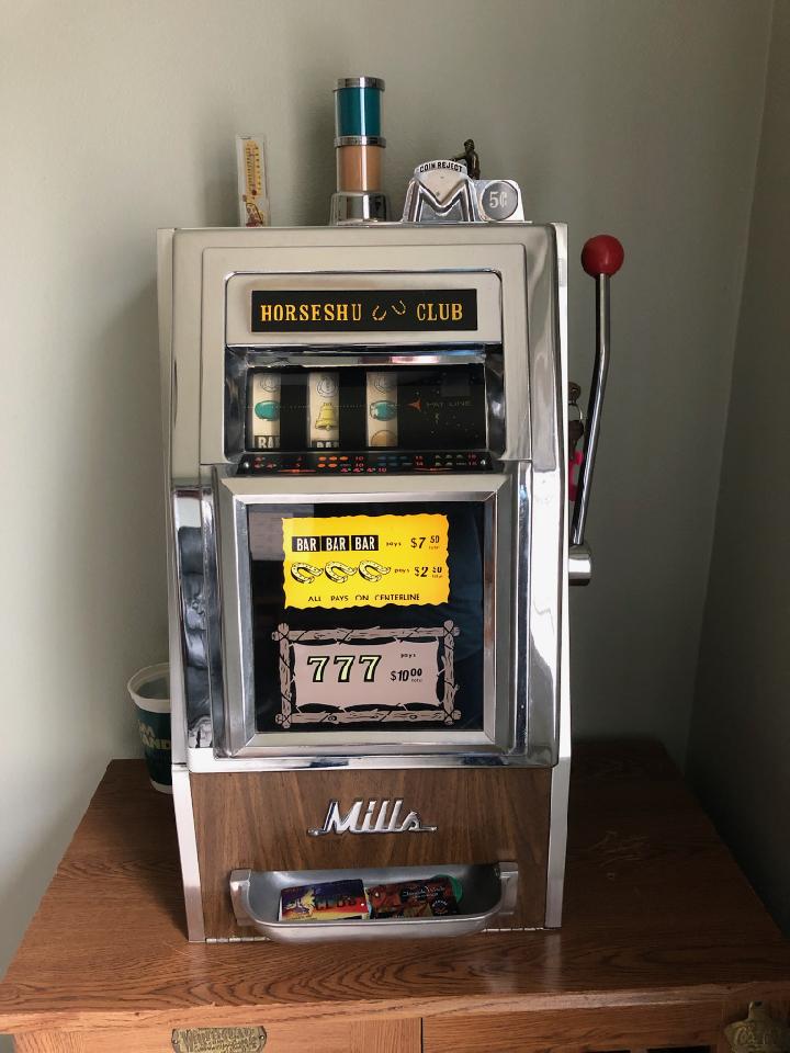

This beautiful Mills Electro Mechanical machine belongs to a friend. It accepts coins as usual, it will spin when you pull the handle, but the reels just spin freely until they stop on thier own.
We would love to fix it.
Picture here:
If you need any aditional info or pictures just let me know.
Thank you!

YOUR REEL STOP TIMING BAR IS NOT MOVING SO THE STOP ARMS BETWEEN THE REELS JUST STAY IN THE START POSITION. CHECK TO SEE IF THE TIMING BAR LINK FROM THE CLOCK TO THE TIMING BAR IS HOOKED UP OR EVEN THERE.
