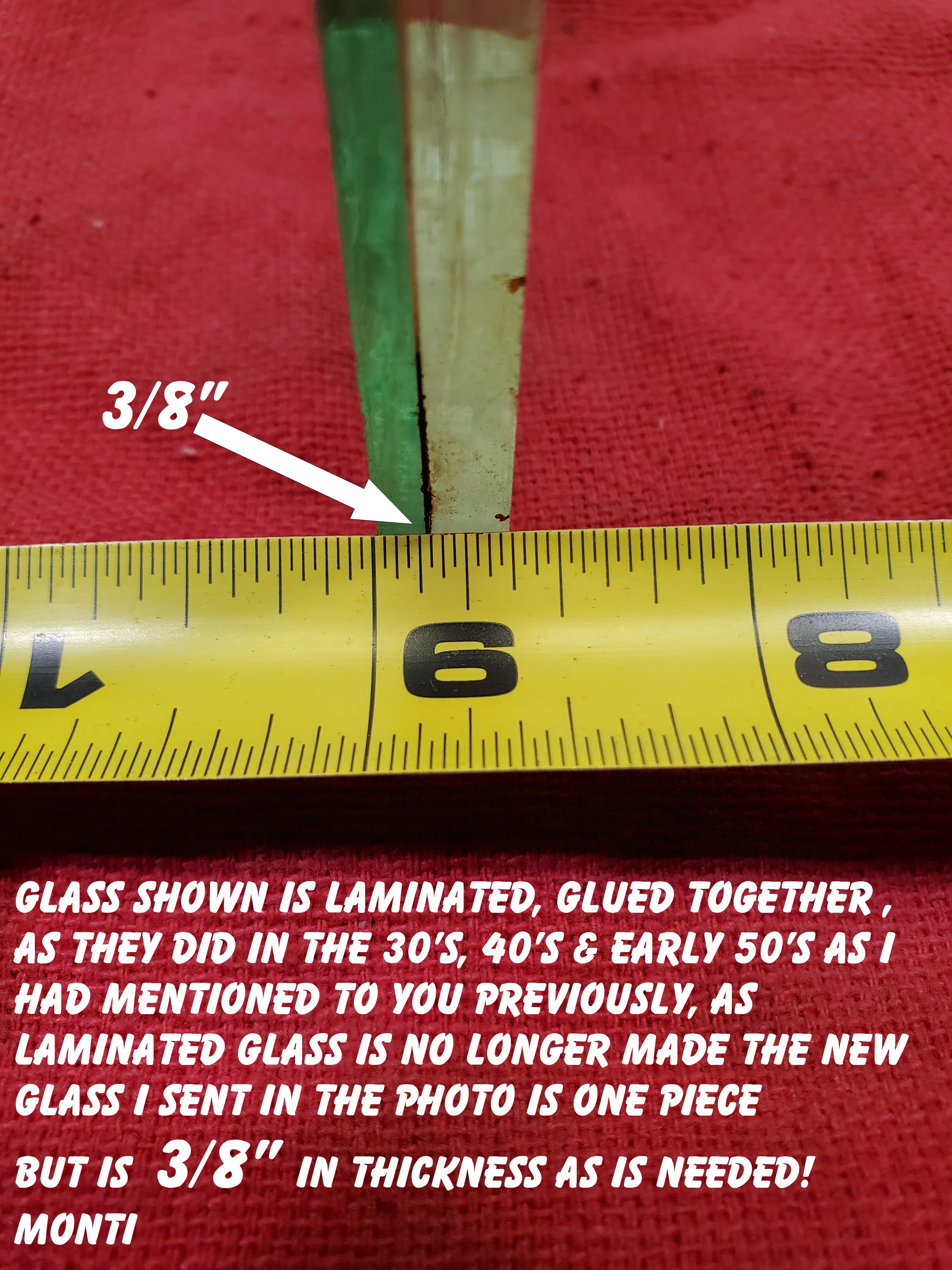

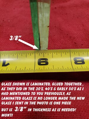

radiorich123 wrote:Just make sure the glass is 1/4 inch thick.
Jackpot glass is 3/8 inch
Re: Mills Slot machine question.
Postby MONTI » Wed Aug 23, 2023 9:27 am
Here below is a photo i had recently sent to a customer with the Front Jackpot issue showing a measurement of the original laminated glass that was used on the Mill's slot machines!
Being laminated it was considered safety glass in those days!
3/8's" is the size needed for a nice original snug fit as it was designed for!
Hope this helps!
