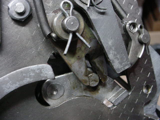

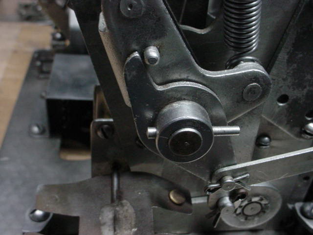

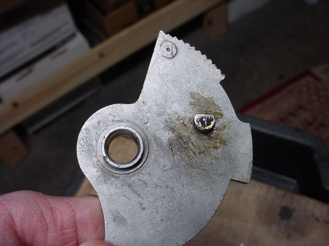

Postby rtmccurdy » Mon Mar 31, 2025 1:01 pm
If your reel stop levers, payout lever, and jackpot levers are all functional then here are a few areas that can cause problems. On the left side of the main shaft is a lever with a taper pin. This lever can wear at the tip and not provide enough downward force to make sure the reels are free to move in the cycle. On the right side is a large cam that interacts with the handle. On the back there is a small pin (crescent shape) that can wear sufficiently to inhibit the pull back start of the cycle. Another is behind that cam where a fork interacts with the main shaft. The tines of the fork can break and the small round protrusion on the main shaft can also wear (not too common). Hopefully the pictures will help identify these areas. If you don't feel comfortable disassembling your mechanism then you can have it worked on by a repair person. I work exclusively on QTs.
