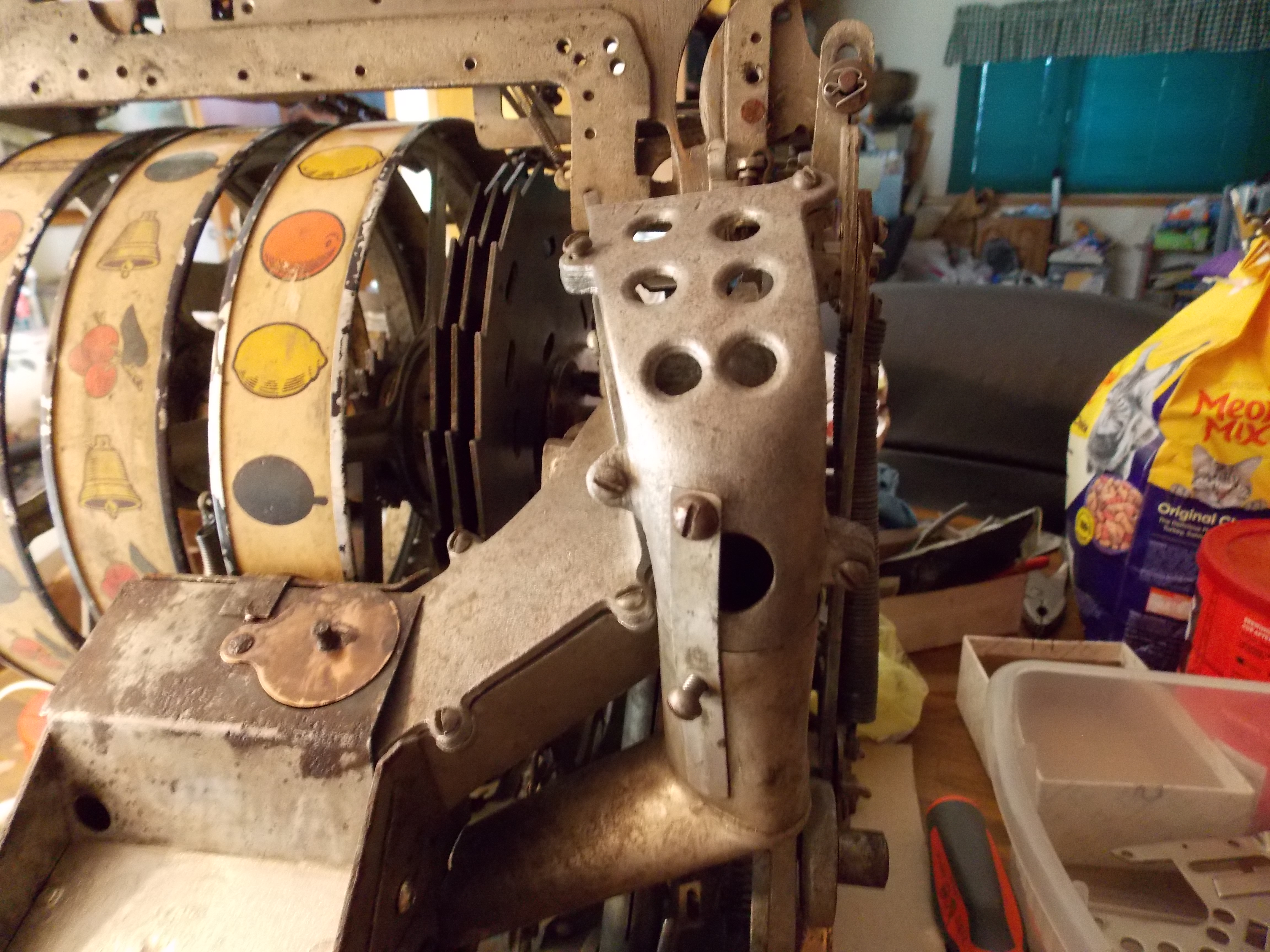

I have a prewar Jennings chief and I am pulling my hair out. I have two questions about that machine.
I first question I have is about the two coin chutes, I have a picture below... For what I can tell, I might be wrong, I am new at this forgive me...There is no way a coin can be kicked up into the top chute, from what I can tell the top chute can only be manually filled with coins that go directly to the cash box only... The second chute goes into the jackpot and "CAN" be filled when the coin tube is full automatically ... Am I wrong..
The second question I have is about the coin separator system. Mechanic found me that part, I was looking for it for a while now.
A hard part to find... What is the purpose of that part? I know it goes to the escalator but how? Does anyone have a photo how it pugs into the escalator. I have been pulling my hair out on those two questions for some time now... Thank you...

Thank you for answering my questions... I have not yet installed the coin separator yet, I will soon... I am happy I found it, that's a tough part to find... I was hoping someone out there had a photo that I could use. True that book does have a photo of the parts and talks about it, however I was unable to find a photo anywhere where it plugs into the escalator... Maybe I don't know for sure, kicks the coin into the chute... I don't know at this point, someone out there knows for sure... I was told years ago it was common to remove the coin separator from these machines for some reason... Must have trouble with it I guess...
