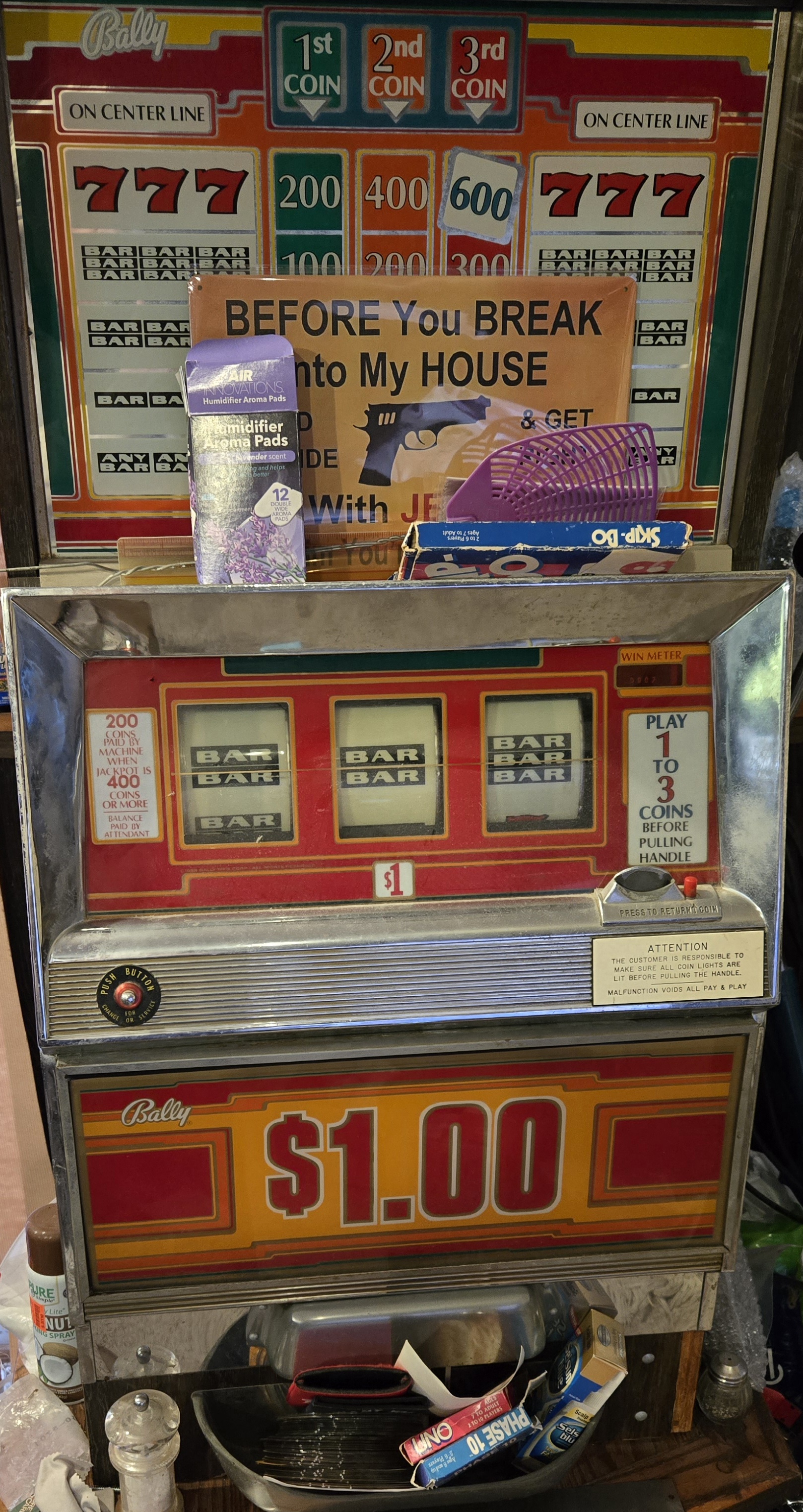

I have an older Bally's $1. slot machine that I haven't used in 20+ years, and my grandson wanted to try it out only to find a few coins jammed in the machine and apparently corroded. We got the coins out but then after closing the machine the lights did not go on, and the machine did not work. I'm thinking maybe a fuse or something similar.

The fuses should be in the main cabinet behind the payout hopper after you pull the hopper out.

If that is a E series slot machine it has a electronic board that will need repair.
