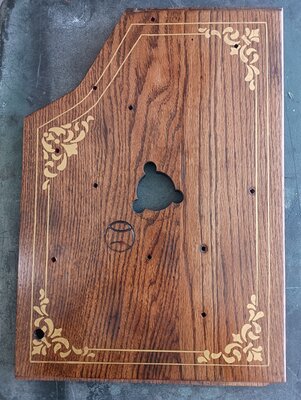

Anybody still make the cabinet pinstripe decals typically used on Pointsettia cabinets? I have a decent Pointsettia with a nice original finish but some ignoramus got lots of paint specks on it way back when. I am not having any luck getting the spots of paint off the wood cabinet without removing the old stain/finish as well. Tried acetone, Goof Off, alcohol, etc. Any ideas?

That is not a decal its a stencil, I have made my own in the past dont know if eny one is makingnthem now days, Tom Krahl use to have them back in the day.

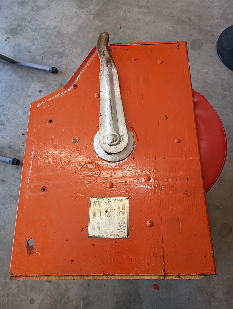

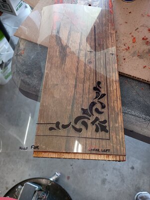

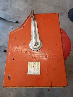

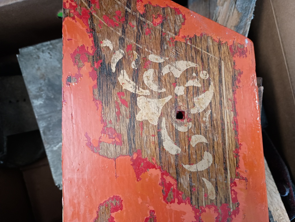

altort is correct about the stencil. The last ones I saw for sale were about 5 years ago. I just recently went through the same type of issue as you with a mills FOK. Mine however, seemed to be painted by a three year old. I had to gently remove the mopped-on paint to expose the original stenciling. After that was exposed, I was able to trace the artwork to create a new stencil. It was very tedious, but I was able to do it, and I was happy with the results.
At least you seem to have a clear view of your stenciling. So, it should be easier for you to duplicate.
Also, if I remember correctly. There were three (3) different stencils. One (1) for the gooseneck/operator bell, one (1) for the silent bell and one (1) for the FOK machines.
