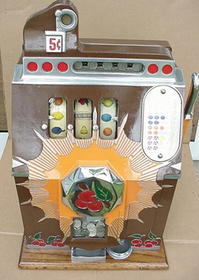

Looking at a 5 cent bursting Cherry for sale online. Seller asking $1000. Based on pictures (not the best quality) would be interested in anyone’s thoughts on its value. Advertised as “works great”.
Thanks
Shane

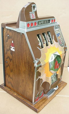

I have bought them for 850.00 and restored them to sell for 1800.00 here is a restored one.

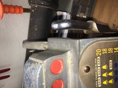

Do you power polish with a compound? This is all new to me - I see several different types/colors of compound. Which do you recommend? Here is a pic of the current state of the castings.
Thanks,
Shane
