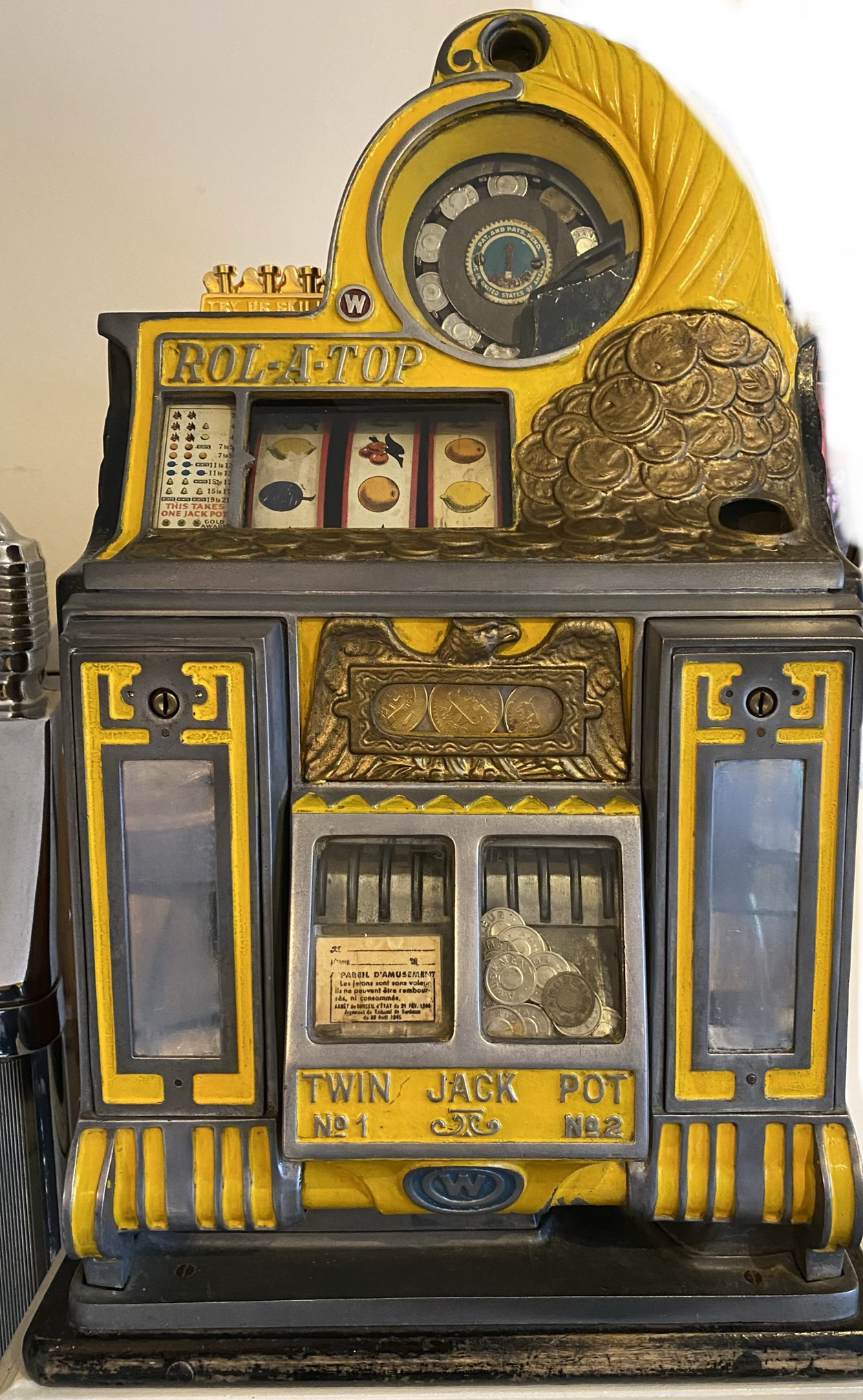

I’m looking to clean up and possibly restore the paint on our watling rol-a-top. I’m pretty sure it has been repainted at some point but the paint is scratched or peeling off in places. I’m unsure whether it currently has its original colours on it or not? Does anyone know where to find this information out? I’m also looking for advice on how to safely remove the old paint and what type of paint I should use. I haven’t done this before so any guidance would be appreciated! I’ve attached a photo of my machine as it currently stands.
Many thanks in advance.

Thank you for the response ‘yourbestbet’ - I agree I would rather not touch it if it is original. I’m just not sure if it is or not. I would like to source some of the same yellow paint as some areas, particularly on edges of the inset parts has almost completely peeled off, so even if I were to just touch up tiny areas. Also some of the yellow paint at the top is turning slightly green... do you think this would be off putting to collectors? (Not that I’m planning to sell for the foreseeable future!) The machine is looking a lot better since i very carefully gave the outside a good clean. Came up nicely!

From your photo it looks to be original and with the extra perks, Skill Stops, Vendors and Special Award so I would leave it just like it is just make sure it is playing and paying correctly!
In my opinion being Completely Original and showing patina adds to the value so I would say,
DON'T TOUCH IT!
But possibly you could check with Larry DeBaugh or Watling Boy on this further because they are the GO TO guys on anything Watling!
Heck, it even has the original Watling Tokens, you scored My Friend!
Bona Fortuna!

The yellow and gold on this machine have been redone. If you blow up the photo, you can see the coins have gold paint instead of the original gold lacquer. Also the Horn of Plenty was always painted with gold lacquer and never yellow.
George

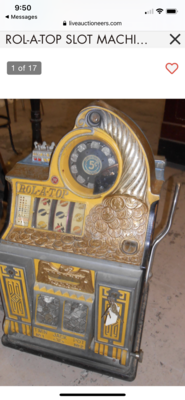

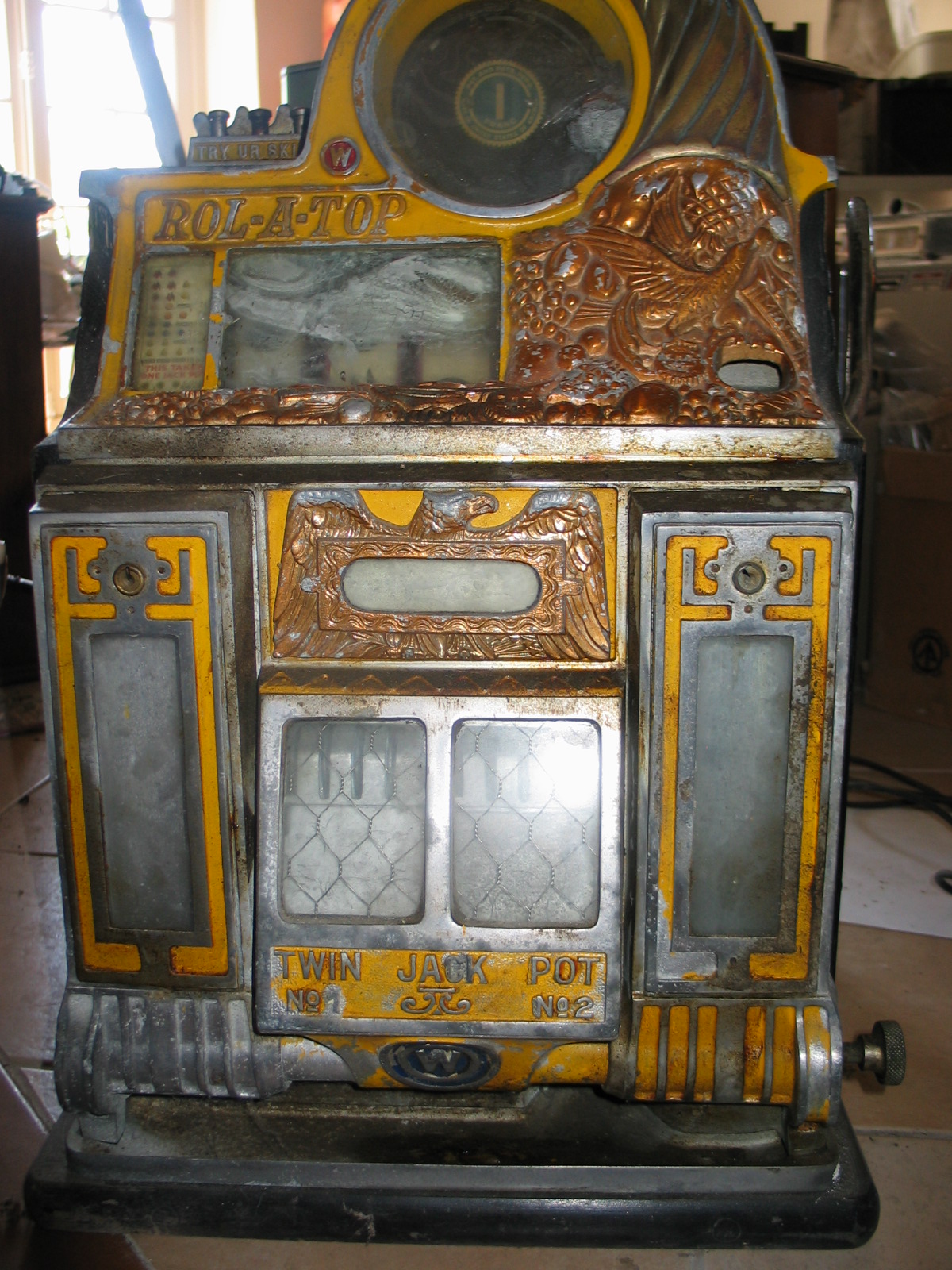

Yellow with a gold clear coat on the horn like this model.
And for the lower casting ; (for me) two solutions:
Original French Bird
or this :

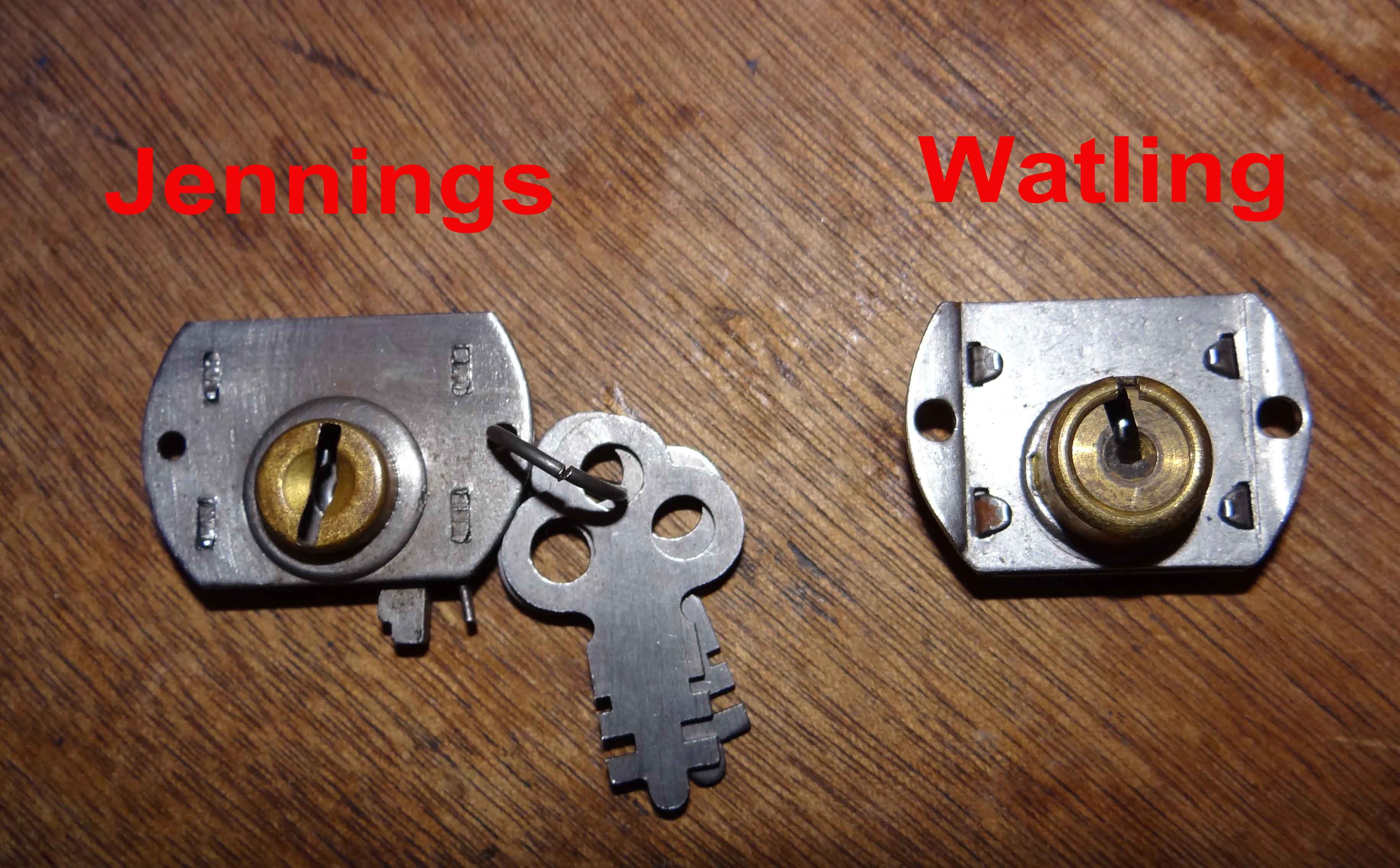

The locks on the two front doors are not original.

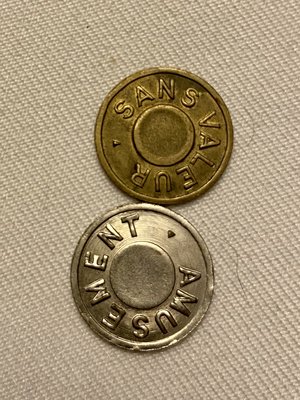

The coins we currently have which came with the machine are actually tokens (like you said it has been in the French market, we got it from Belgium). I’ve attached a photo, we have been looking for some more that will work as we’ve tried a few very similar coins/tokens with no luck. I will try the Francs that you mentioned if you think these will work as we definitely could do with more of them to fully fill the machine.
