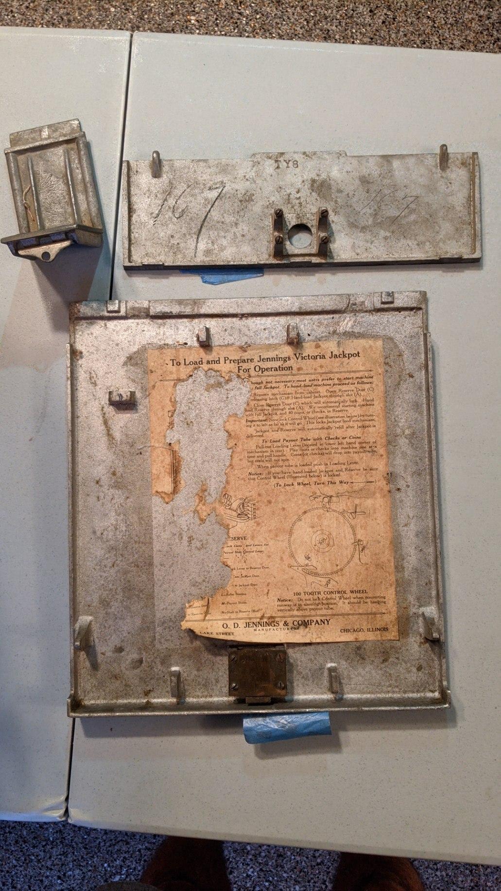

What the heck is this??? I am looking to purchase a Jennings Victoria front vendor and there is an operator sheet on the back door that mentioned a 100 tooth control wheel. May have something to do with payout but not certain. Haven't found anything via google or Geddes and Mead book. The gear i question is to the right of the reel bundle but I dont have many pics of it.
Check the pics out attached.
Thanks for any info!!
Overview of the mech including the 100 tooth wheel
Close up of the 100 tooth wheel
Pic of operator instructions

It regulates the number of coins going into the jackpot

Yes; it was an idea that never really caught on, but I liked it when I had one . You can see the ratchet wheel with 100 teeth on left side of mechanism.
It controls the filling/working of the Jack Pot, the Reserve JP. The operator can adjust the wheel to control the amount of coins in the JP up to 100 maximum.
Once the JP is won, the Reserve JP dumps on next play and the wheel keeps track of coins going to JP during subsequent play and stops feeding them once the amount set by the operator is reached.
Once you tinker with it and figure it out, it's really a neat and ingenious system and works well.

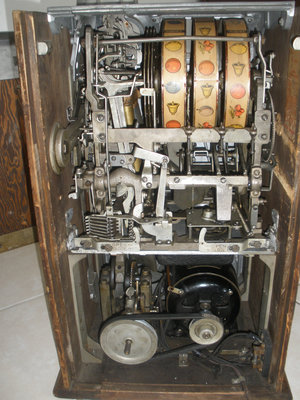

So I guess you can ignore my email about getting more photos of the slot machine here in question and in my opinion if you can pick it up at a reasonable price and even in its condition if it is all there it may be a Great Find!
Route operators probably did not like them so they didn't sell well!
Similar to the Jennings Electro-Jacks that was also pictured that one of my customers had and I worked on!
Another very unusual slot machine with an electronic motor and linkage that actually operated the mechanism!

I love the Electrojax. It s an Uggly machine but one of my best in my collection.So happy to have found it some years ago.
