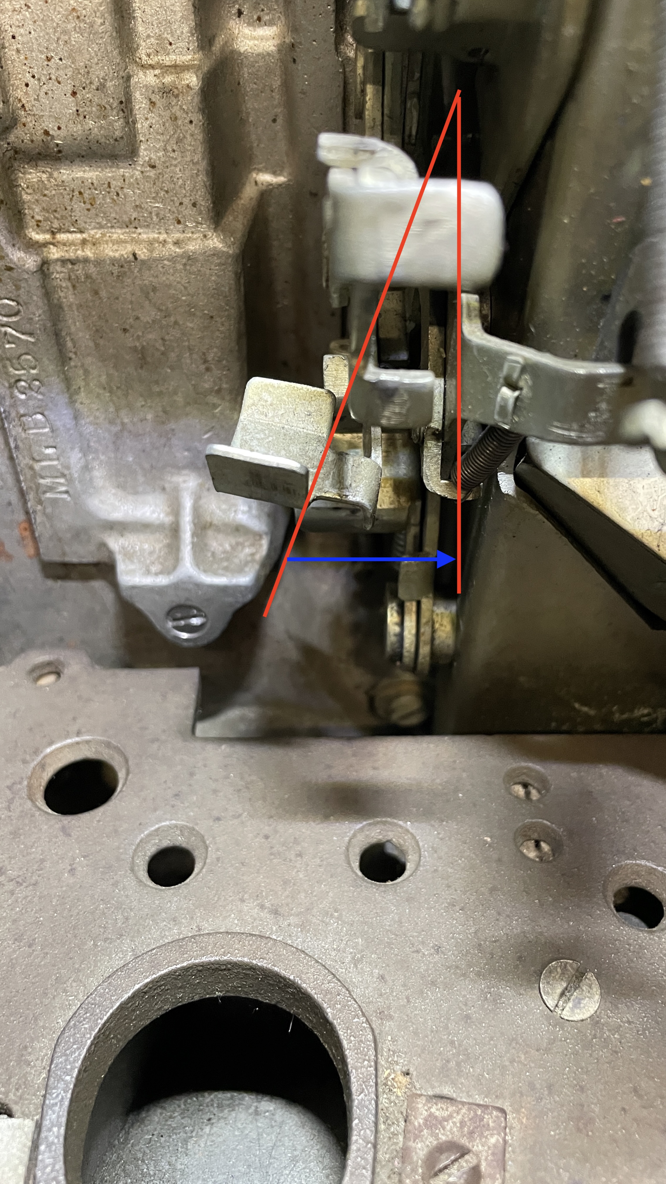

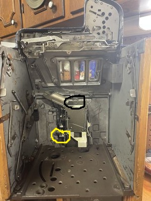

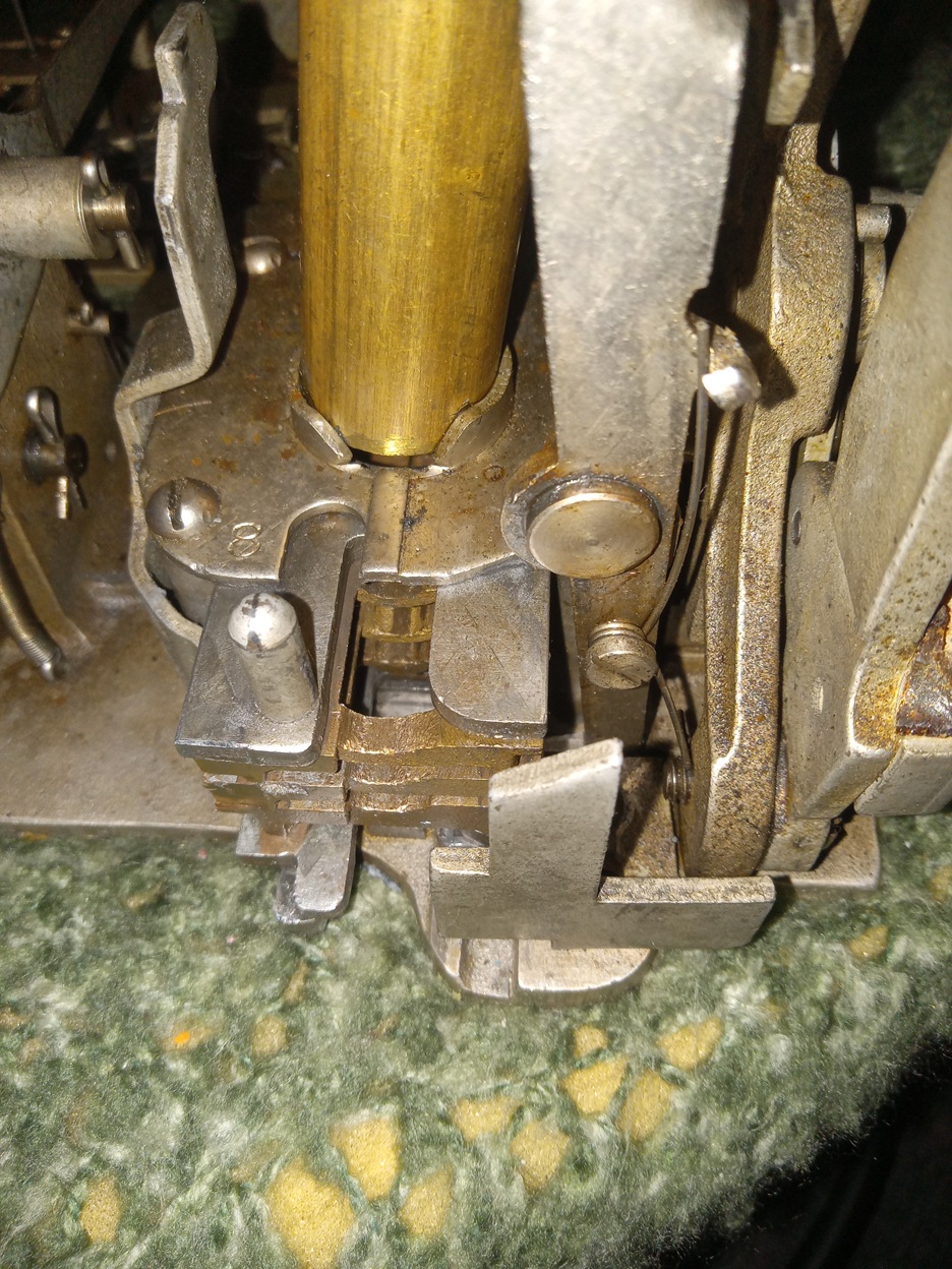

Hi, Glad you got that issue sorted out- great progress!! mazzeosa17 is spot on with the extra part and the hand loading of dimes into the jackpot assembly. I do see some issues with the payout components and payout jackpot slide-please refer to my pictures below as a helpful guide. Please straight out the bracket circled in Yellow and push the bar forward before reloading the mechanism back into the cabinet so the jackpot can refill as you play.

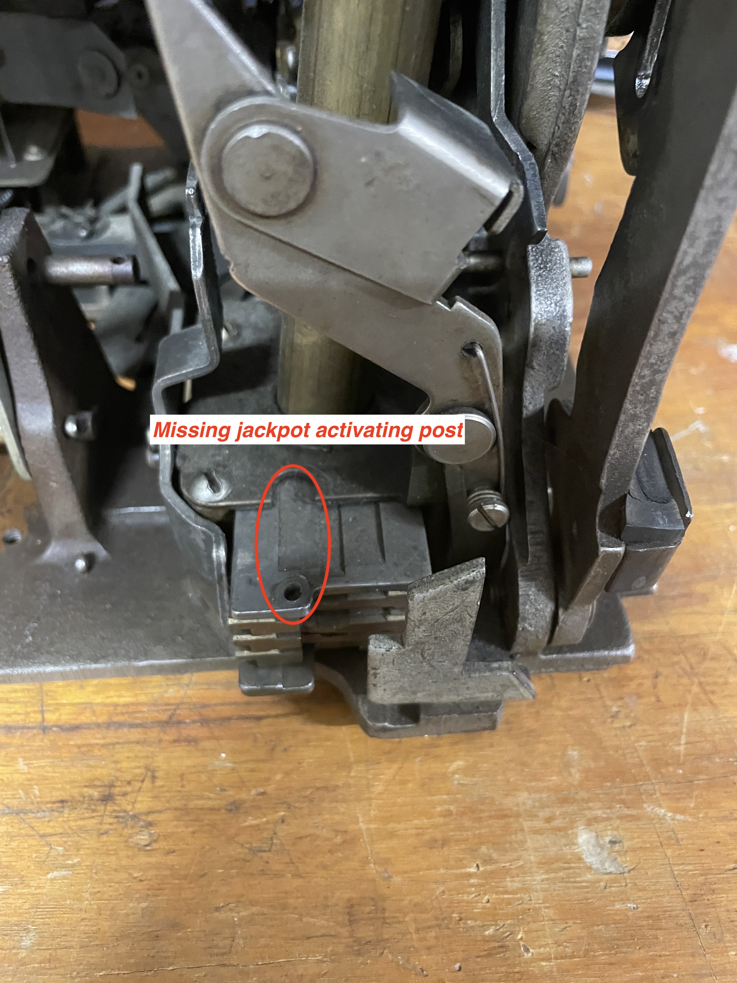

Issue 1 -jackpot post pin is missing! #2 screw (circled in yellow) that holds the jackpot assembly to the face plate is misaligned/missing.
Based on the payout card (1 cherry payout) and the reel color tapes this machine OR the mechanism might be a reproduction. ****need to see serial numbers inside (paper tag) or stamped numbers next to flat spot on the handle side to confirm***

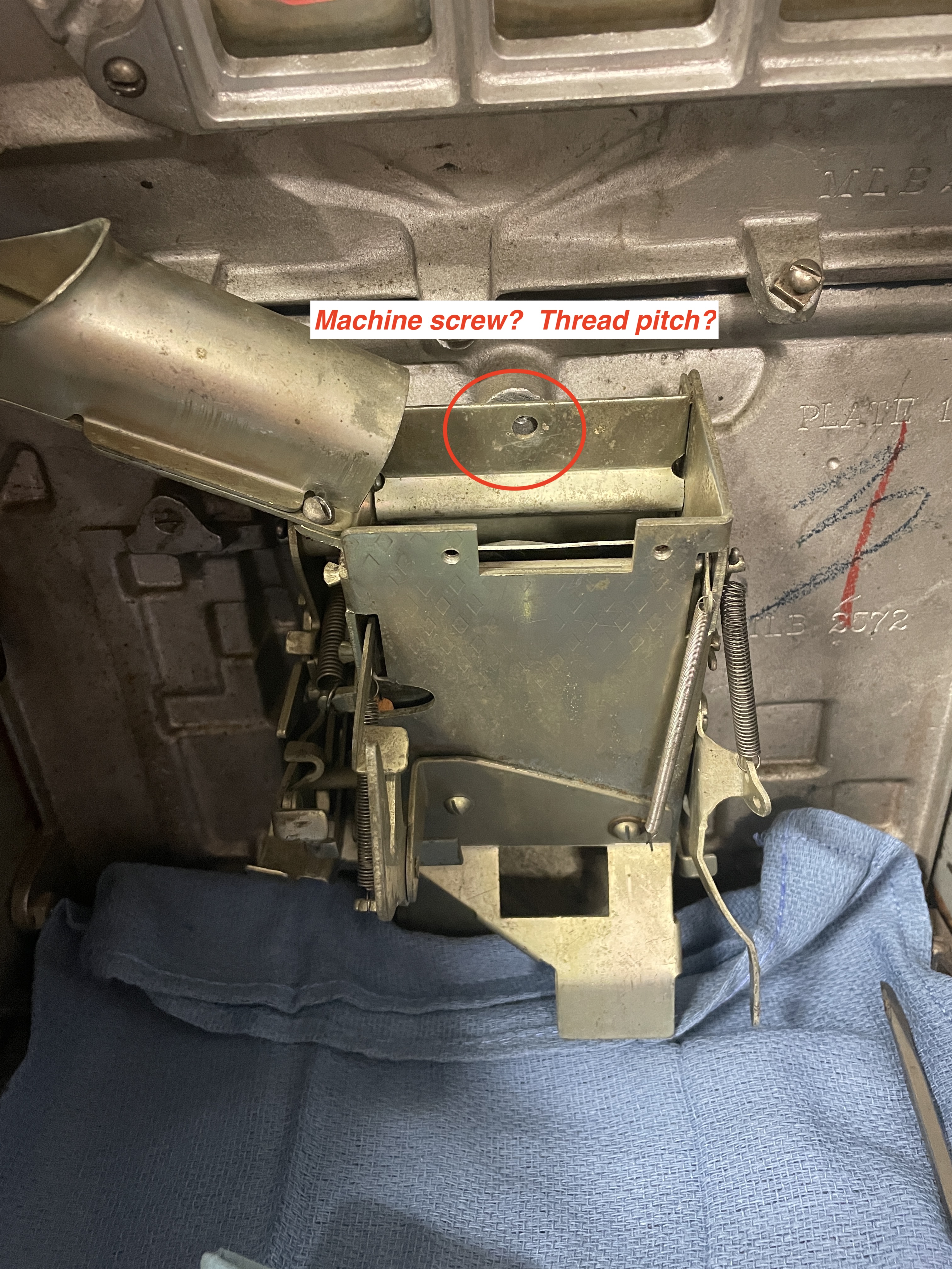

Second question: Yes I had seen that the screw is missing that holds the jackpot assembly to the front of the machine. Do you have any idea what the specs for that screw are? Is it a machine screw? I have tried an assortment of screws from my collection but haven't found one yet that fits, and I'm reluctant to force something and mess up the threads if it's a machine screw.
Last question, thank you for pointing out the missing 'jackpot activating post'. I never would've seen that since I don't have a manual. Will the machine operate without that part? In the meantime, I'll see if I can find that missing part on this forum somewhere or on eBay. By the way, I did send an email to Liberty Belle Books and got this response: "Your message couldn't be delivered to mfey@libertybellebooks.com. Their inbox is full, or it's getting too much mail right now." Maybe I can find one of this forum.

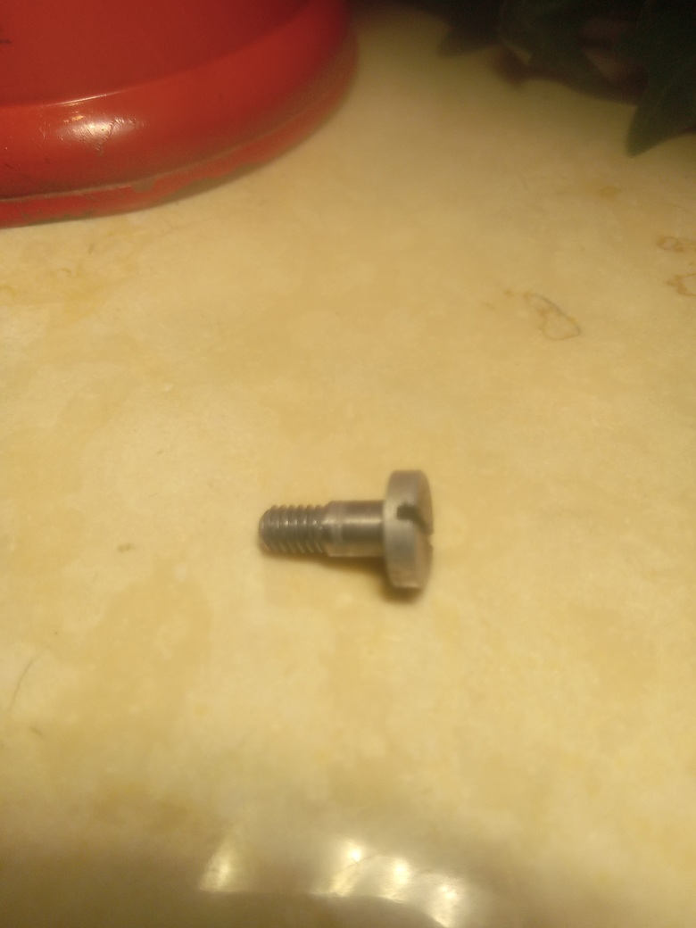

Hi Chuck Typo and corrected, here is some pictures of the bolt and correct jackpot arm, you will need a spacer in between the mounting post on faceplate to push the assembly back towards the mechanism, drill an 8/32 hole in a chair foot felt floor protector works or a metal washer (3/16 to 1/4 thick) FYI you don't need a screw/bolt with shoulder when your using the spacer but that's the mills setup. The slot will payout on all the combinations but not the Bar/Jackpot. If you can't find the top slide you can try to press fit or JB weld a pin in place to make it work until you do find one.
Steel bolt/screw with shoulder = 8/32
Overall ID Length=.450 long
Shoulder- OD .185 x height=.215 ---This is the gap in between the faceplate and jackpot assembly
Screw threads =32

Slide and pin dimensions pictures
Pin Diameter =1/4
Pin Dimensions =Top of pin to top of slide=.620
Top of pin to bottom of slide=total .790

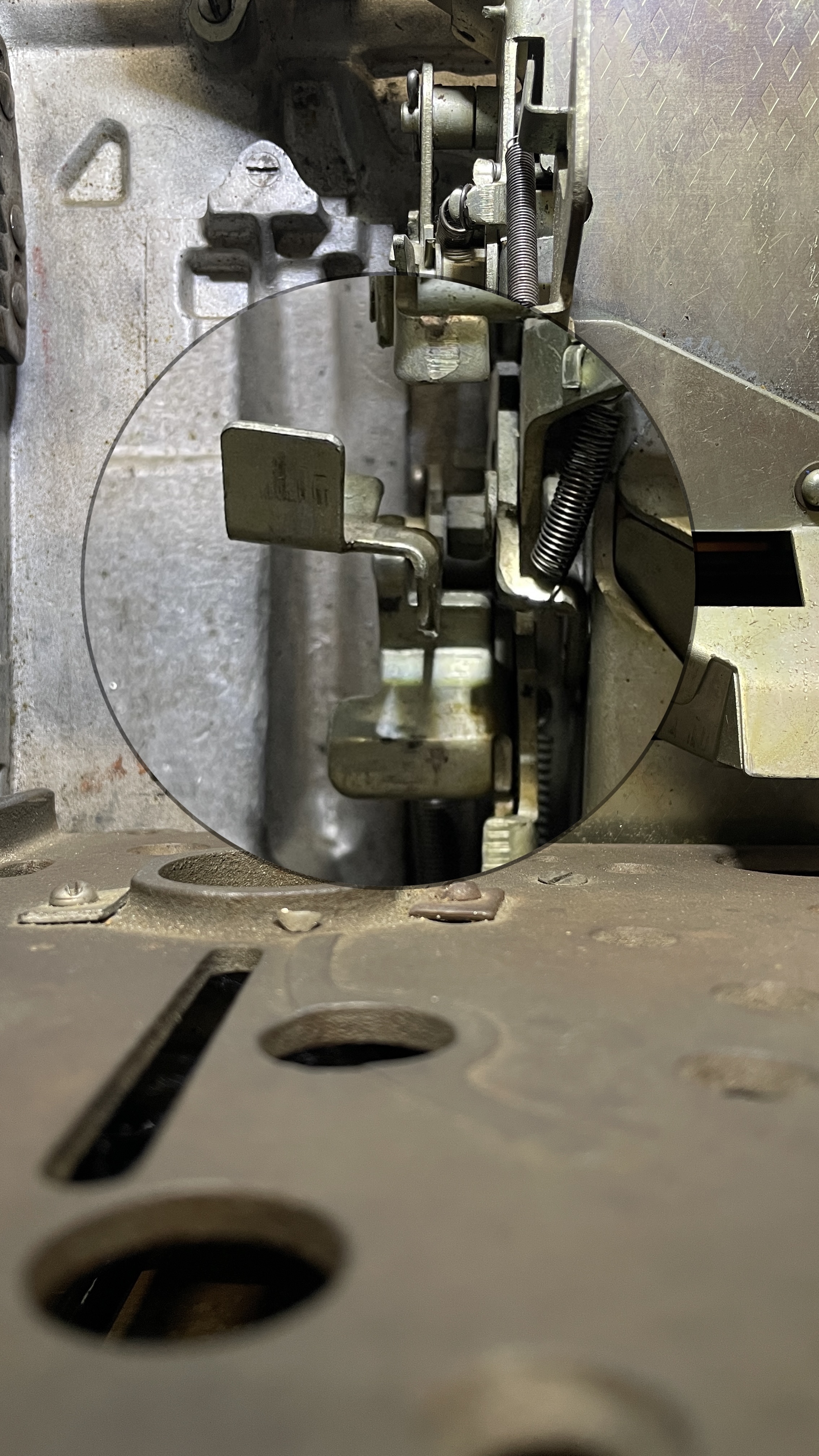

Bally Bill, thanks for clarifying the bracket that needs to be straightened. Good eye. See the attached 2 pix. I think you're saying get rid of that angle between the red lines.

Postby Bally Bill » Fri Jul 04, 2025 12:31 pm
Hi, yes that bracket is bent outward too much and should be perpendicular to the jackpot assembly (example is 2nd post 4th picture from top)

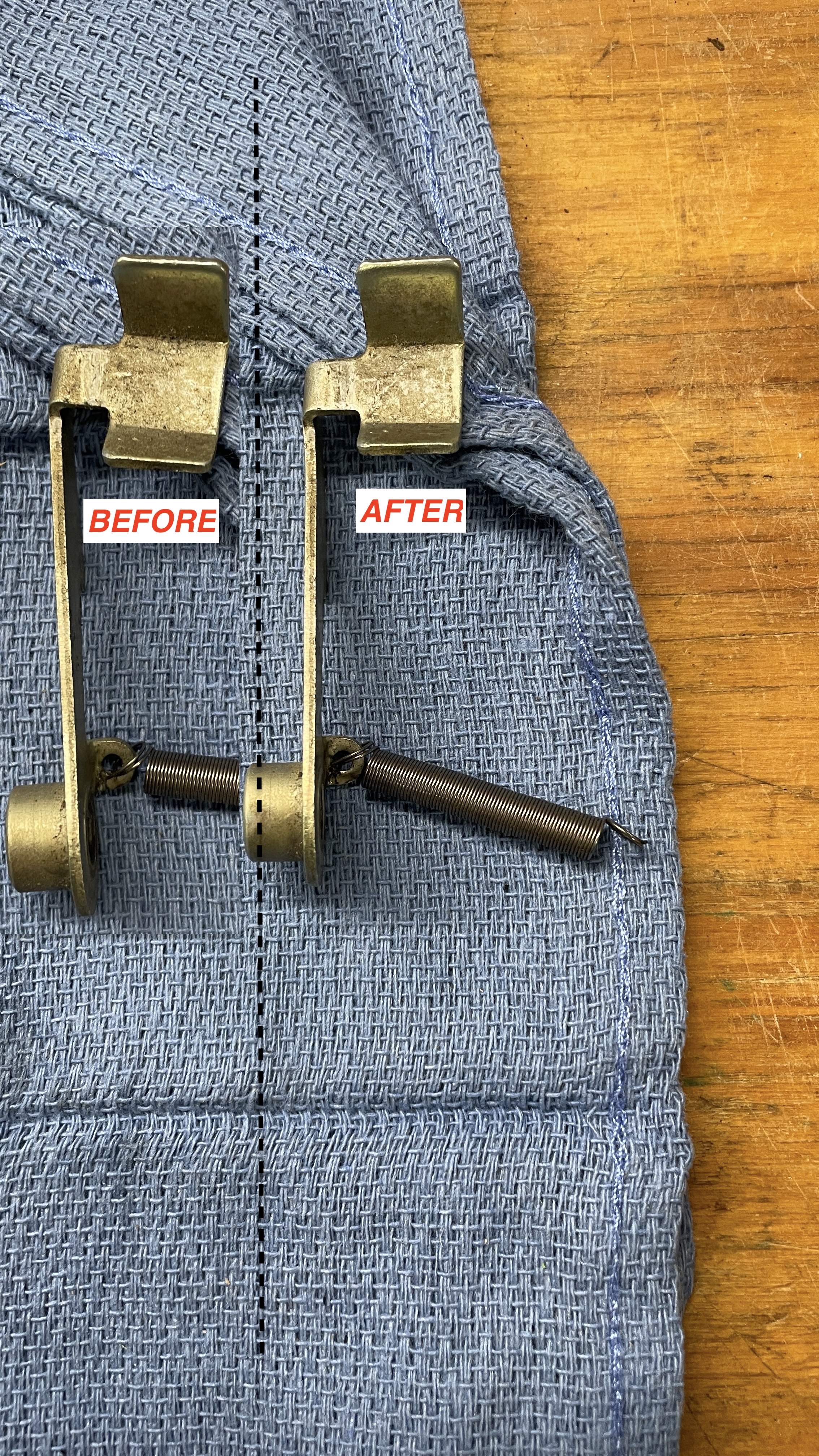

Thanks Bally Bill - here's a before & and after of the bent lever. Thanks to the access panel, from the front of the machine I was able to easily remove it and use my bench vice to straighten it up.
So, if I understand correctly, I should be able to cycle the machine and get payouts on anything except the full jackpot? I'll continue my hunt for the jackpot activating pin, or (temporarily?) JB Weld something as you suggested.

Postby Bally Bill » Sat Jul 05, 2025 10:20 am
Hi Chuck ,Your welcome and your fix looks great! You have to check but I think the Bell/Bar, Lime and Orange/bar may not payout, but the rest should work fine. Leave the backdoor off and cycle dimes and hold the timer fan from spinning (long screwdriver) and line up the Bell/lime/orange bar combos then release fan to see if the machine pays out correctly. Glad you got the book, and you will soon realize how fun and interesting this hobby can be and understand that these old mechanicals slots are built like tanks.
