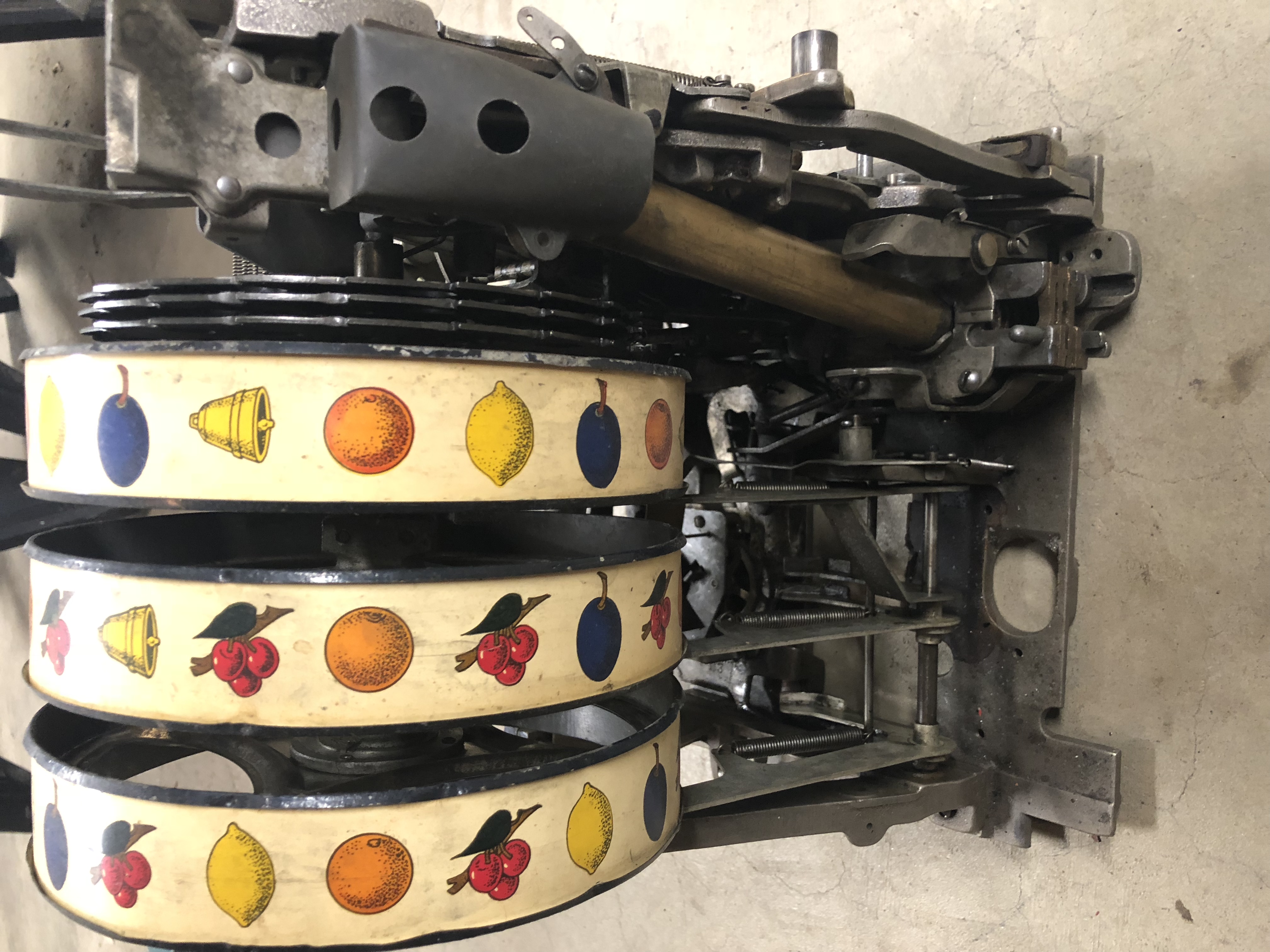

I’m was interested in seeing the mechanics of the insides. The look like photo below.

Wow missed the attachment folder, thanks! Here are some pictures!

Postby Imyourcaptain » Mon Mar 26, 2018 5:52 pm
Looks good, complete and original. What are your questions? Is it working for you?

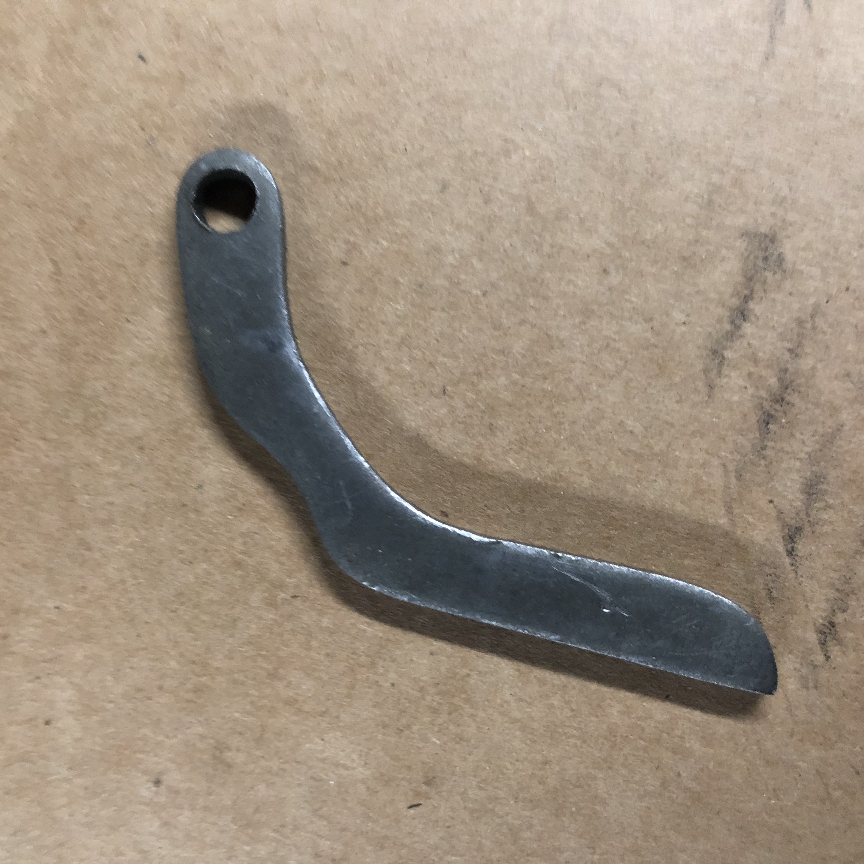

Also, found this part .... looks like a armature????
Armature?

Re: 1910 Mills Bell, Fruit Gum Lock
Postby Imyourcaptain » Tue Mar 27, 2018 5:47 am
So much for giving the men off for Xmas vacation!
That piece you have there is the overflow push off bar. It goes towards the top of the coin tube. When the coin tube is full it pushes the extra coins towards the jackpot or cashbox depending on what you have.
